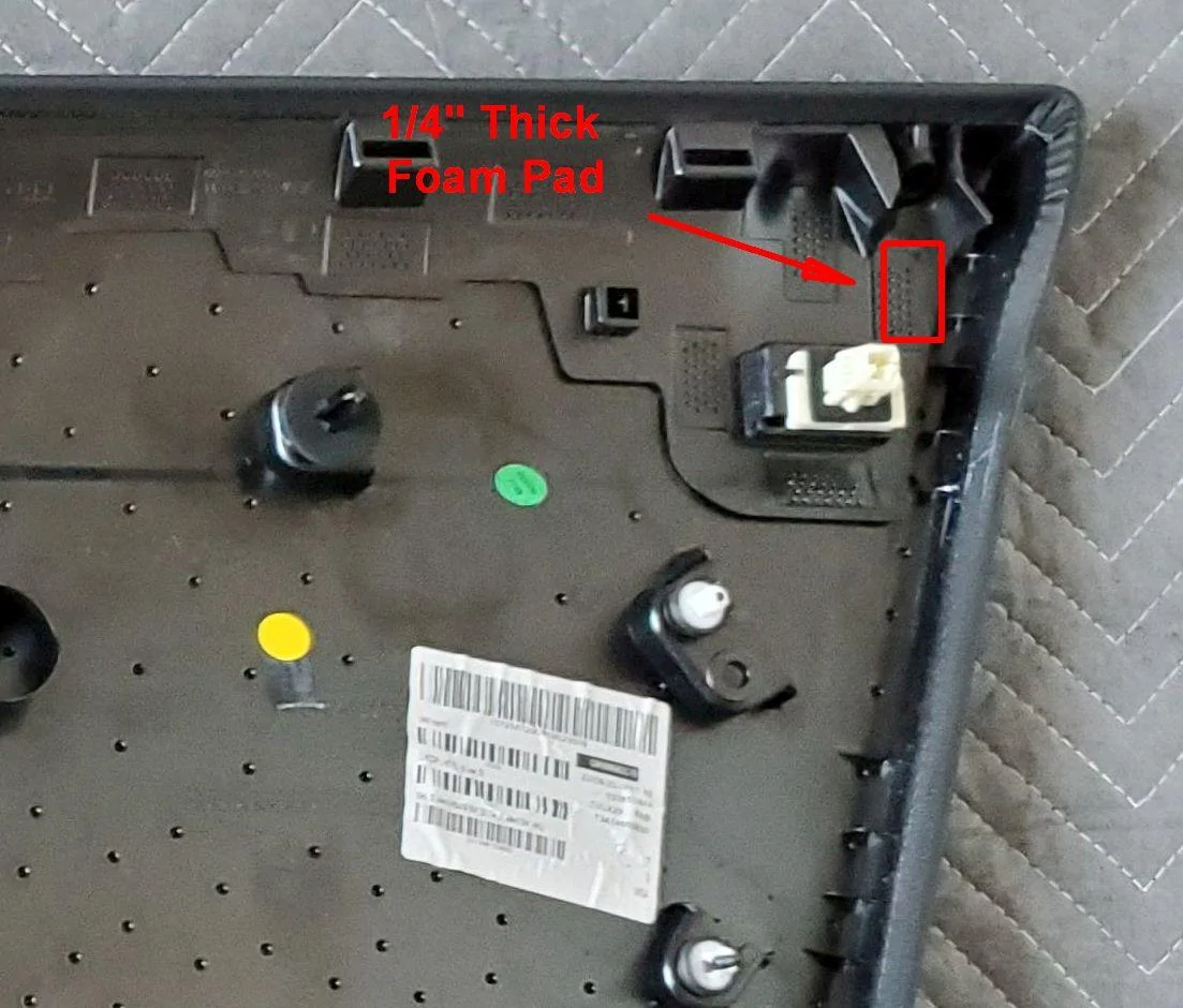

And finally I posted a pic a while back showing how to fix the door lock plunger rattle / vibration problem while you have the door panel removed...
