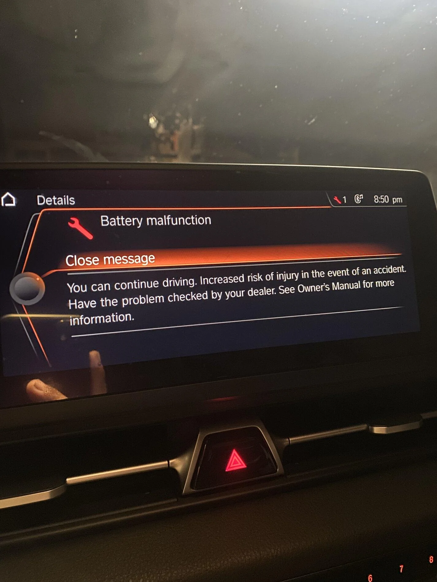

Last night this message popped up when I got home after a short drive. Called today and they informed me of the recall so I’m hoping that’s what caused this
Scheduled to take it in next week

I have this letter from Toyota. Replace battery due to software issue which would could deactive the auto Start/Stop function. Per the letter.

Make sure the service advisor knows they're replacing the battery and actually have it in stock. I've been to two separate appointments for this already and both times they forgot to order the battery. I need to find a new dealer.

This is now completed. The small battery on the passenger side of the motor is replaced and synched with the car. Its about an hour procedure in total.
