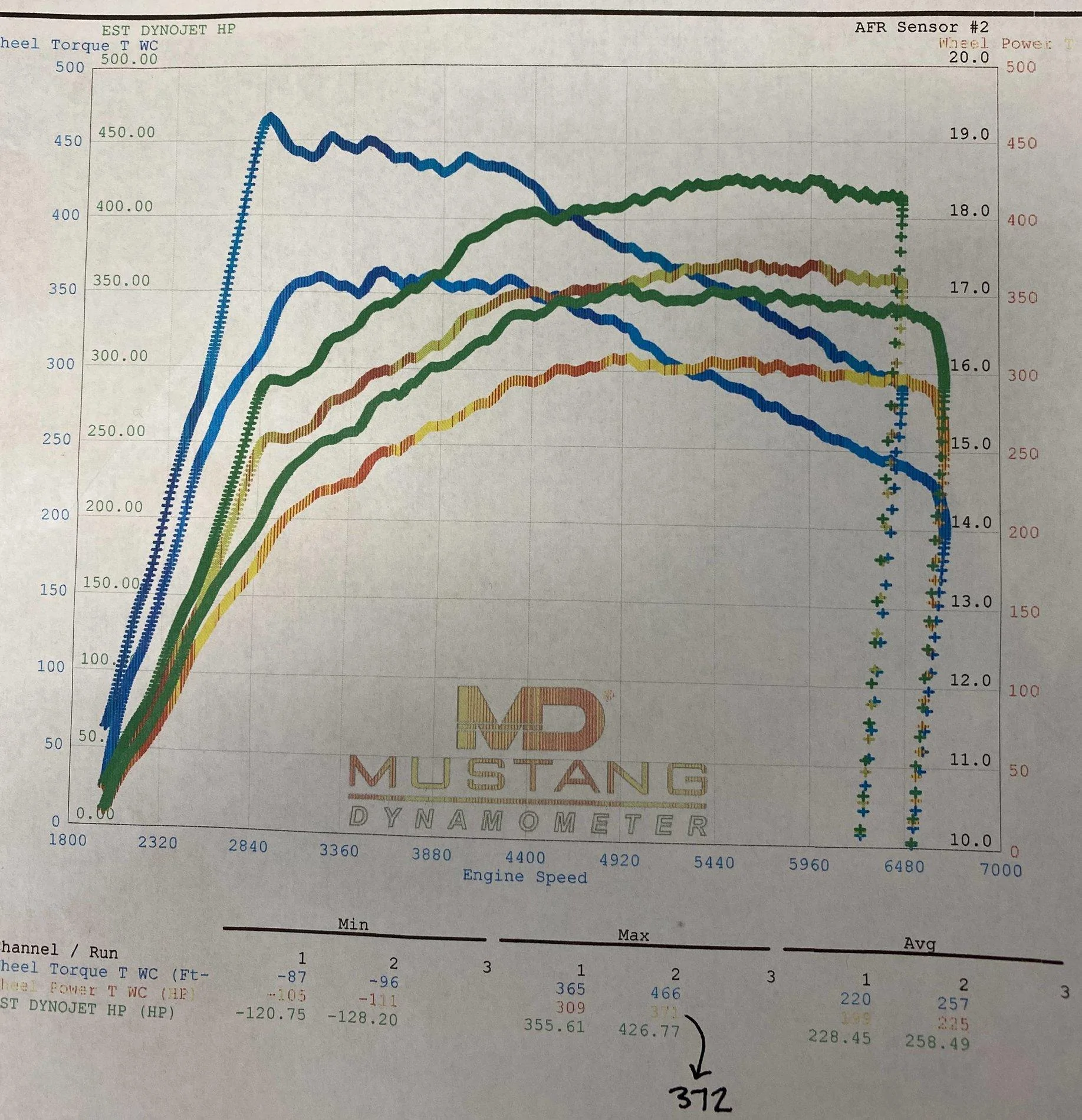

I finally got my car on the dyno today for a custom tune.
Mods are Active Autowerke catted downpipe, HKS drop in filter and stage 2 custom dyno tune.
The baseline pull showed 309whp/365wtq but that was with the AA downpipe already installed so it's not really representative of a stock car. On 93 the stage 2 tune made 372whp and 466lb ft tq on a mustang dyno. The tune alone added 63whp and 101wtq on top of the downpipe and HKS drop-in. If I use Active Autowerke's stock vs. downpipe only delta numbers, the total looks something like +81whp and +114 wtq.
I still have the JB4 so I'll probably log a pull and see if BMS can supply me with a map for when I decide to run some E30 in the car. I also have an Eventuri intake on the way so the engine will probably pick up a bit more horsepower and torque from that.

I want to say I saw ~20HP gain from a downpipe and a factory tune. So your estimates are probably pretty close to correct. What was this tuned on?
Hi Marin,
The shop didn't disclose their tuning software. They just said that "it's our own tuning solution". The shop is Solo Motorsports in Atlanta. Would you say these numbers are inline with what you guys would expect to see for a custom tune given my mods?

I know dynos all read different, but this seems low to me....this is a dynojet too....not a heartbreaker. Im getting the same DP as you, catted, Im dynoing this weekend with bm3 ots 91s1, Ill post up

This tuning was done on a Mustang (aka hearbreaker) dyno. According to the shop, equivalent dynojet numbers are 427whp and 535lb ft wtq.

ahhh ok, my mistake...that actually seems inline with what I was hoping/thinking these mods would do

Regardless of dyno used, HP increased by 22% (using your approximation of 81hp gain from stock). This is the only "number" you could use for comparison from dyno to dyno and it looks to be inline with what others are getting with catted downpipes.

I would say the numbers are more on the conservative side. There should be more available but some of the limiers take quite some effort to find. I'll thoss a stock map on the next STG2 car we get on the dyno and see what we get, as its been many monthis since I have done that and I was on a friends dyno at the time so I cannot pull it up to cross reference it.. But if my memory serves correct we are actually getting a tad more % gain with 91 octane here, but we have put a lot of effort into pushing the cars this far and have done a lot of actual road testing to verify it.
