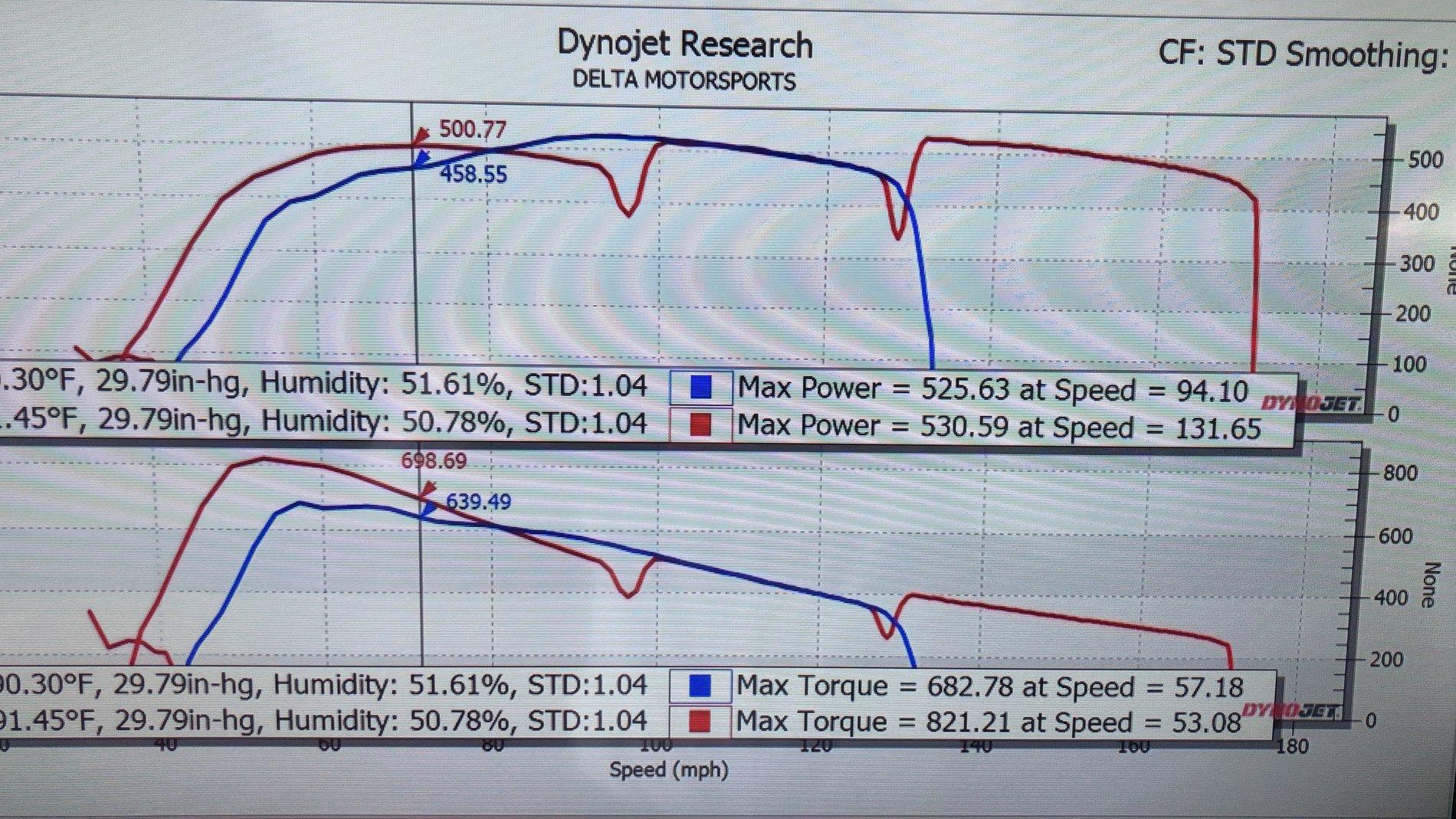

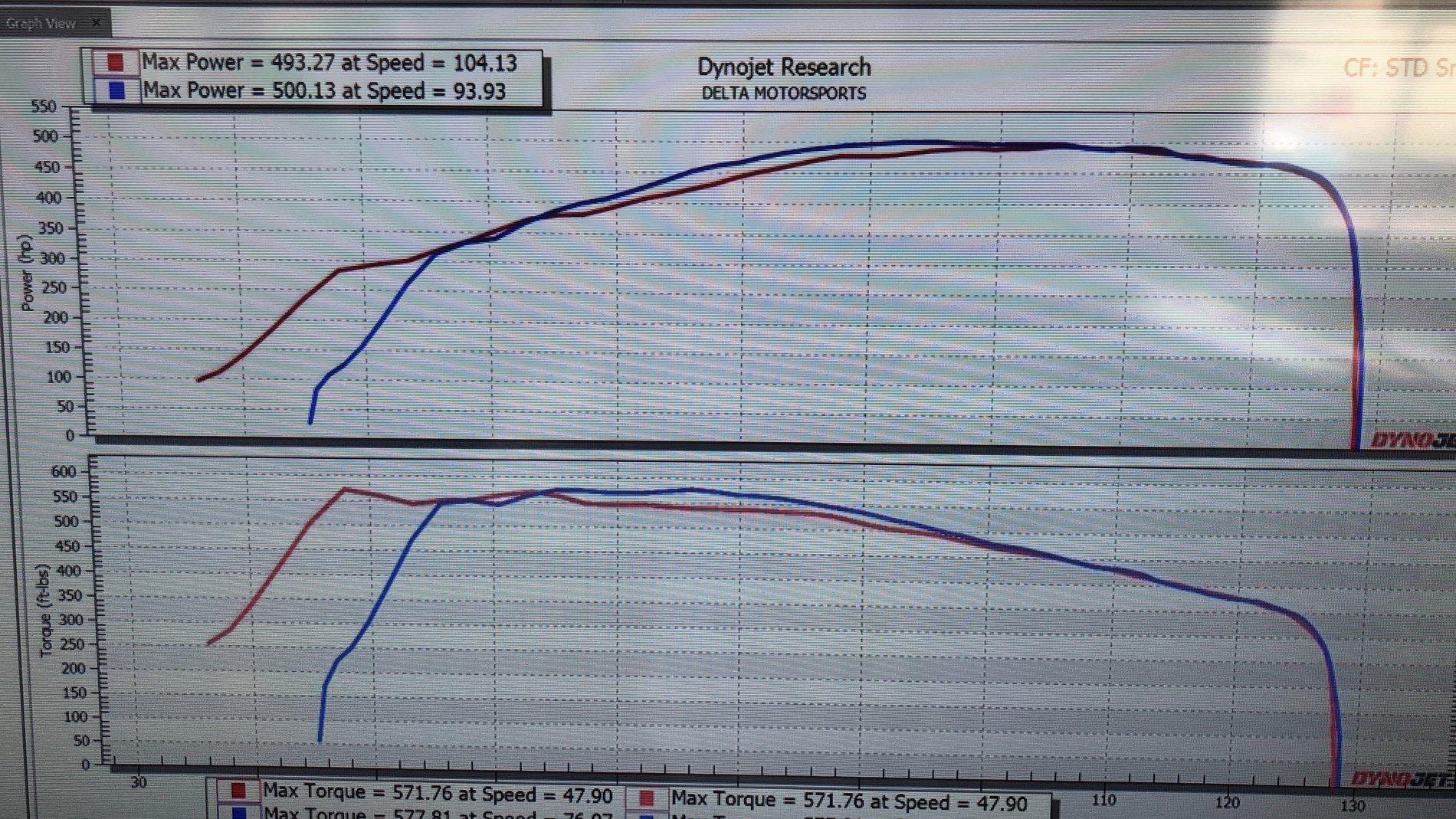

so today, I Tuned my supra LE ( dynoJet) in the Caribbean ( really hot today) @ 12 noon
please share your thoughts and dynos and get this stock turbo info going.

here are some pics...
observations:
peak boost was 20psi but falling to 18psi @ 6,000 rpm to redline. we will recheck for boost leak and re-dyno soon to see if we can maintain 21-22 psi to redlilne maybe see 10-15 more..... hopefully.
Tq is crazy and will spin the stock tires in 3rd gear.......

updates
fixed a few things added a charge pipe, which helped hold more boot to 22 lbs min
and here are the final numbers
525whp qith 680tq
tq ended up being too much so ended up wtih about 595 tq
red graf was 4th -5th-6th gear pulls to see how the tq limiters would reacts..

record is something like 510whp on stock turbo. i made 507whp (had a bit left). before i tossed in the Pure turbo.

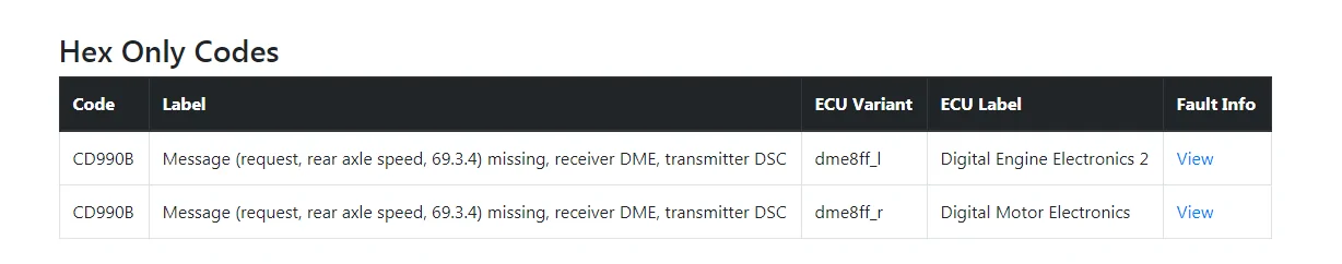

CD990B
CD990E
21B056
21B055
11A605
know what they are.... my teckstream have not arrived so can not tell yet what they are

on th dyno we had no issues with the pump got other codes though
CD990B
CD990E
21B056
21B055
11A605
This might help in the interim: http://bmwfault.codes/ i.e., for CD990B
CD990B
CD990E
21B056
21B055
11A605
CD990B - front axle request missing (dsc)
CD990E - rear axle request missing (dsc)
21B056 - radiator lower valve coms fault
21B055 - radiator upper valve coms fault
11A605 - fuel delivery too low
