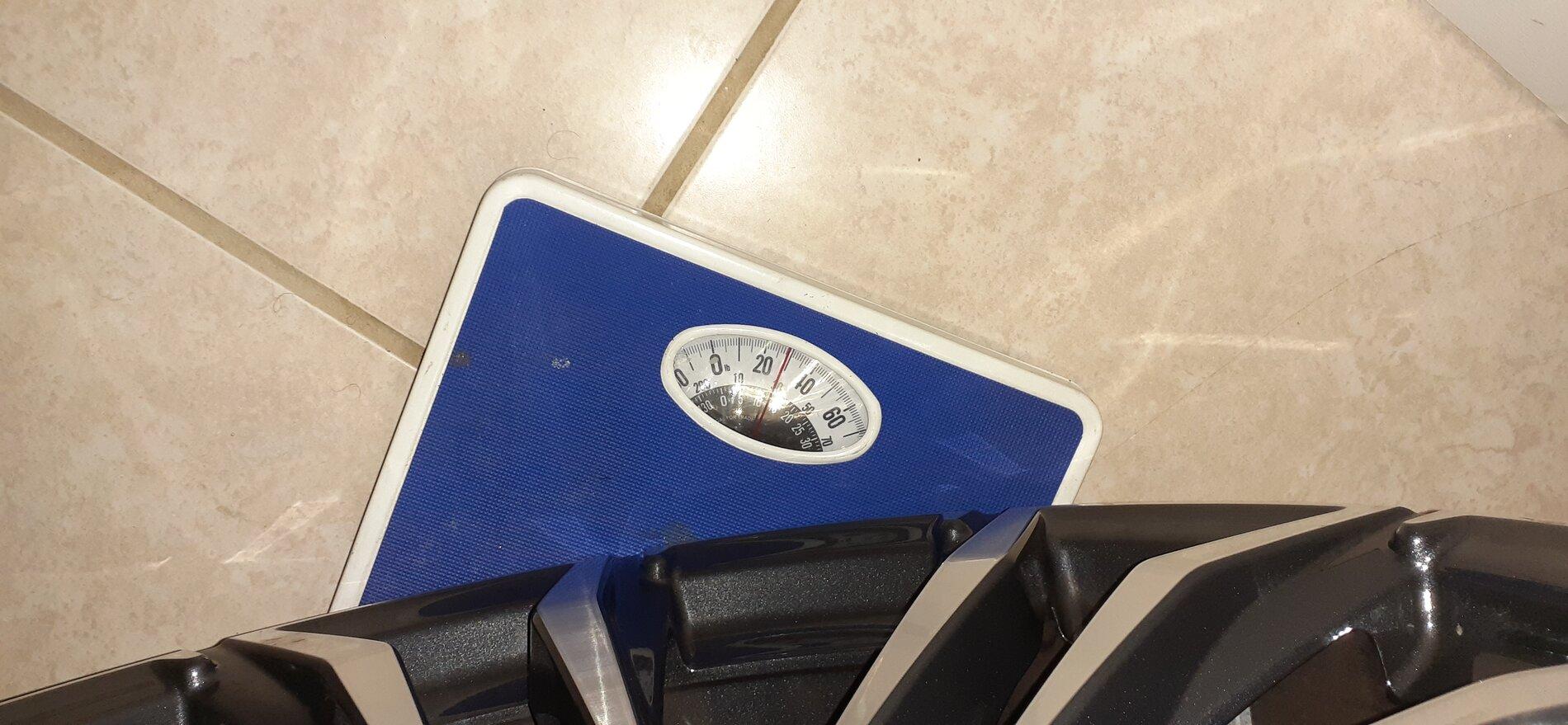

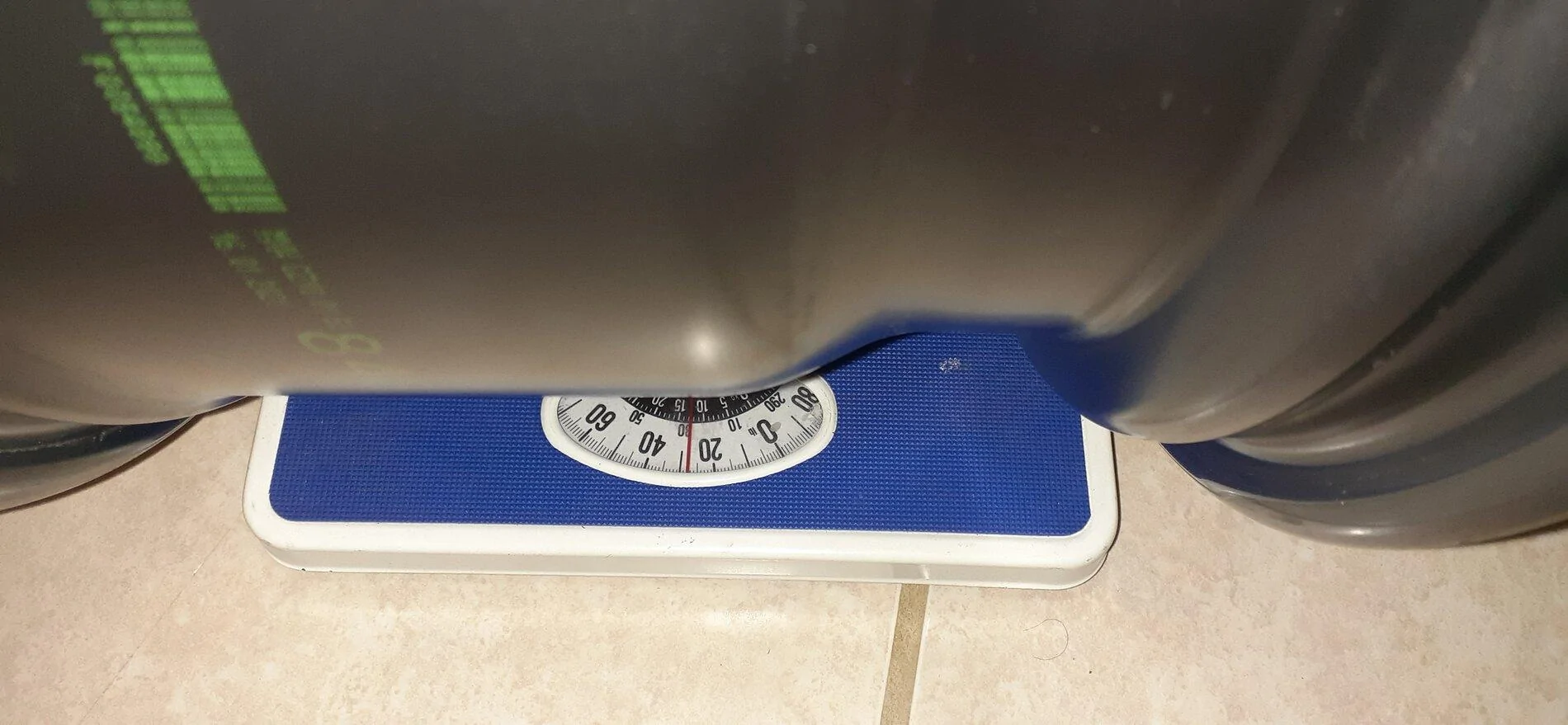

So I installed some lowering springs today at a shop and I ended up weighing my stock wheels/tires.
Front was 49lbs
Rear was 52 lbs
Now the tires weigh 24lbs Front and 27 lbs Rear per Tire Rack so that means the cast 18x9/10 wheels are around 25lbs front and rear using basic math. I'll also be measuring them Monday with no tires to clarify.

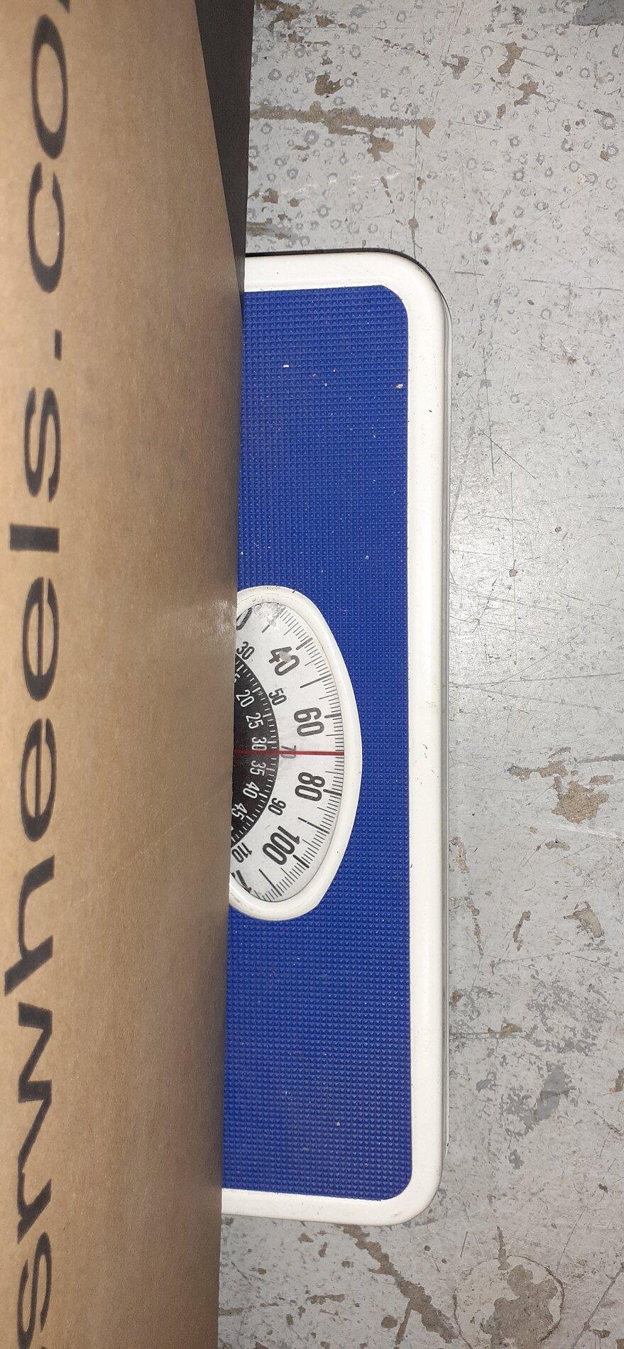

So I realized that the wheels are much heavier than I measured with the tires. I recently bought some 22lb wheels that came in box of 2 where FedEx measured the weight as 55lbs a box(110lbs for 4 wheels(88) and heavy boxes(22)). I decided to hold on to all of these heavy boxes and put my stock 18" in them since it's hard to measure the weight of the wheels with my scale. I was surprised to see the scale jump from 55lbs a box with my new wheels to 67lbs in the same box taped up. That's 12 lbs heavier per box which adds up to 24 lbs more (134lbs). This would mean the stocks weigh 28lbs for all 4 with 22 lbs of measured weight boxes I put them in.
Any weight difference between fronts vs rears since they are different width (18x9 vs 18x10)? :)
So 28lbs are fronts or rears?
Very appreciate the info!
