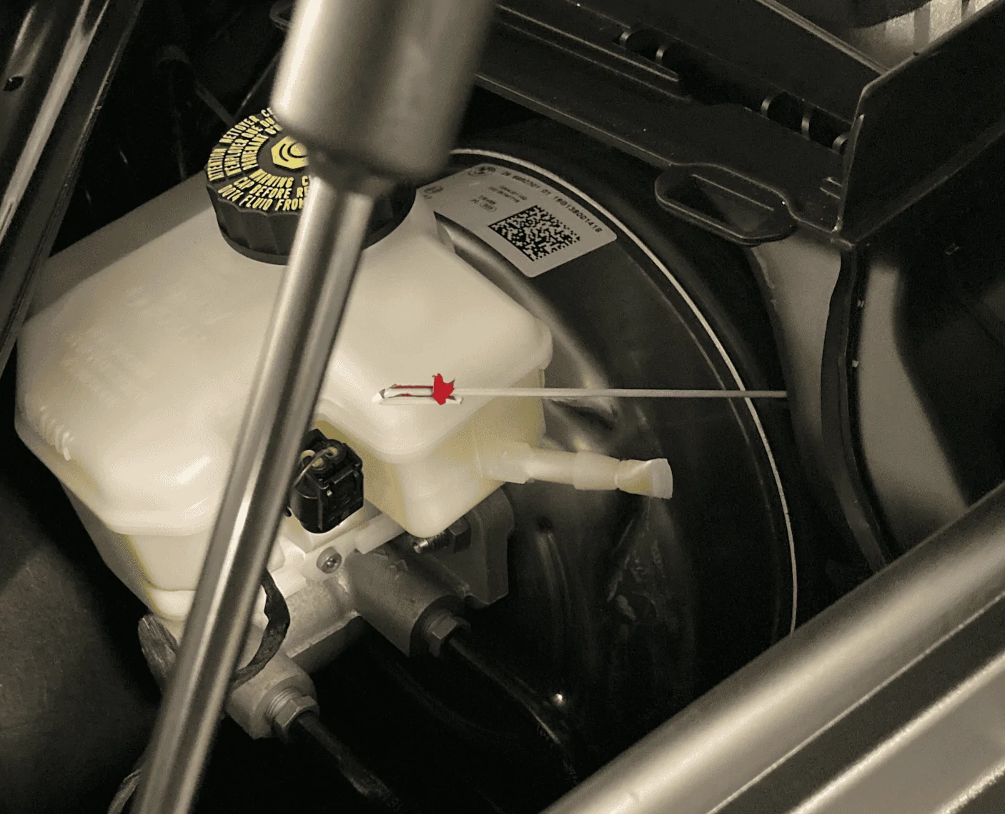

Driver side behind and under the brake booster. Look up the video for the titan meth kit install and it'll show you where on the passenger side to pass thru. Drivers side is pretty much identical

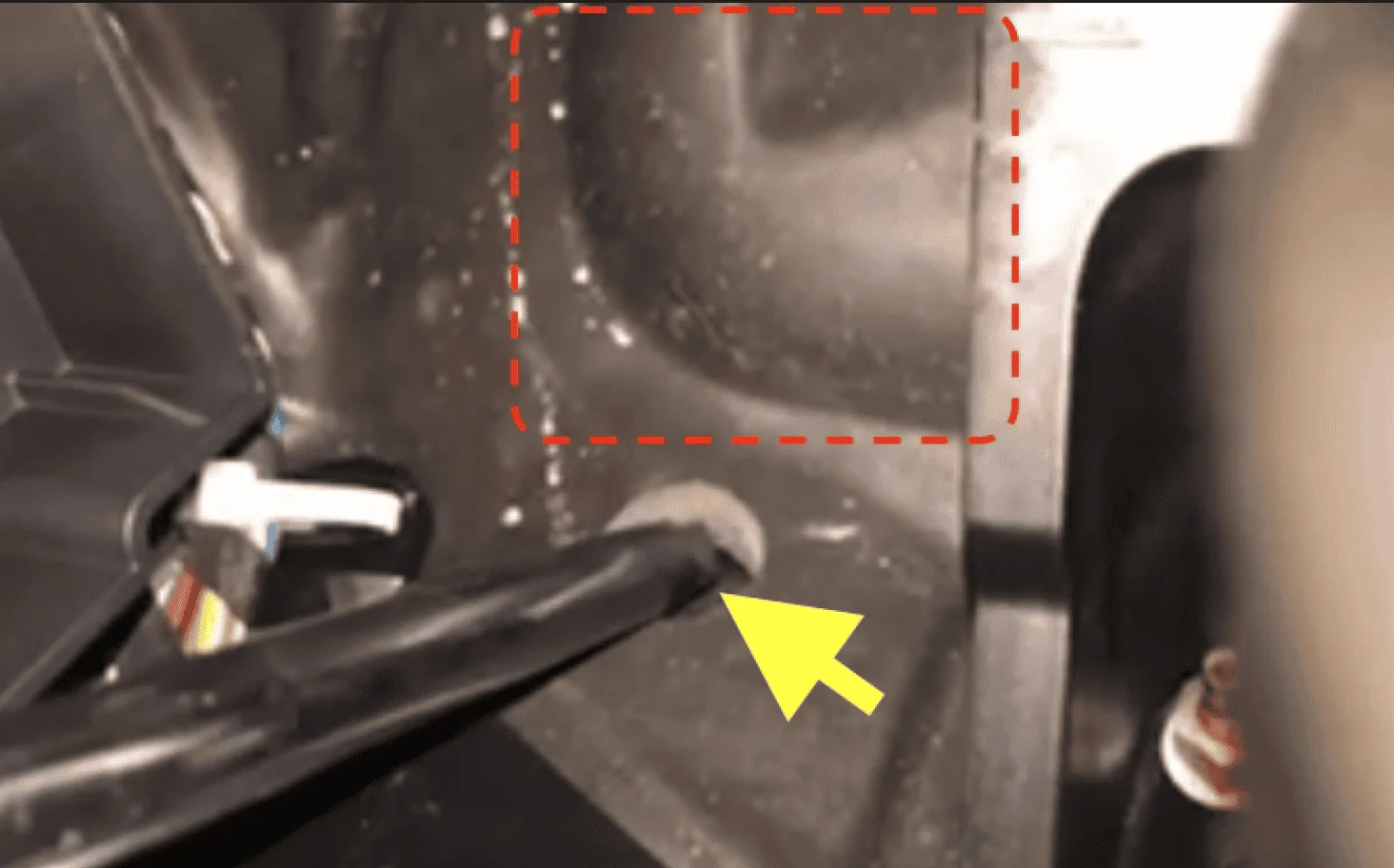

I also had to find a through hole when I wired up my JB4 on my 2020 Premium.
Above your dead pedal look for this L shaped (maybe it was a rectangle, don't remember) emboss inside the red dotted line. Then you will see a round plug you can push in (yellow arrow shows hole) right under it.
This is where it comes out.. GL with the install.
