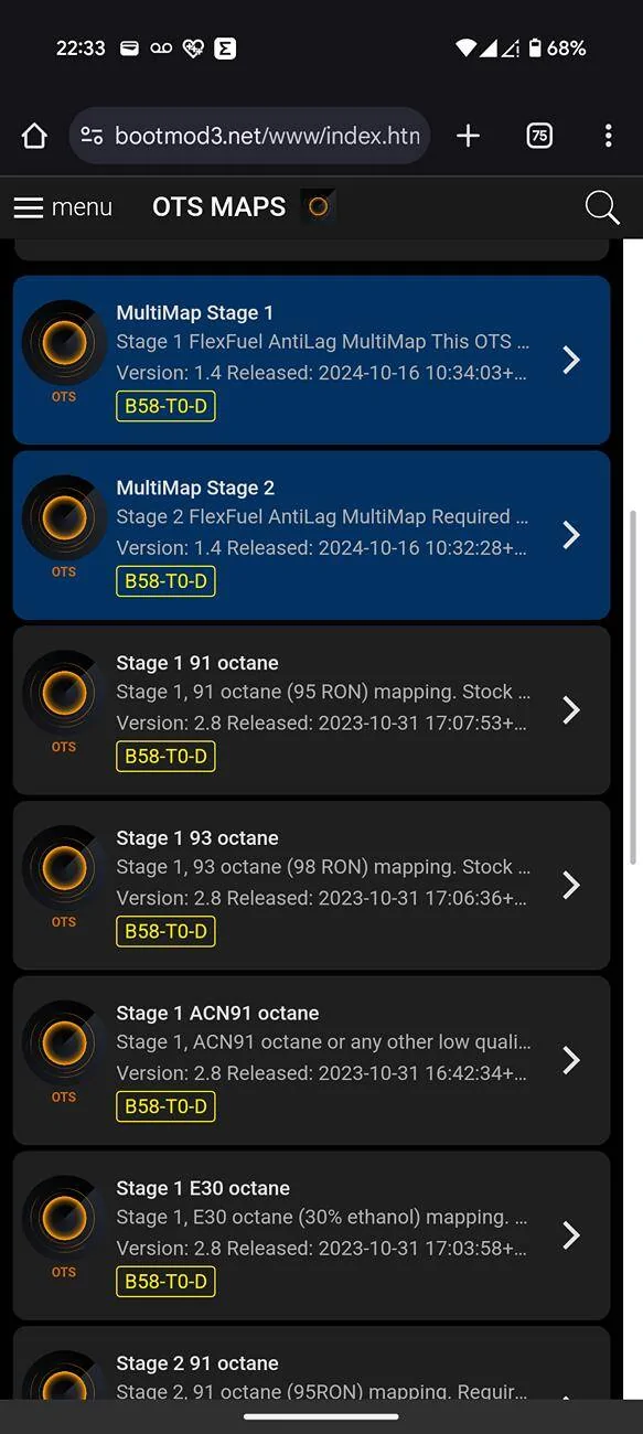

Femto guys were in town, so got my ECU locked. Tinkering with some OTS maps for now. Will get a custom tune a little bit later when more parts are piled on. Doesn't seem necessary to get a custom tune for what is essentially stage 1.

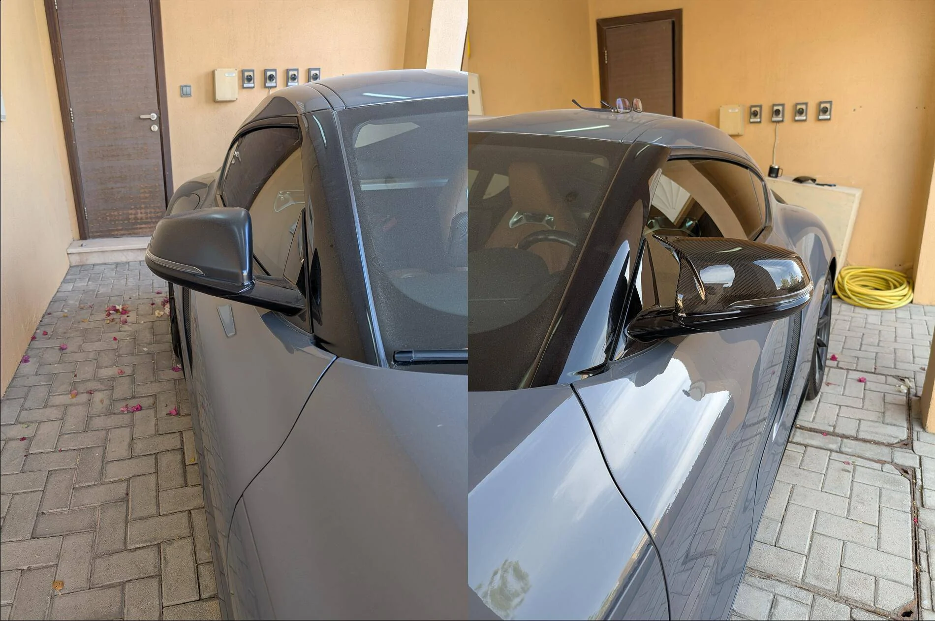

Swapped our the mirror caps for glossy CF ones. The with/without side-by-side really puts into perspective how much of a visual difference this simple mod does.
