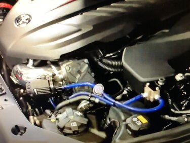

This what i saw from how hks did. Gonna install this tmr

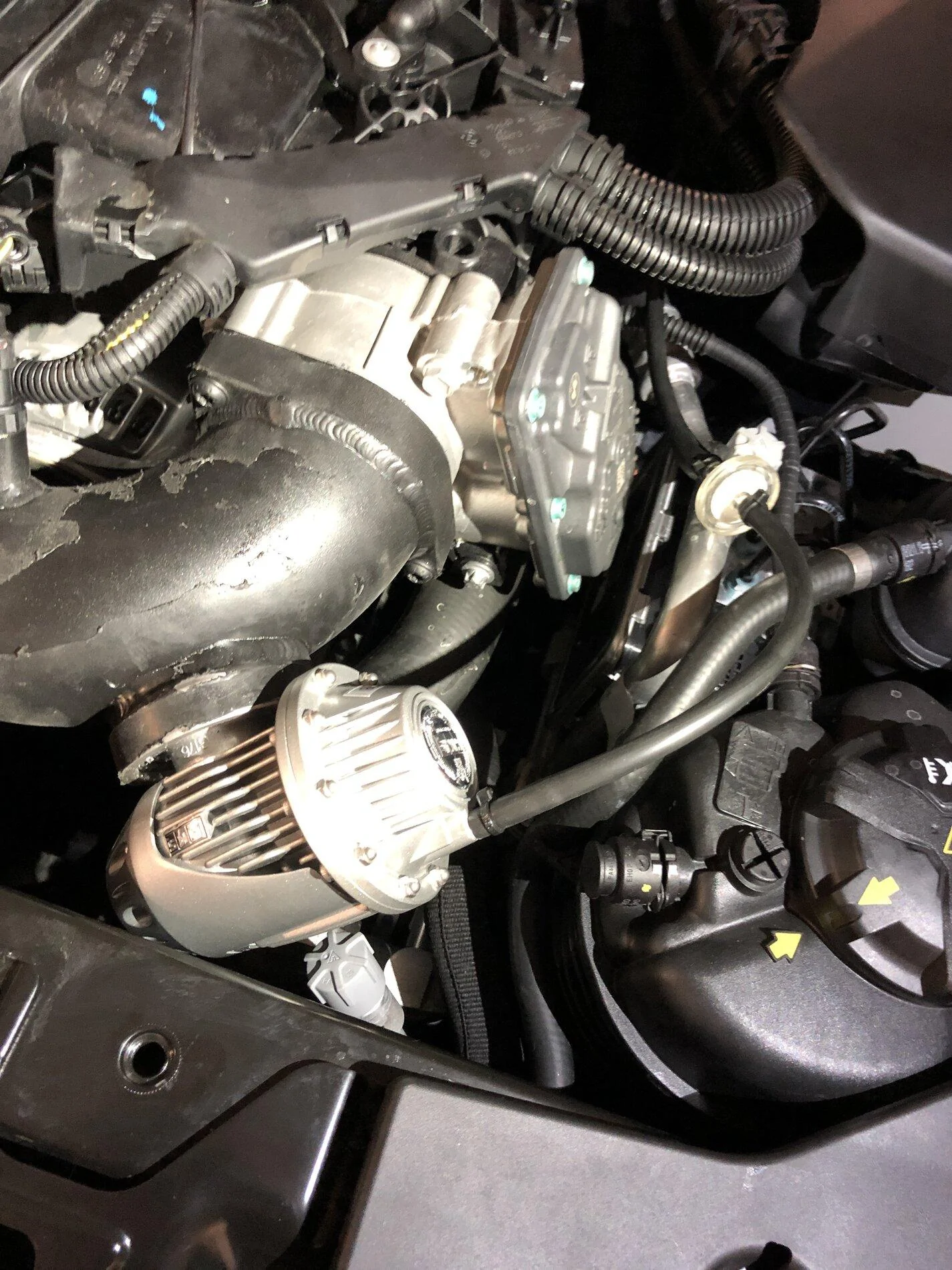

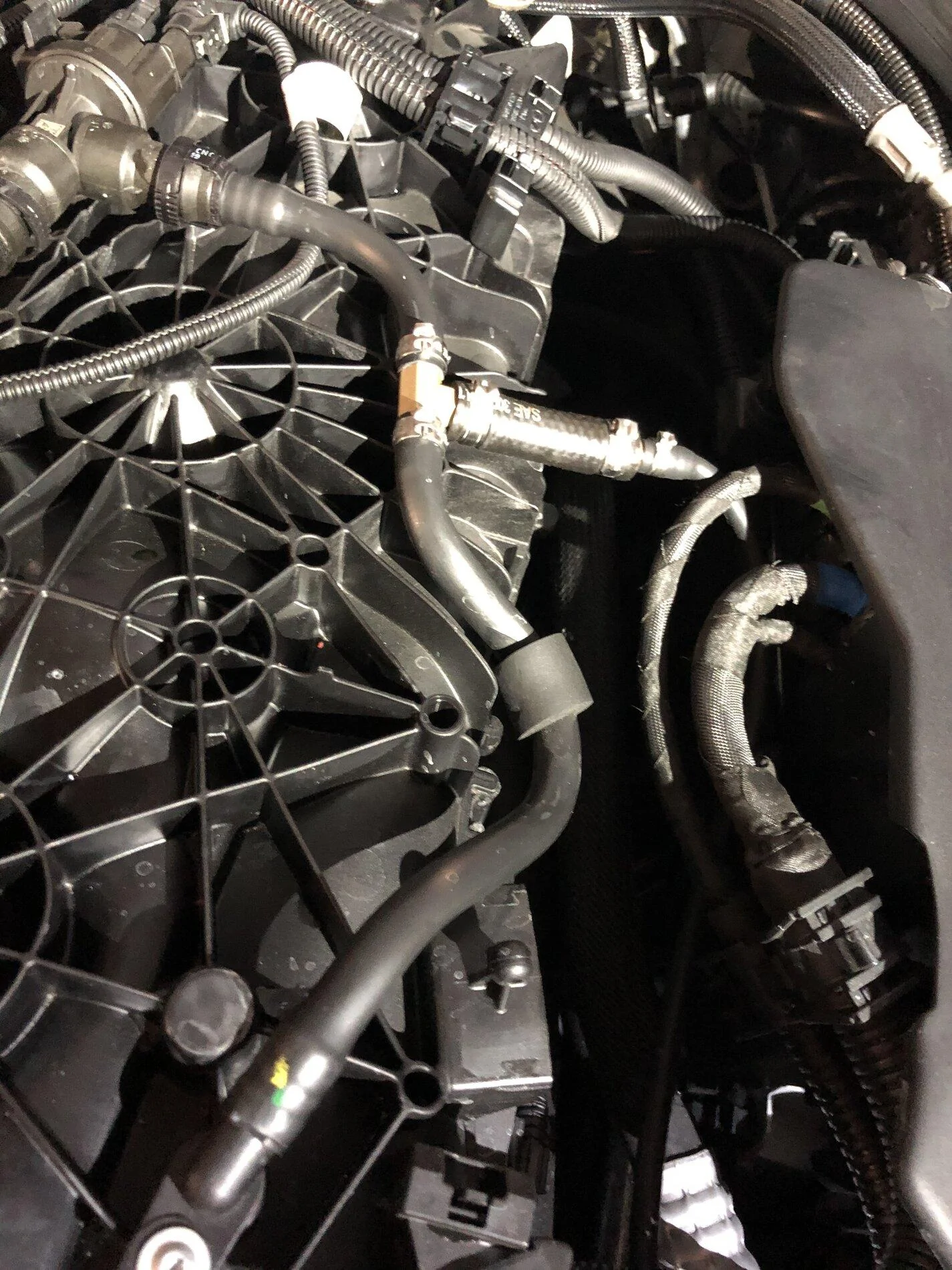

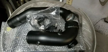

So tonight just finish install it.. overall when engine rev on park gear the bov not gona have sound, just need drive it n it will boost sound so loud.. can be said this system is works without issue, no power drop and no cel.. the custom charge pipe was done by speed force racing, Santee CA.. thx so much for my buddy Tim
And the installation was done by precision garage racing,LasVegas.. thx for my buddy Mike 33B2AF16-CE72-4E0B-BFBC-8CFA2FC40EF8.jpeg 788717DF-C0E6-4CF6-B262-15DBE943BBE5.jpeg 6C34CB15-3E8E-4DDC-BF8E-2439F22DA552.jpeg

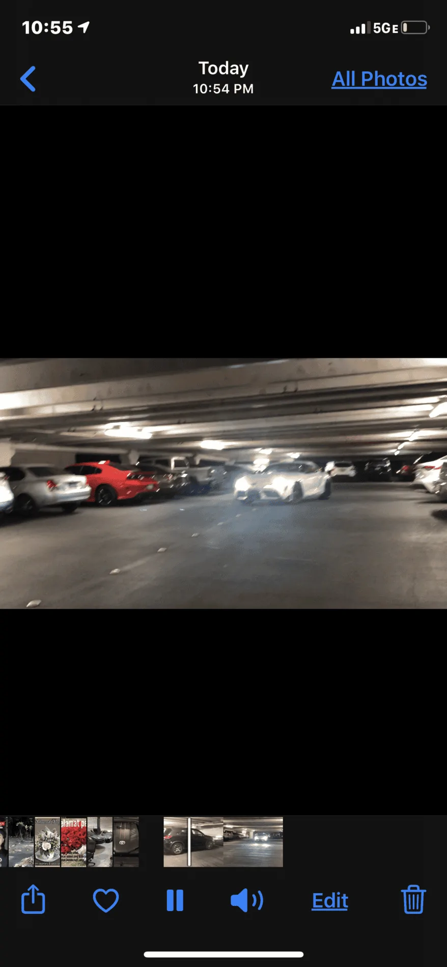

This some clip from my friend from the passanger side sound
https://www.instagram.com/tv/CGEMMkZgfQFh6k-1HWiAgAVAmCqJKylj6LnKy80/?igshid=11ie2z0eie4yaI dunno how to upload video sorry, try took a look on this link
Super curious. IG link requires following, unable to view.
Go on YouTube and select video from phone. You'll have to sign up, click on few things to setup.
Or just put it on Google drive, OneDrive, etc.. I dunno TikTok? :)
or PM me...
[Edit] Got access, here is the video :
https://drive.google.com/file/d/1C7RaZcZ0wVIu4ha6R0DRTHUuWiaufIyY/view?usp=drivesdk
Starts at 00:17 ends 00:26. Faint on 01:33-37. Rest is talking...
Awesome. Can't go wrong with blow off music.

Where u buy bov from
Twisted Tuning
Justin
Mar 10, 2019
1,028
1,264
New York
www.twistedtuning.com
BOVs typically need Boost and Vac ref to function the best. From the look of the setup, its only boost going to it and no vac. So response will tend to be a bit lazier. There should probably be a controller or something that controllers the solenoid.
