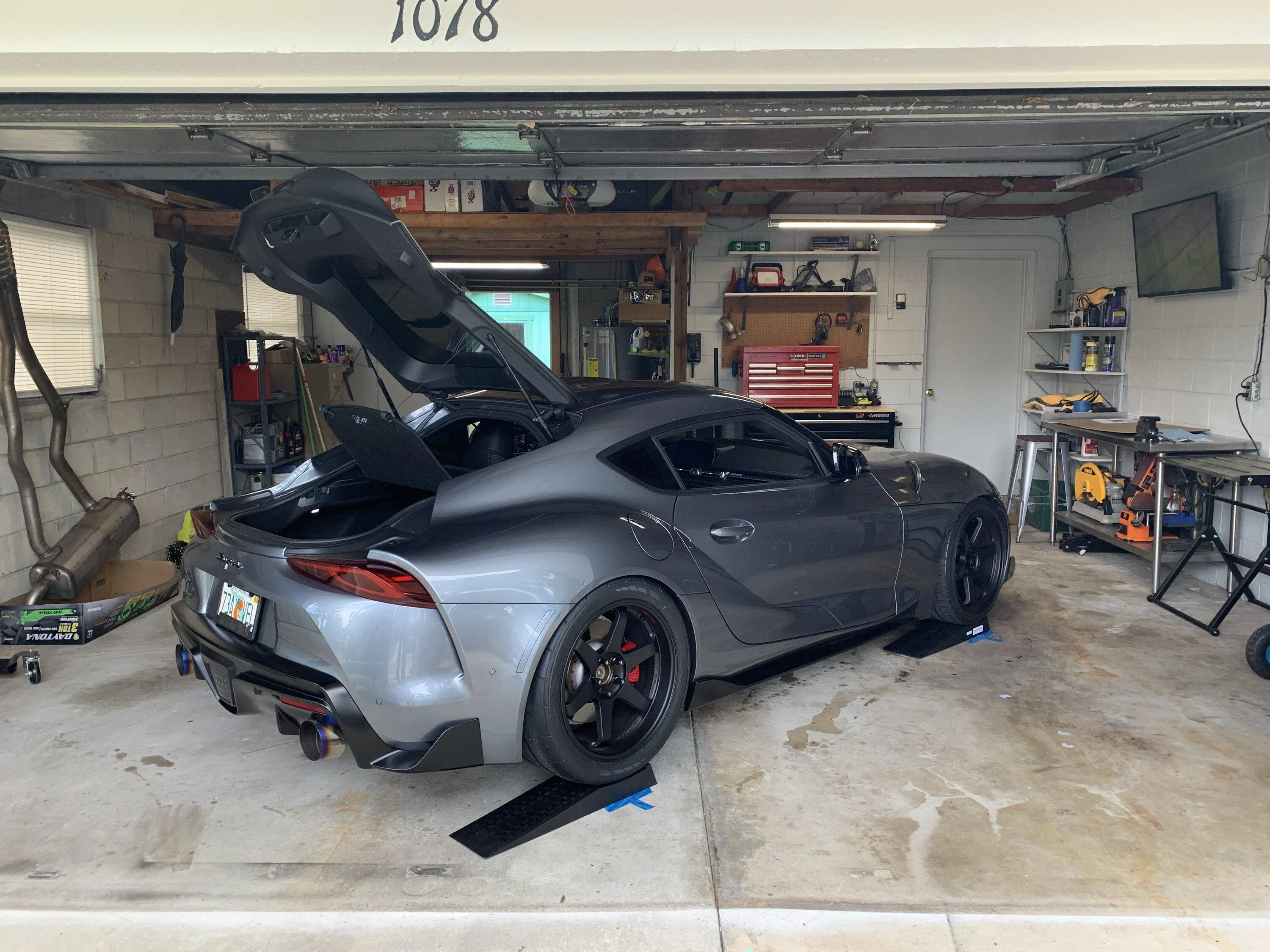

Been working on this build for only a short period but figured I will document it going forward. I bought the car in January 2022. My goal is to be an 8 second street car.

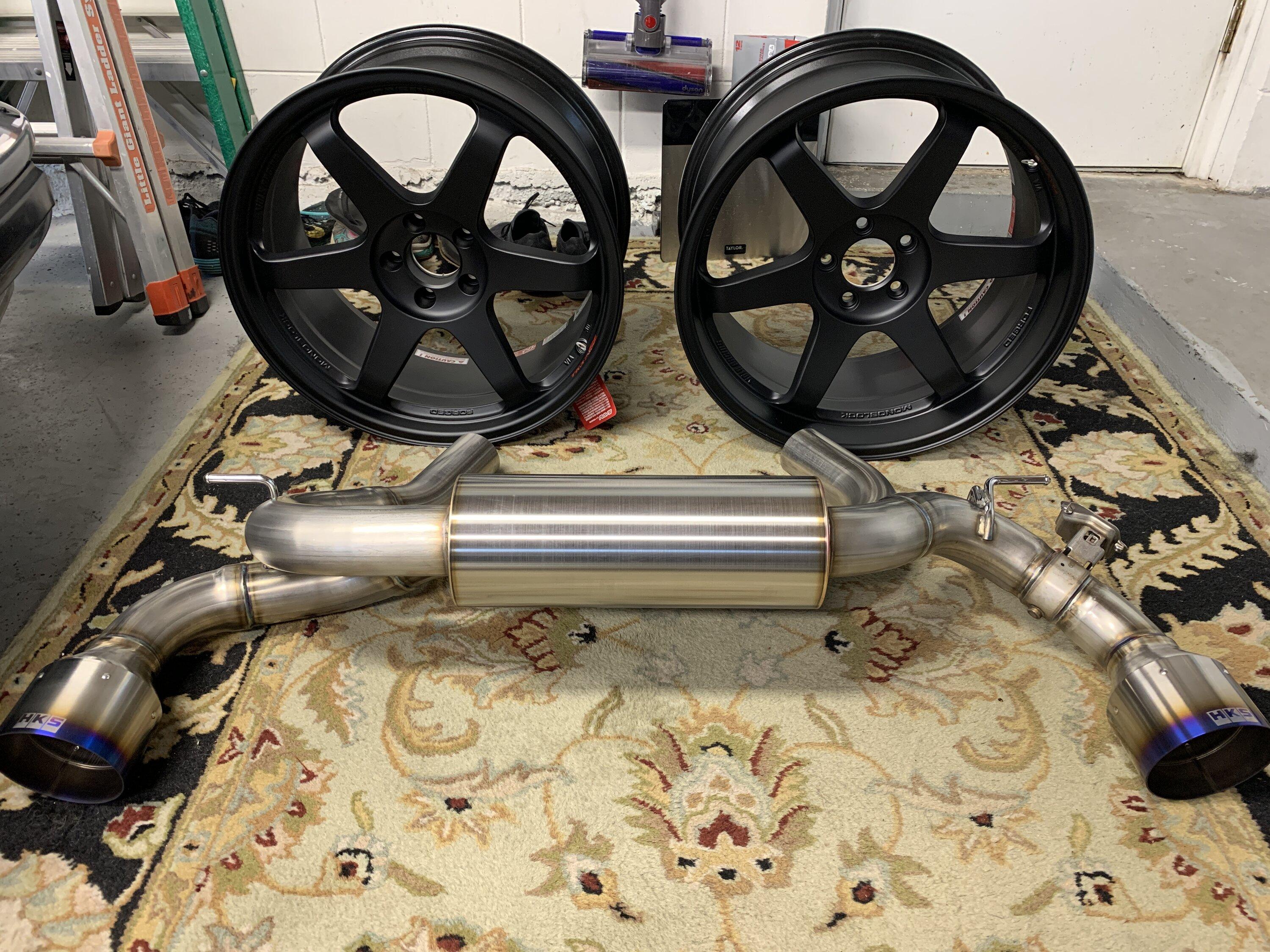

-Volk TE37 Matte Black (Supra spec)

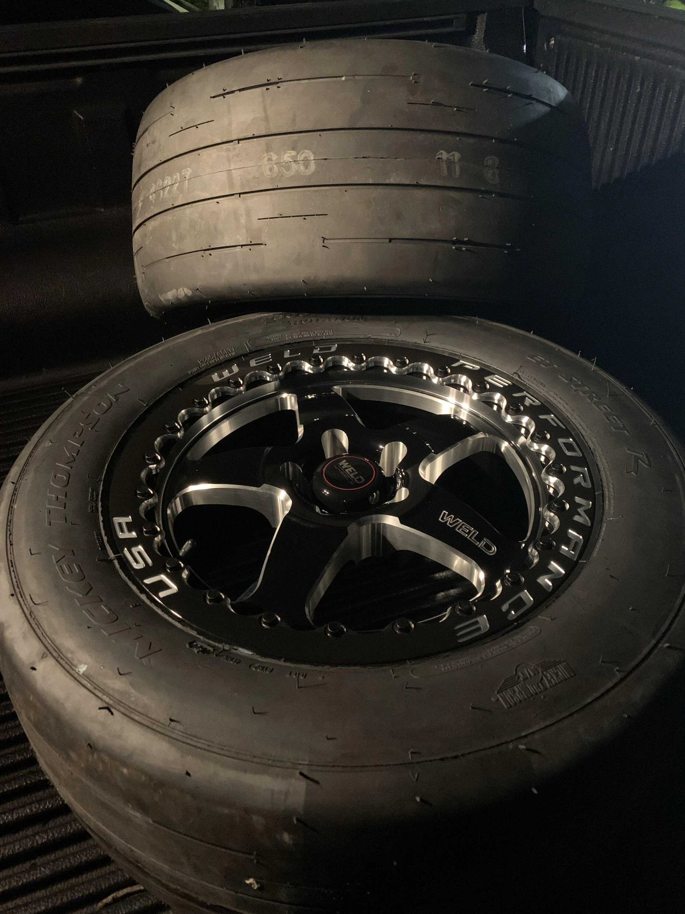

Drag Pack
- Weld S71 17x10.5
-Hoosier DBR 28x10.5
-Weld Ventura 18x5
-MT Sportsman S/R 26x6

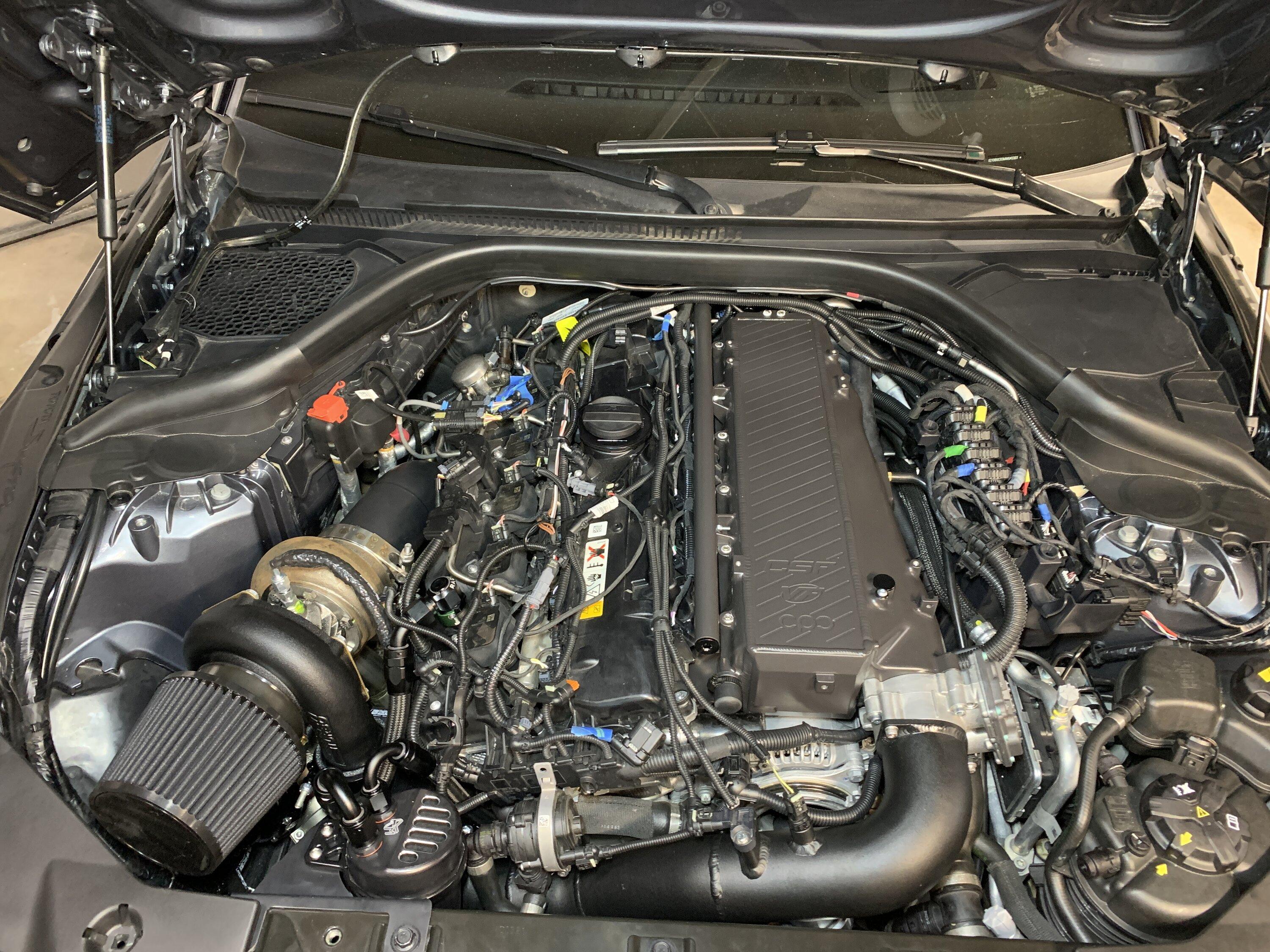

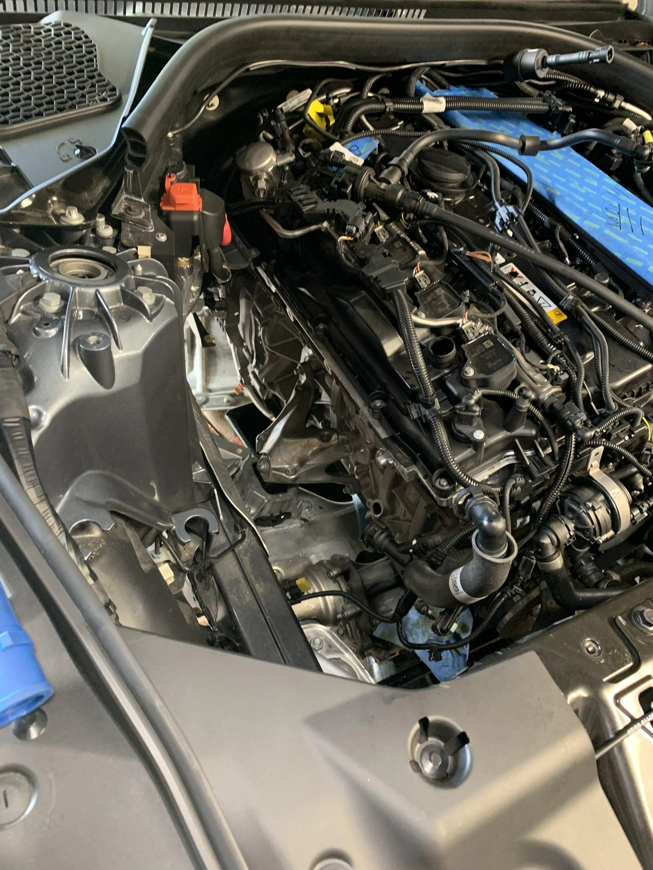

-Femto/Visconti DME cloning with Ecutek
-HKS Exhaust
-CSF Heat Exchanger
-CSF Radiators
-CSF Trans cooler
-CSF Intake Thermal Spacer
-CSF Intake Manifold

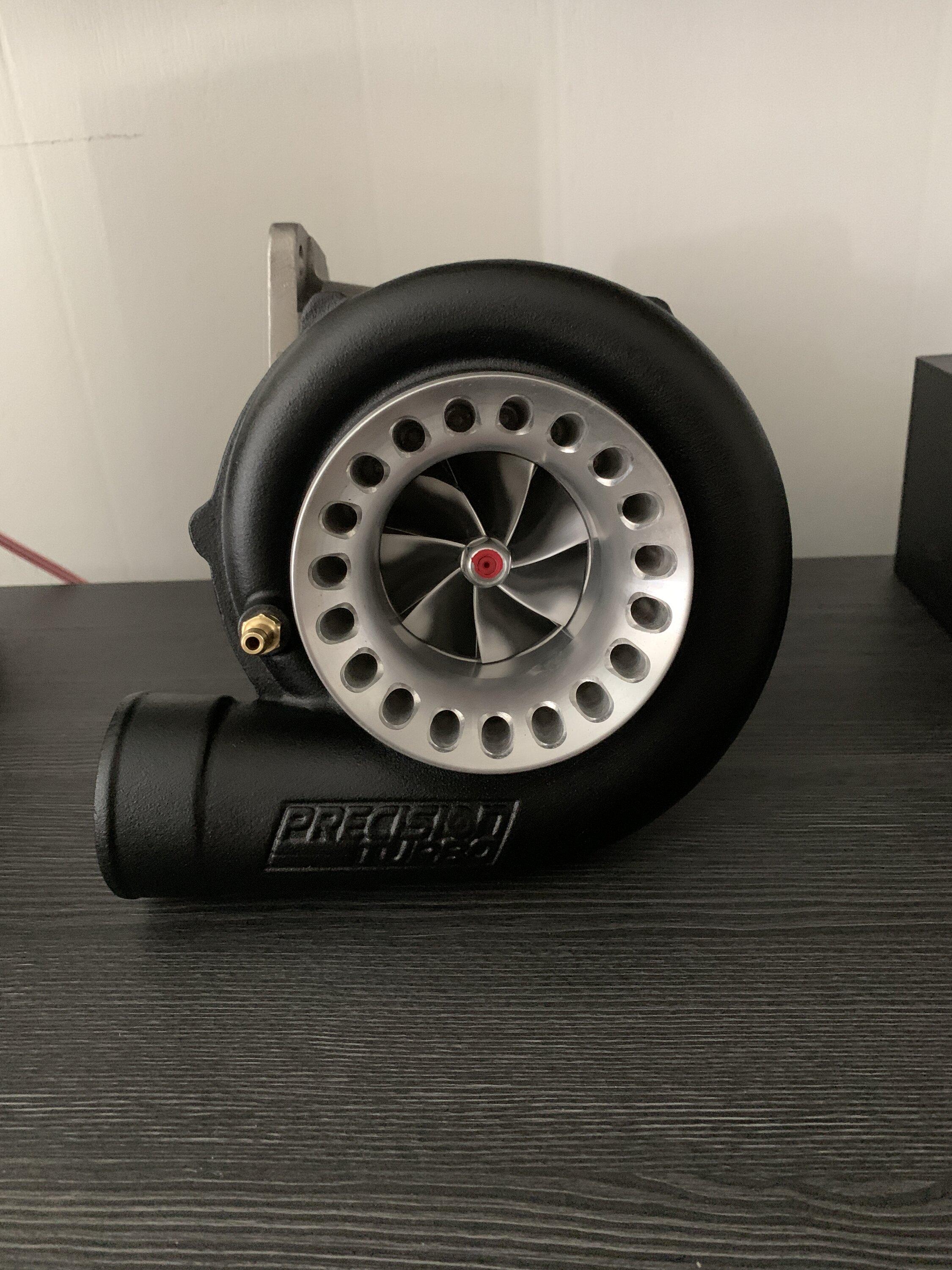

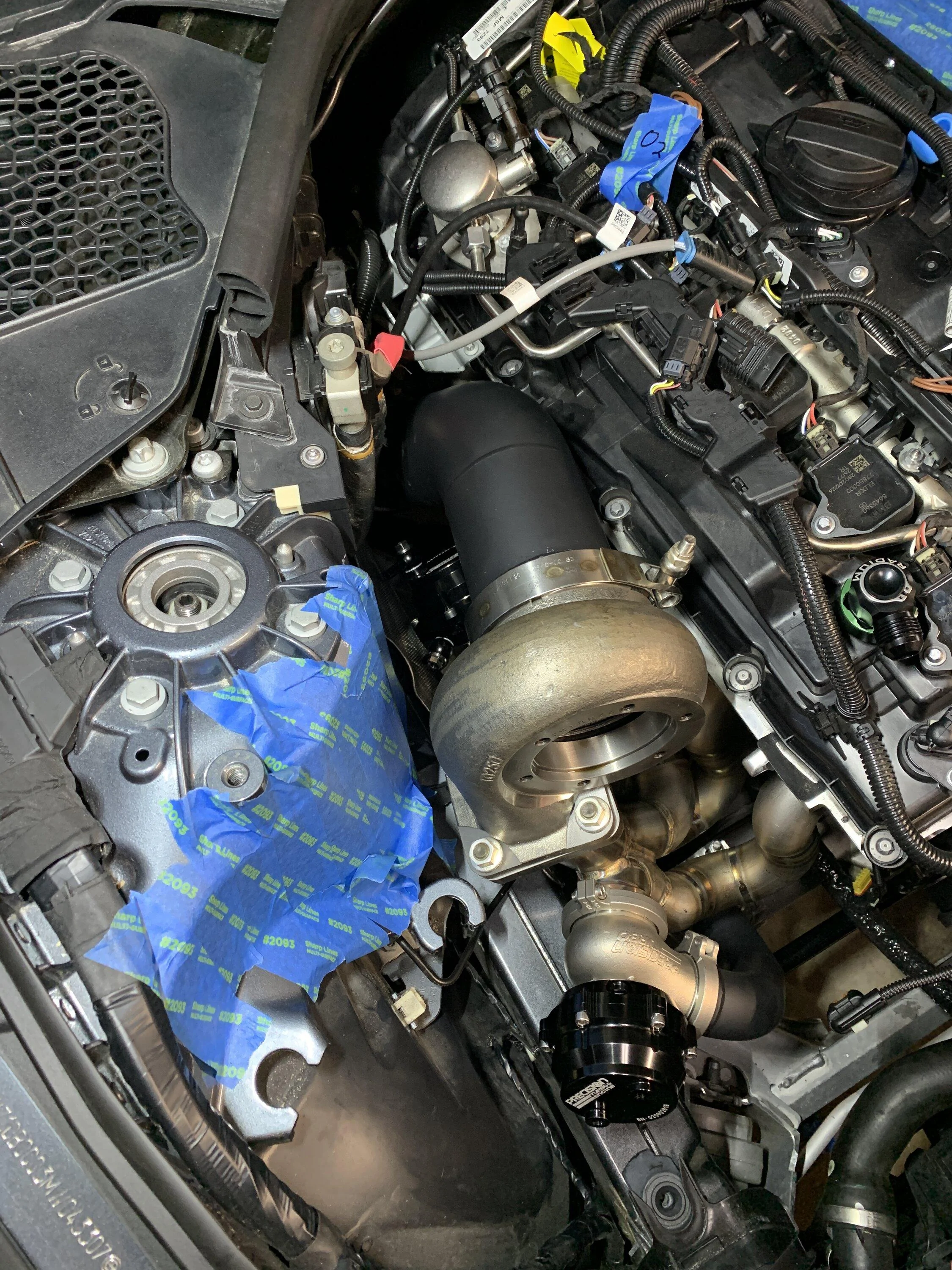

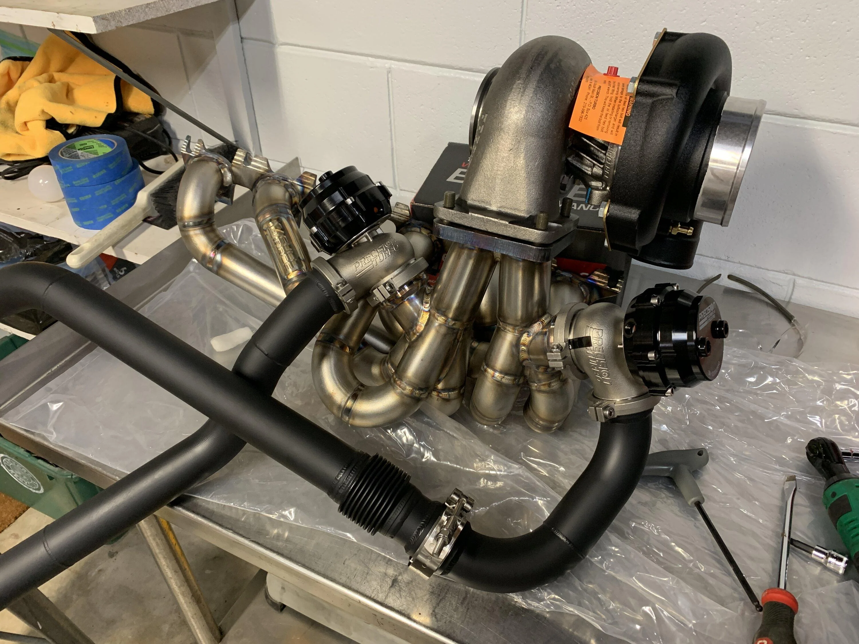

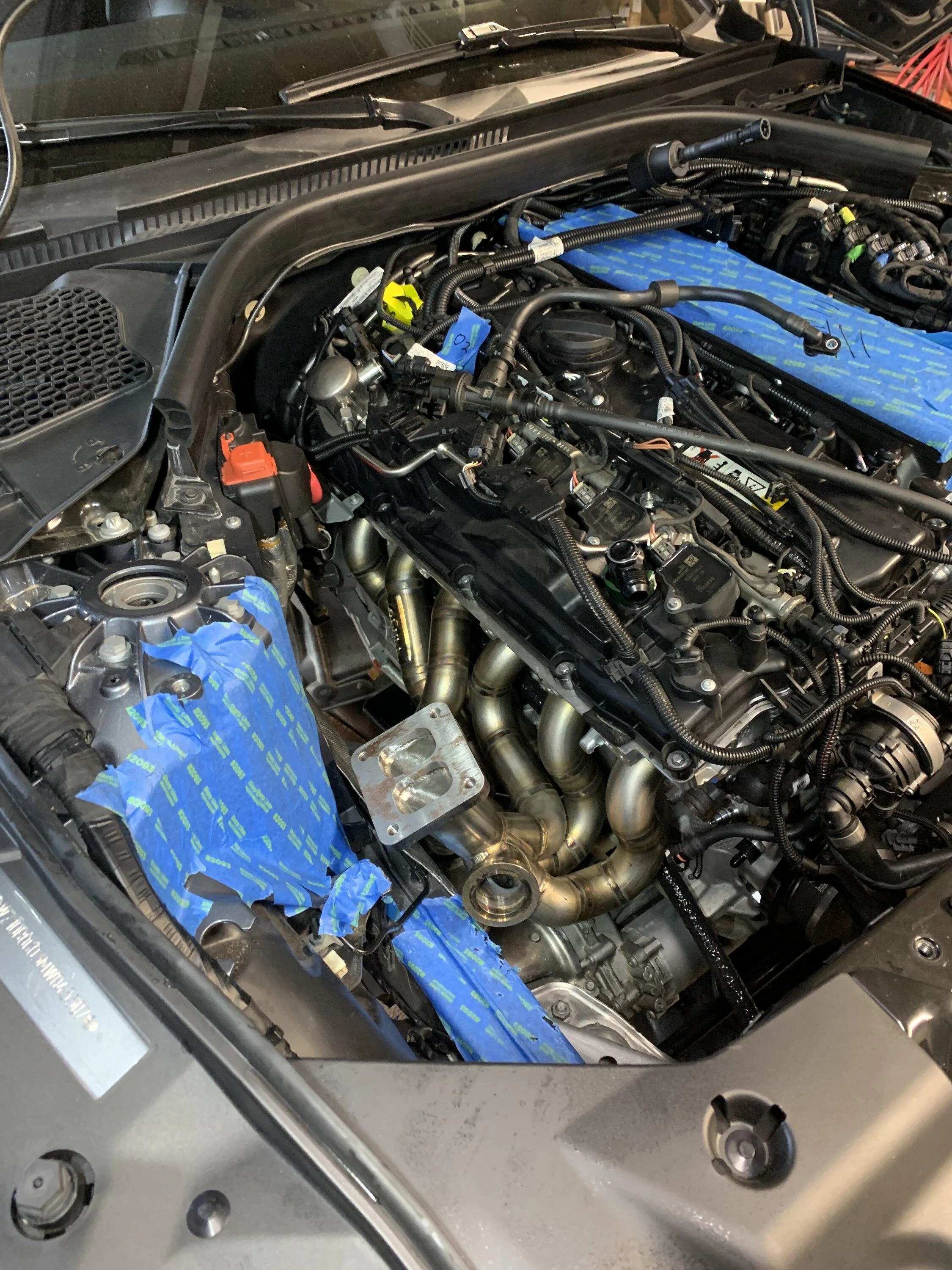

-Full Race/Titan Motorsports 6 Port Turbo Kit w/ PTE6870
-PTE 46mm Wastegates Gen 2 x2
-Tial Q bov
-Motiv ReFlex
-Visconti LPFP
-Visconti PI kit
-Fuel Injector Clinic 1650cc injectors
-AEM v3 Water/Meth Injection kit w/Snow Performance 1000cc injector
-Visconti Flex Fuel kit
-Visconti Valve Cover
-KLM Catch Can
-Pure Transmission Stage 1
-Pro Torque Billet Torque Convertor
-DSS CF Driveshaft
-Titan Motorsports Axles
-XHP Trans tuner
-ETS turn down exhaust (track only)
Engine Dress Up
-Custom CF Engine Cover
-NV Specialties CF DME Cover
-Rexspeed CF Coolant Cover
-ARP CF Cover
-Verus Cap Covers
-KLM water pump delete

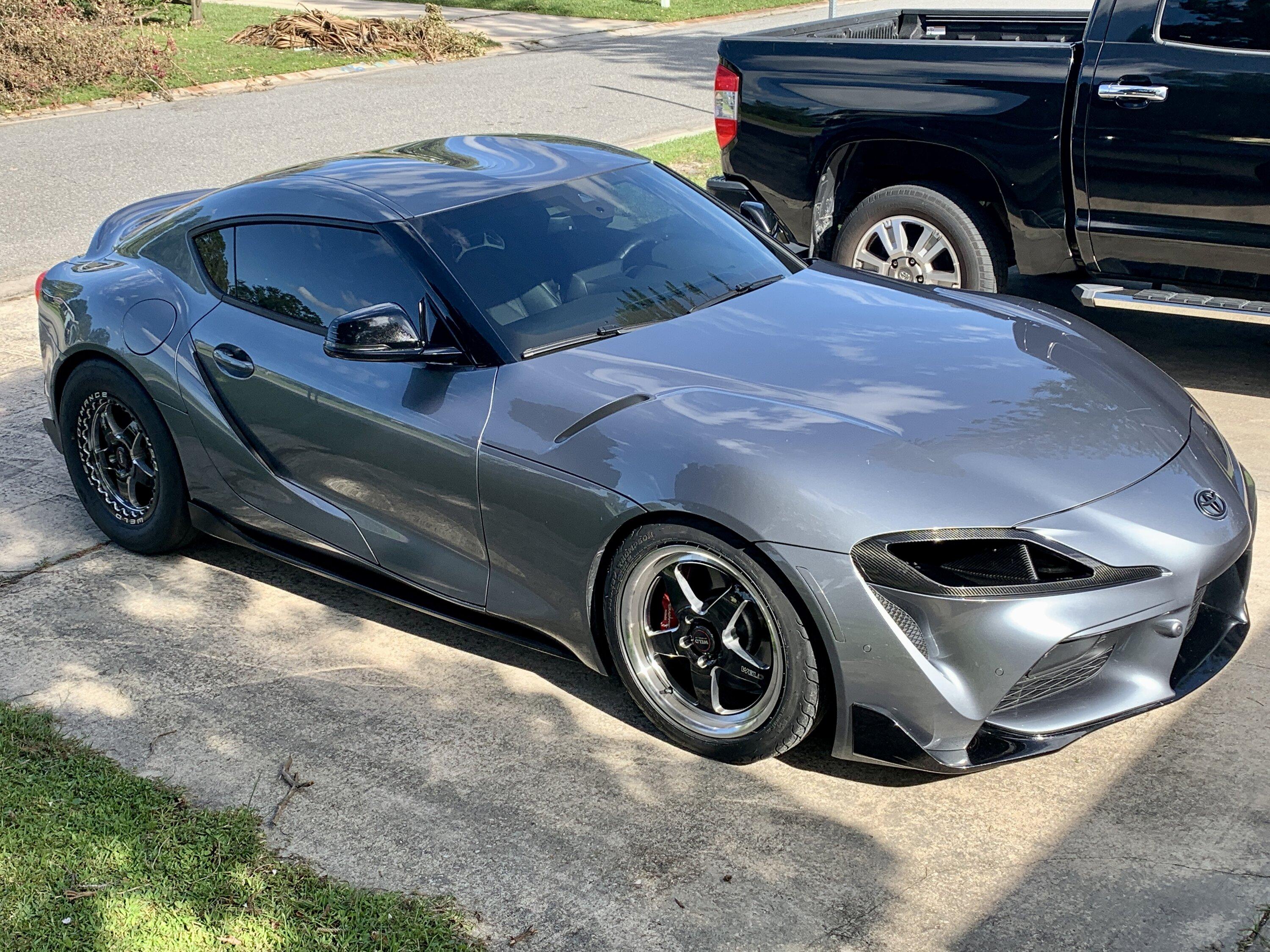

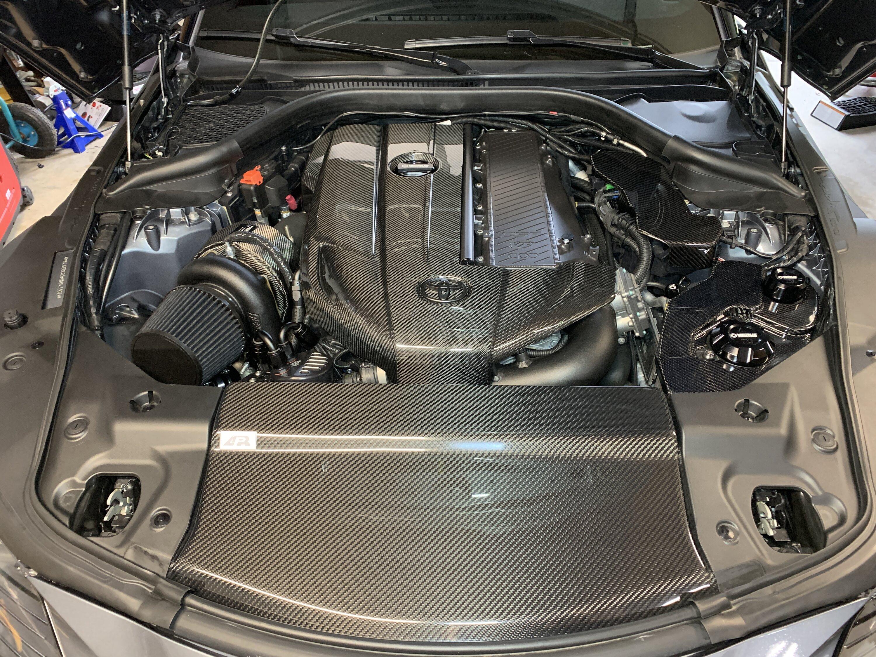

Been a long time since I updated this thread. So I finally got the car tuned and ready for FL2K. Installed my Eventuri headlight duct and my drag pack. Qualifying is where I got my first passes on this setup. Wish I was able to get more hits prior but that just didn’t work out.

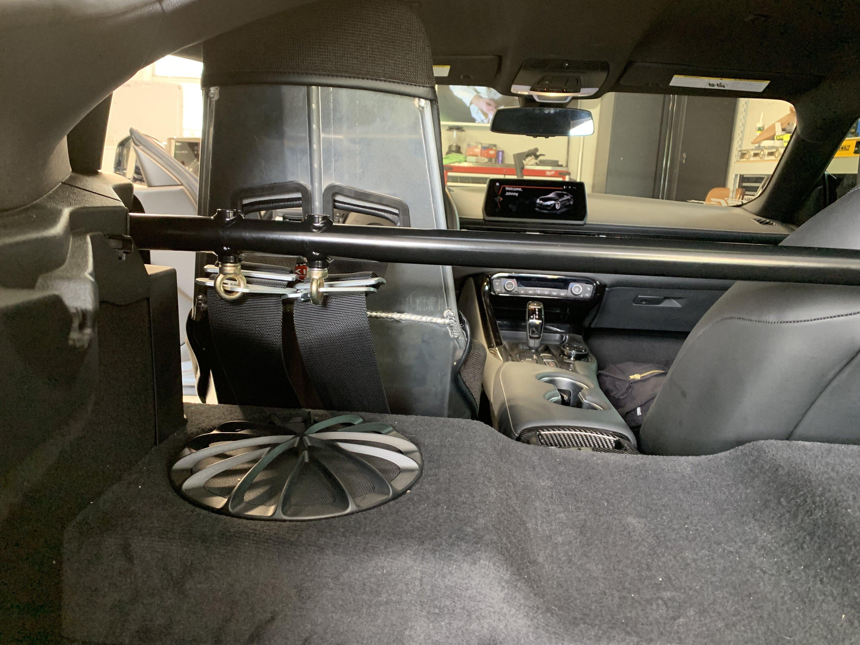

Best pass for me was during elimination round 1 where I got knocked out. I got treed big time. Ran 9.7 at 153.

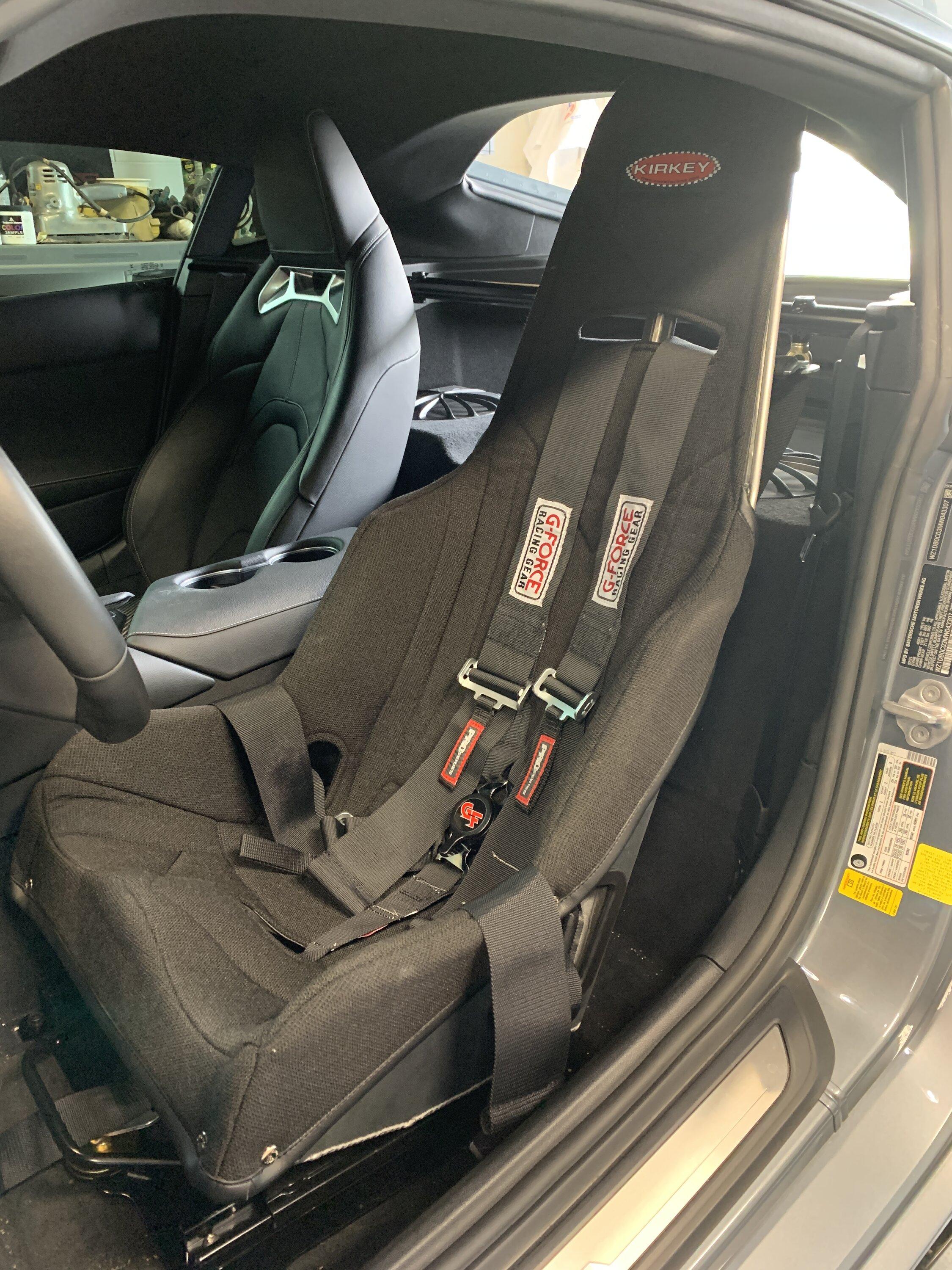

Since FL2K I’ve installed a Kirkey seat and Cusco harness bar.

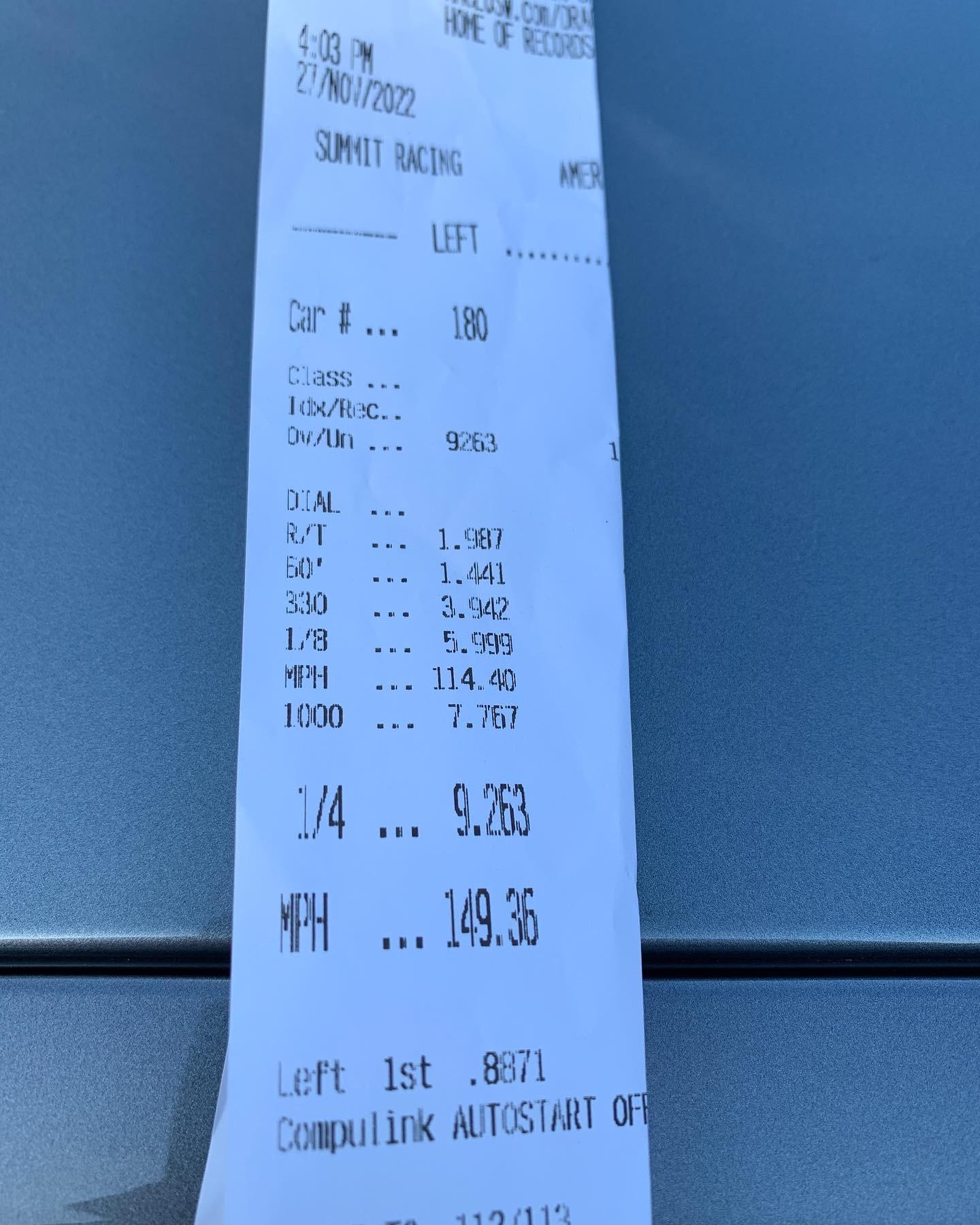

Now I’m still working on improving my short track. Get that ET down and hopefully get into the 8’s soon. Now my current best time is 9.2 @ 149mph with a 1.4 60ft. So still room for improvement. And was 87 degrees with a high DA.

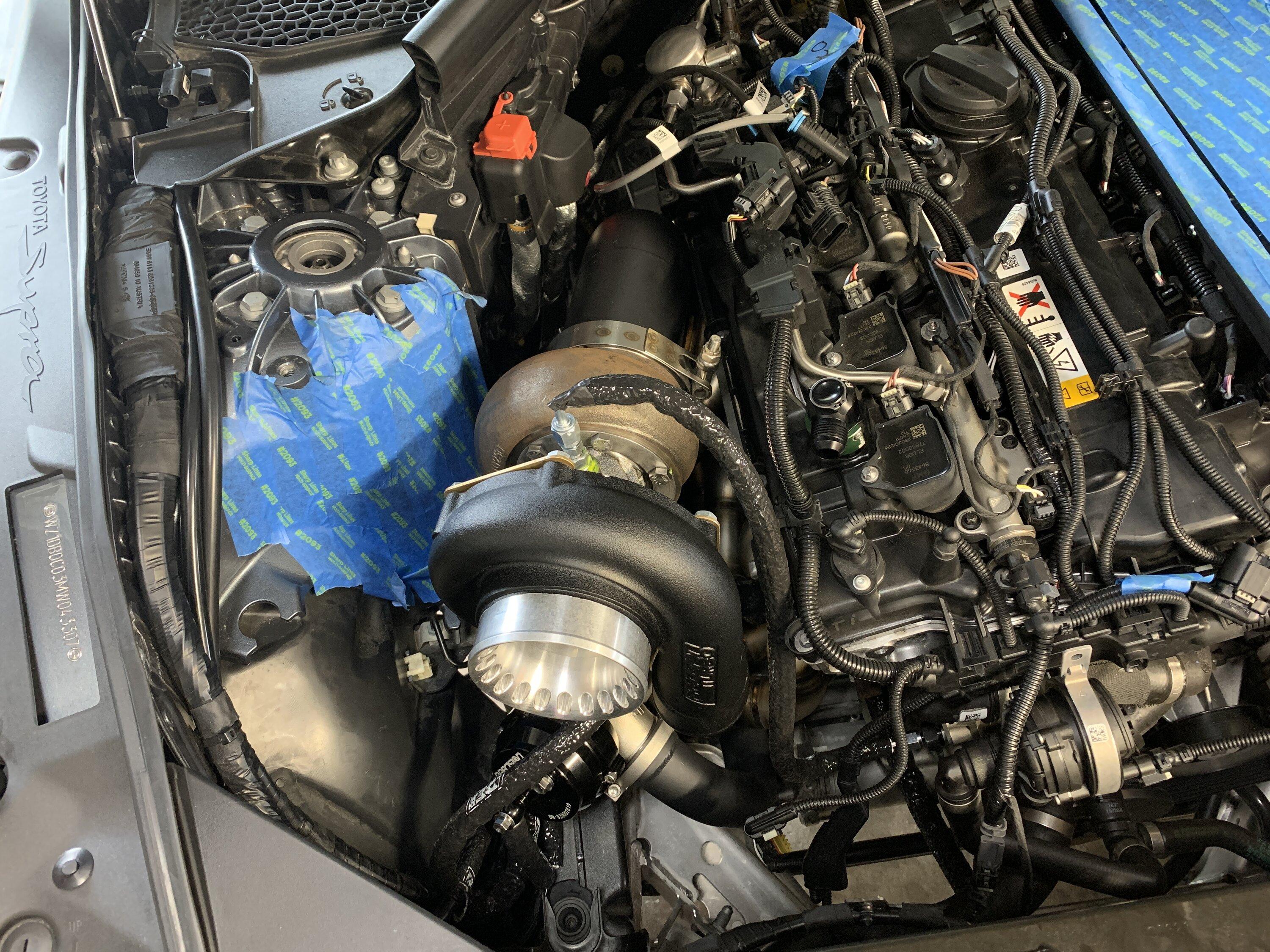

Doing another update as its been a while. So in early March, I finally broke into the 8's. Went 8.83 @ 159.5mph, with a horrible 1.5sec 60'. Accidently pushed through the beams. Then went to TX2K, and was able to run another 8.90 lifting, all after having tons of transmission issues during qualifying. I was also able to get a 3.92sec 60-130 when I ran the 8.8 pass. Not many changes to the car. Switched from PTE 6466 to 6870, and a parachute. Now I'm saving to get the motor built so I can be a little more reliable. I will try and add some more photos and videos.
