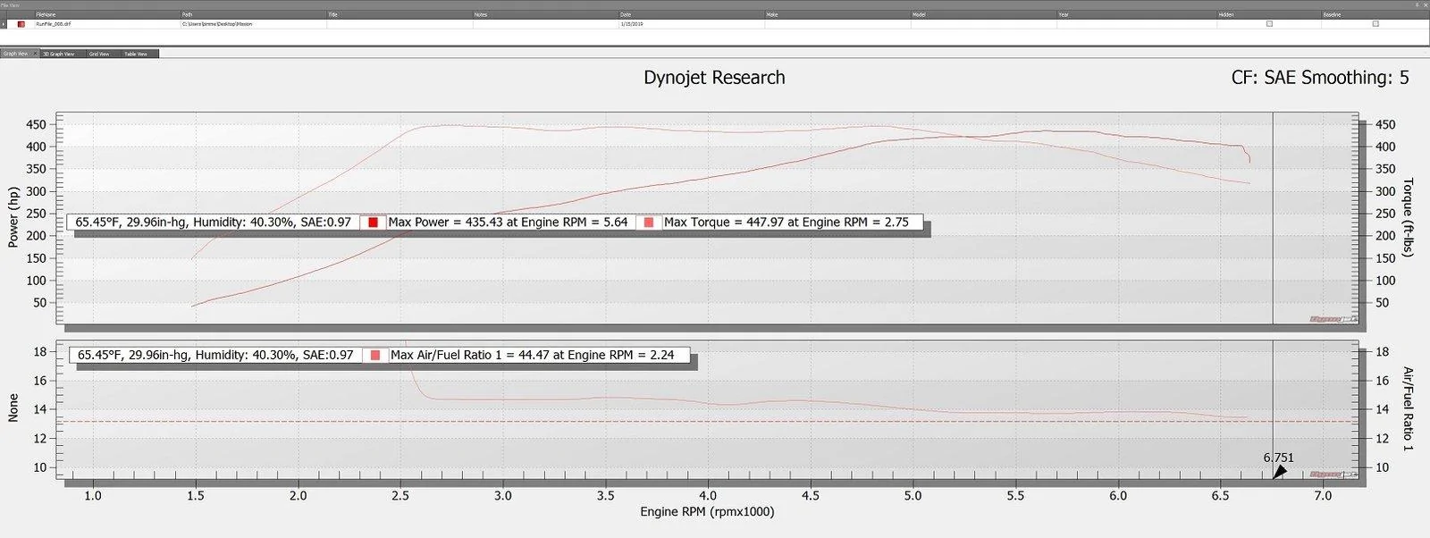

Hello,
I was just browsing the ol’ BMW forums and happened to come across this gem. If anyone was worried too much about the B58, just know that we have at least a good stage 2 tune.
If any of you have followed recent BMW tuning for the B58, one of the earliest to crack the new ECU was Mission Performance. They recently managed to flash the transmission. They upped the amount of torque its clutch pack could take and removed its torque limiter.
The result is a 340i equipped with the B58 making 435whp and 457wtq with SAE correction on a 91 and e85 blend. I would say that is quite a lot for a bolt on 340i without the TU revision.
Mission Performance says these numbers are achievable with only 93 octane and no other modifications. Which means this car makes as much as most BPU A80 TT’s.

Few problems I see:
"flash the transmission and upped the amount of torque its clutch pack could take"
Exactly how? just software change, or was their part replacement/changes?
Whats the cost? Is is the same price as bring a 2jz up to 500RWHP?
Whats the reliability? Did the change mean the auto tranny and B58 will go pop within 20k miles?
I'm tempted to think that if your going to spend decent amounts, a 2JZ could be more cost effective, allowing bigger horsepower gains for less cost and higher reliability.
Moreover , given an A80 TT6 would cost you a fraction the price of a new A90, then surely it would be a far superior option with all the excess funds you would have put into a well established and proven platform. Why spend all that huge money on a A90, when you could take an A80, and make it monster in power and handling that no A90 will ever touch for remotely the same price.
Most of all, its a case of praying you can keep a warranty on an A90 after making any changes.
Well for one, yes, they increase the actual pressure applied by the clutch packs, two the zf trans is pretty tough, three a tune is less than 1k, and four, if the new Supra is going to always cost more and be less proven, then why would anyone want a new Supra if the old one is proven and cheap. It’s because I want a car I can drive everywhere and have modern conveniences while maintaining a fun driving experience.
