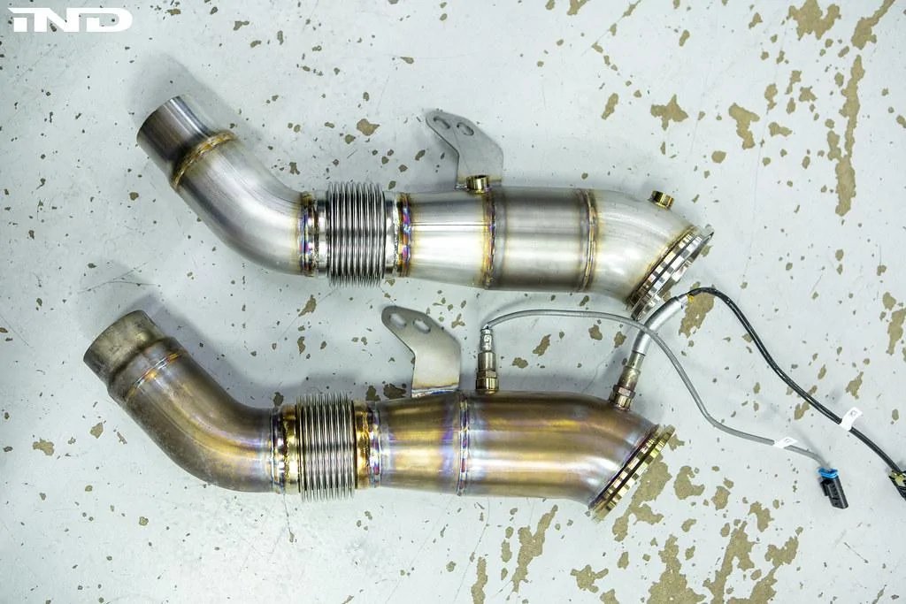

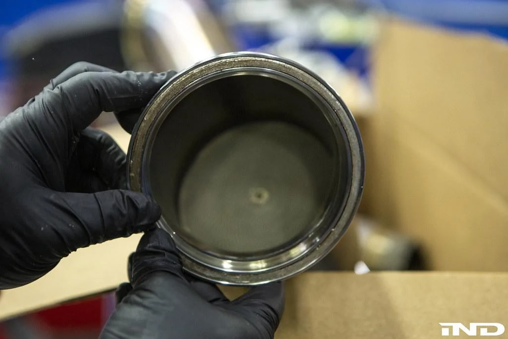

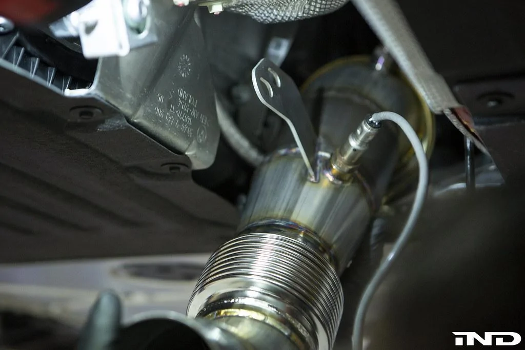

We are currently running a prototype AMS Performance catted downpipe on the iND Supra. Previously we ran the catless downpipe and performance feels identical. No odor or CEL with the catted set.
Would love to see a dyno test of the difference between the catted vs catless downpipe.

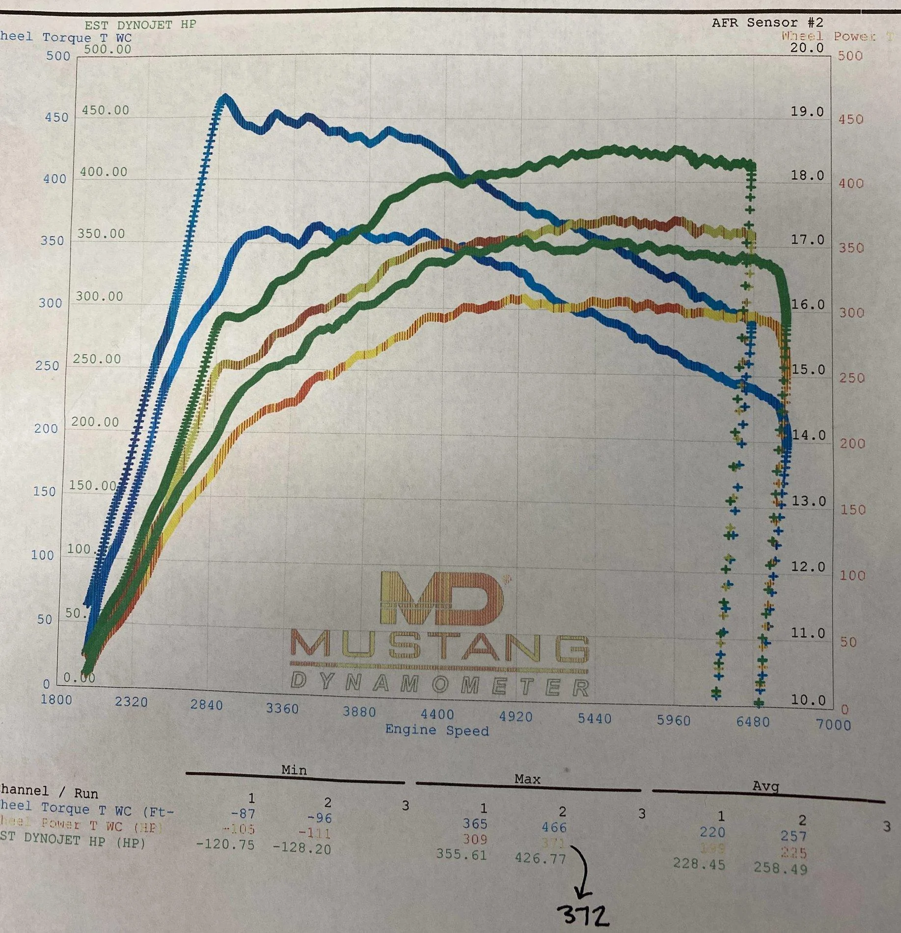

Would be nice to see. I spoke to AA before purchasing mine and they said that until you get past 600 whp (i.e. upgraded turbo), there's not much performance difference between the catted and catless.
Remember with the catted downpipe, you're using a higher flow cat along with eliminating the downstream cat in factory downpipe. That's removing quite a bit of restriction. Today my car made 372/466 on a mustang dyno with an AA catted downpipe if that helps with making your decision.

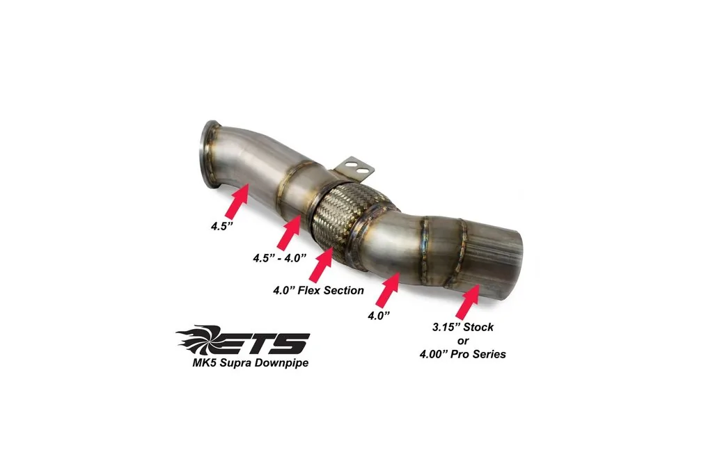

Any idea how many cells for the cat? Looks like it's 4" in diameter at the flex section correct?
I'm still researching but so far the only other one like that catted I have seen is the ETS Downpipe
There might be others but I haven't found one yet.
