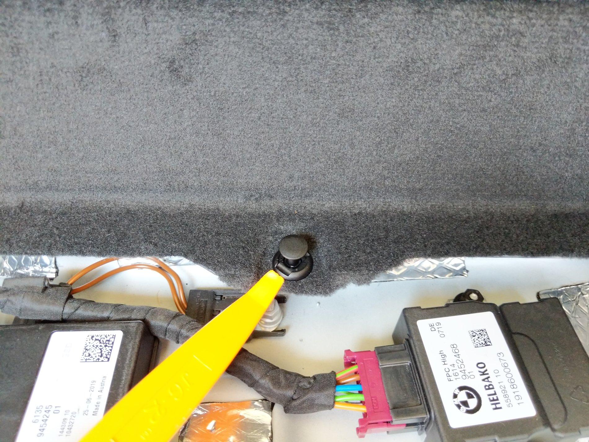

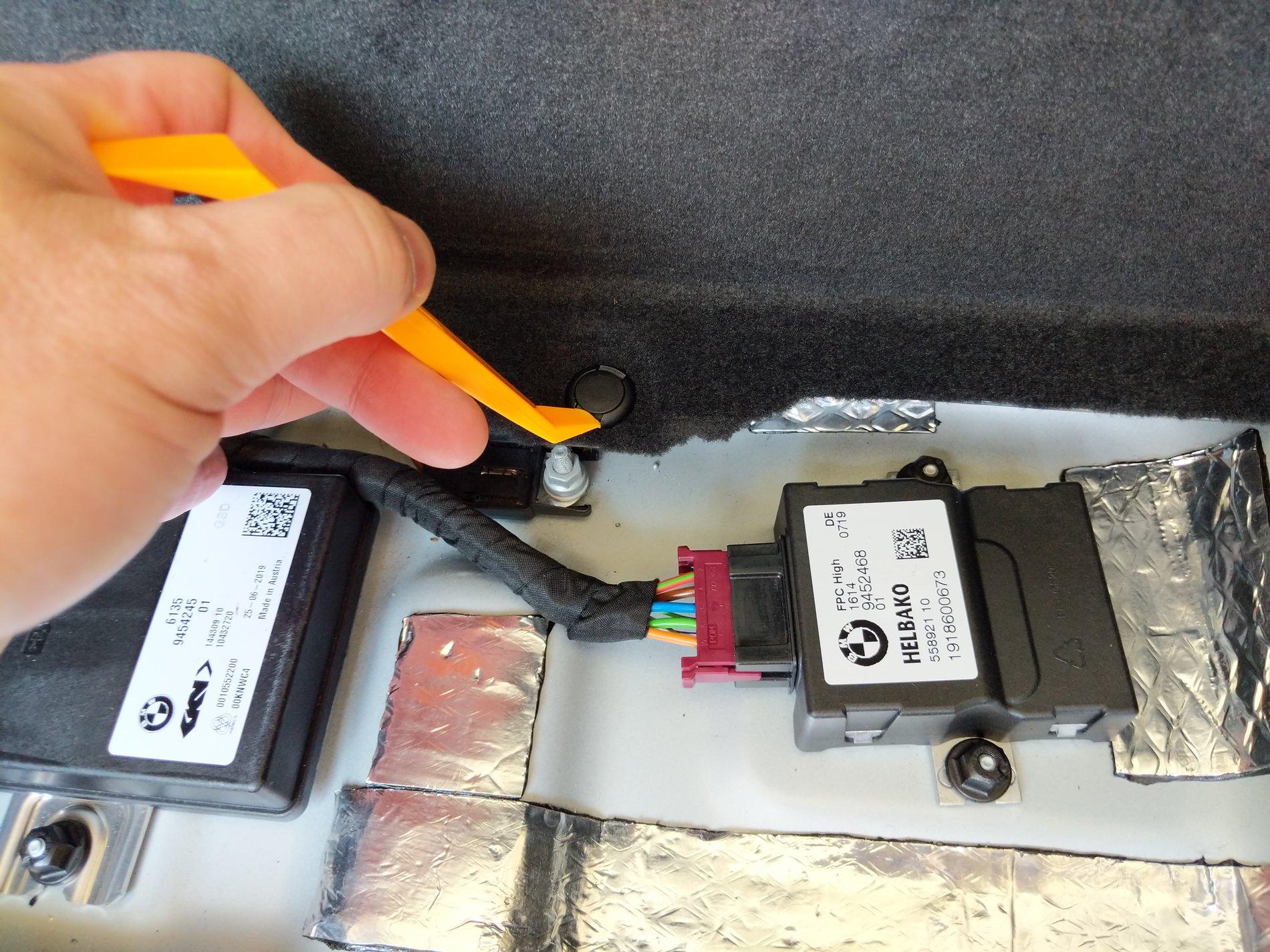

> Remove Push Clip From Rear Subwoofer Deck
> Pull Edge Of Round Clip Up
> Then Pull Entire Clip Out Of Hole

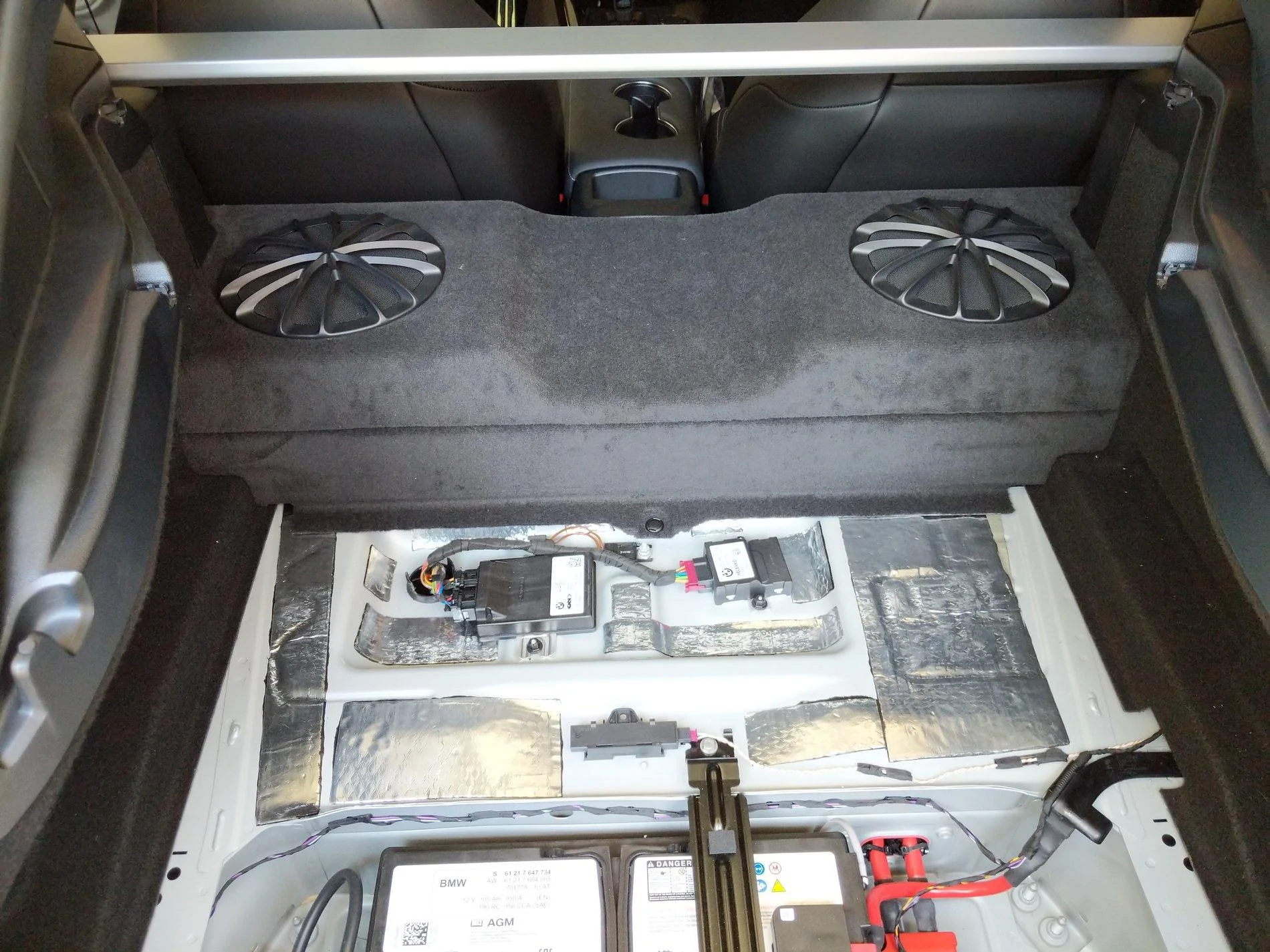

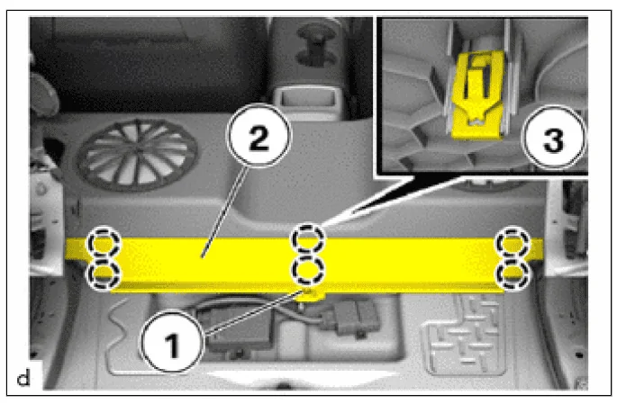

> Remove Rear Subwoofer Deck
> Pull Back Subwoofer Deck Towards Rear Of The Car
> Deck Is Held In Place By Pressure Clips Which Will Unsnap When Pulled

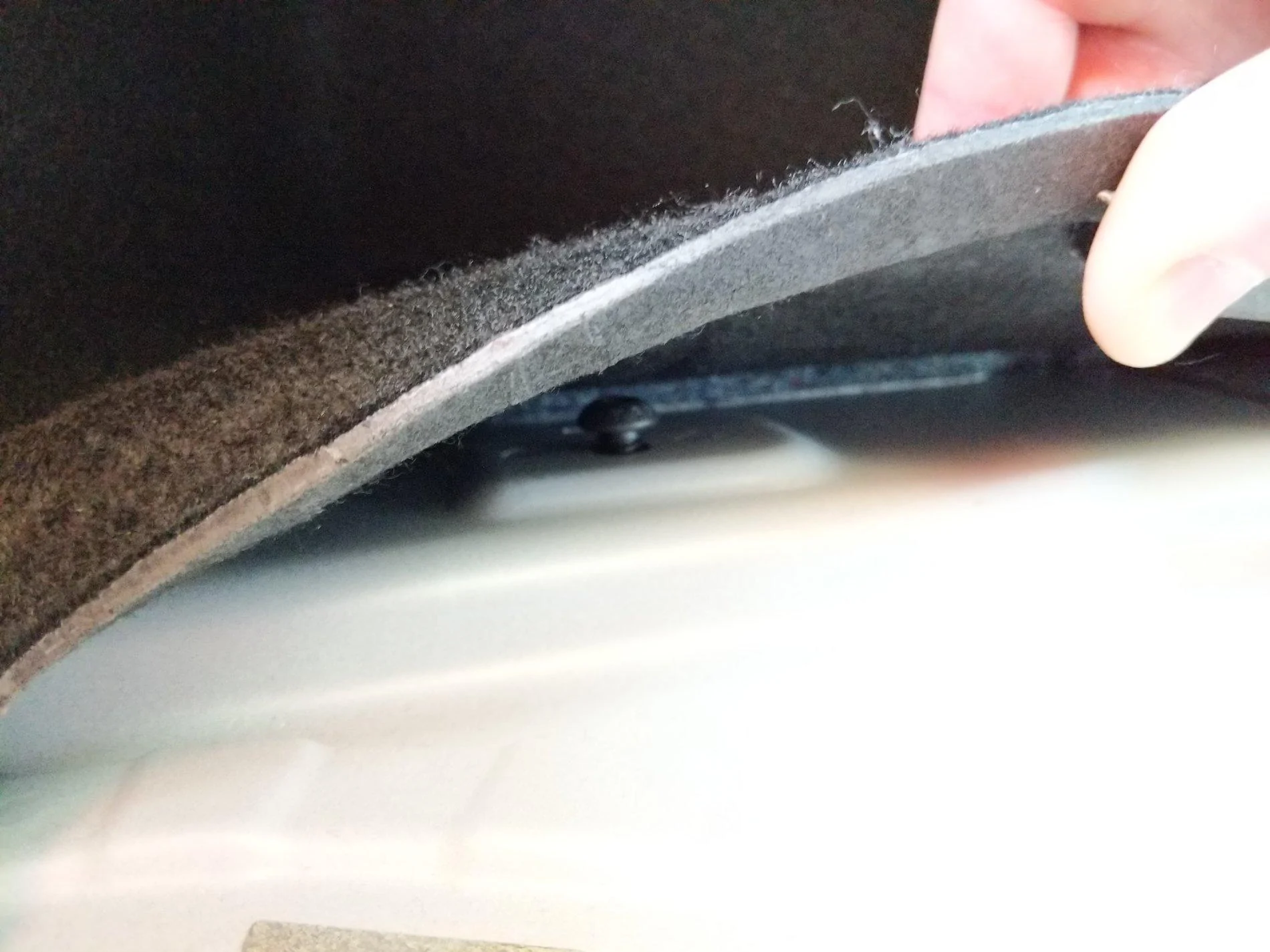

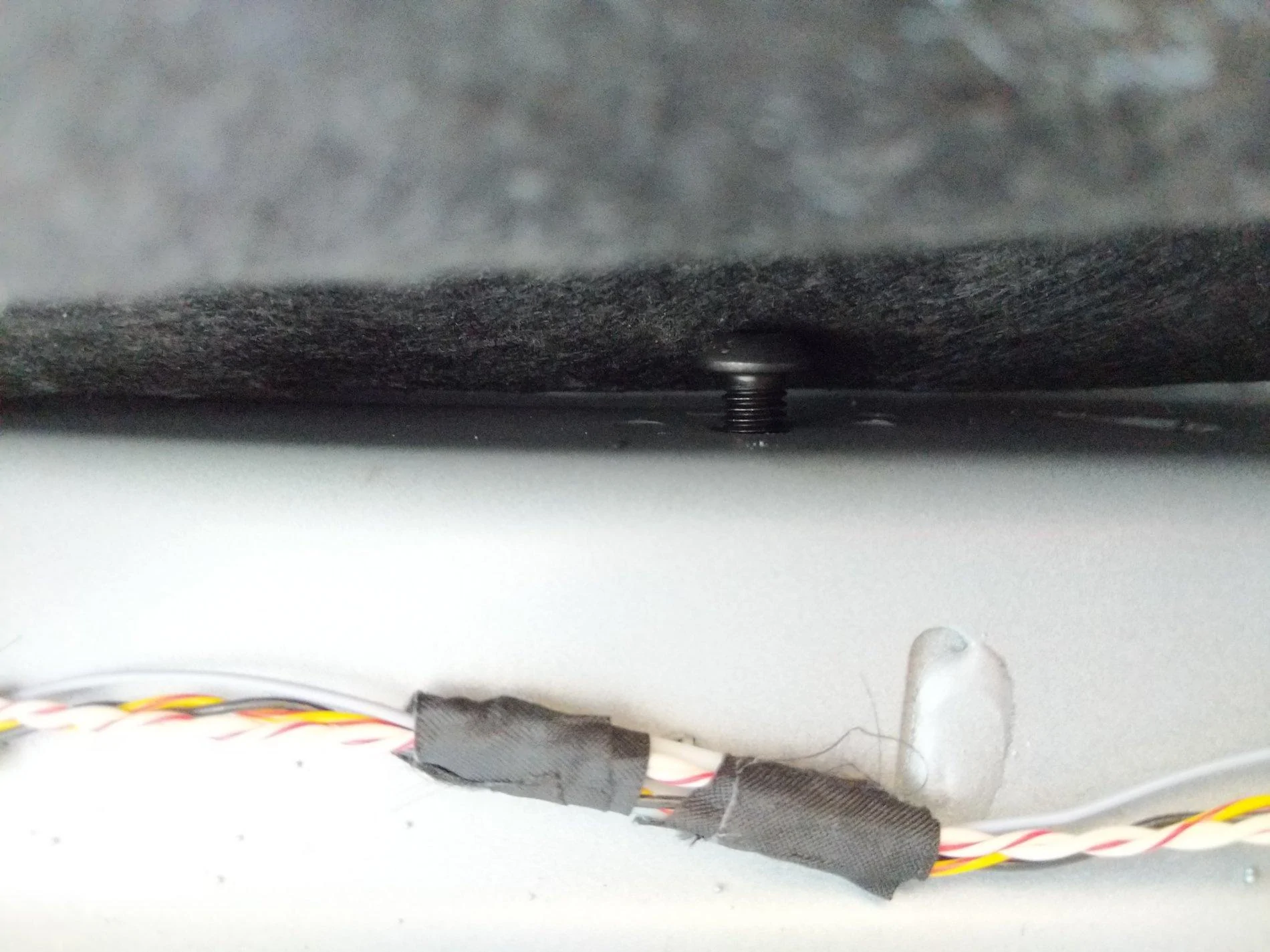

> Pry Up Edge Of Carpet To Reveal Bolt Locations On Four Corners
> While Holding Carpet Up, Thread All 4 Bolts Into The Locations
> Do Not Thread The Bolt All The Way Down Flush
> Leave Approx ½ Inch Sticking Up
> You Will Use This As A Marker For Where To Cut Carpet

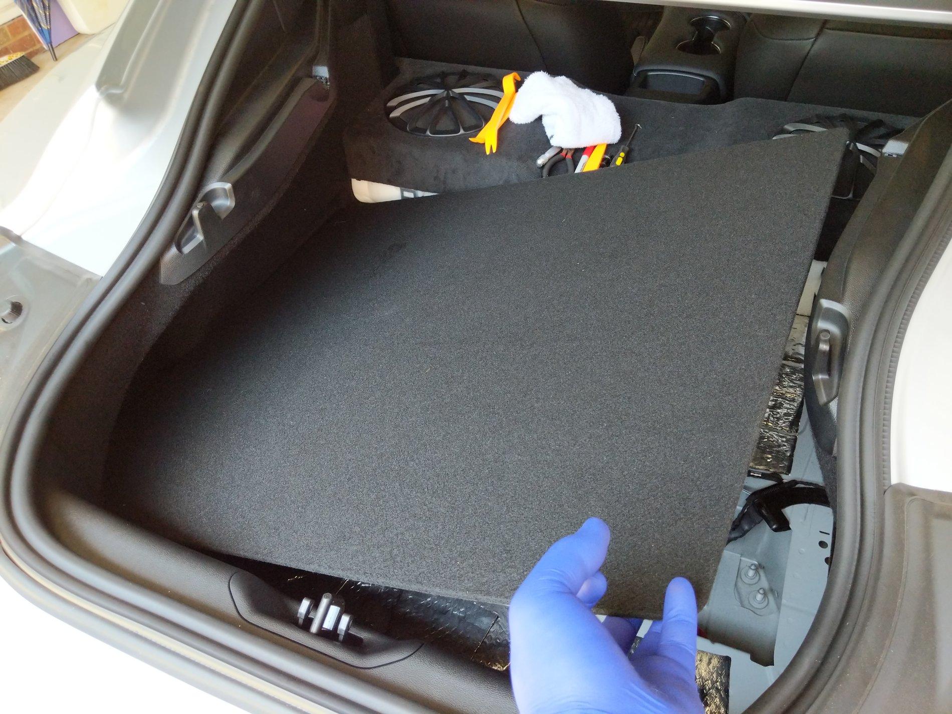

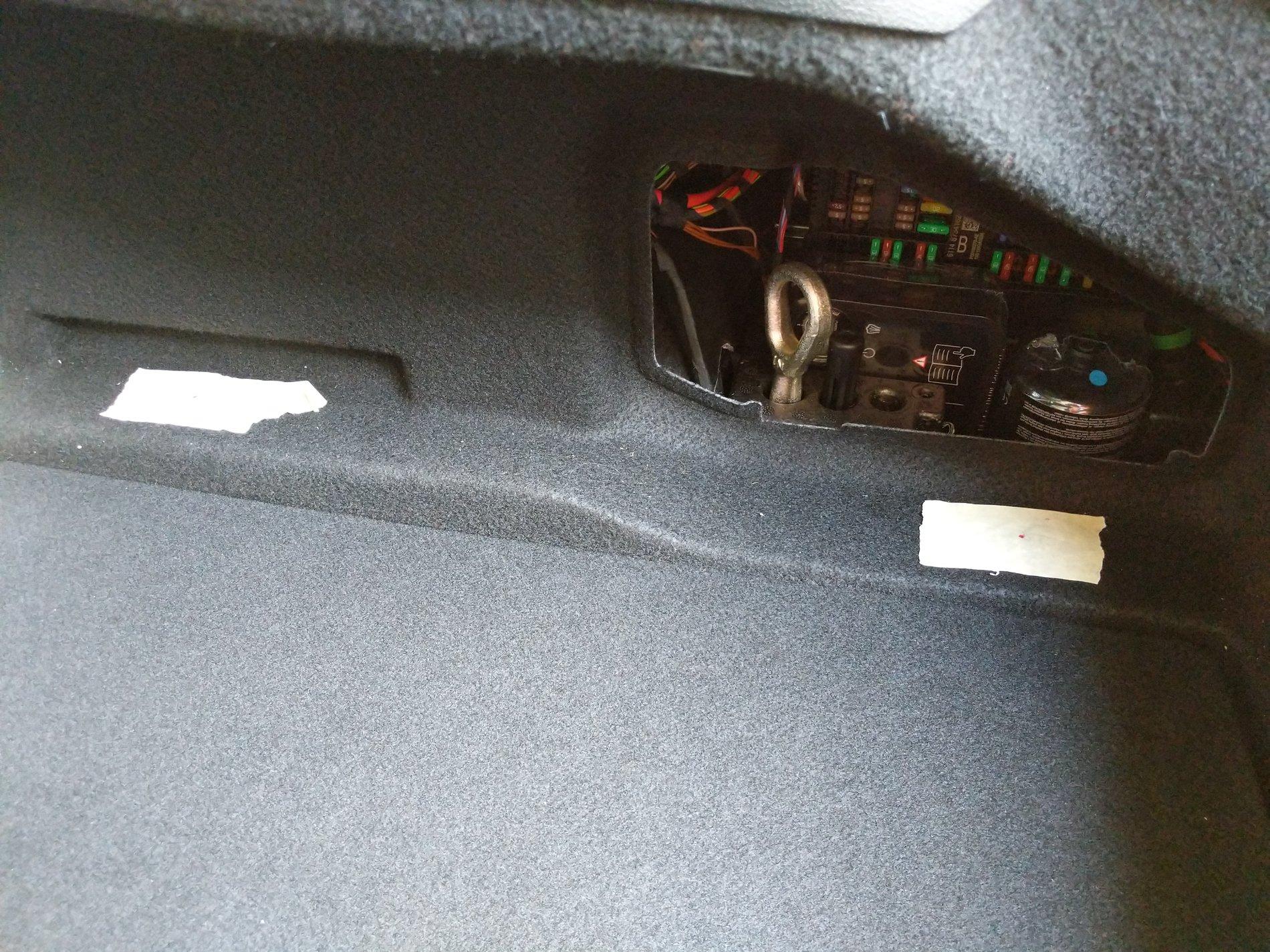

> Reinstall Rear Deck Lid Covering Battery Into Trunk Of Car
> This Will Help The Carpet Get Aligned

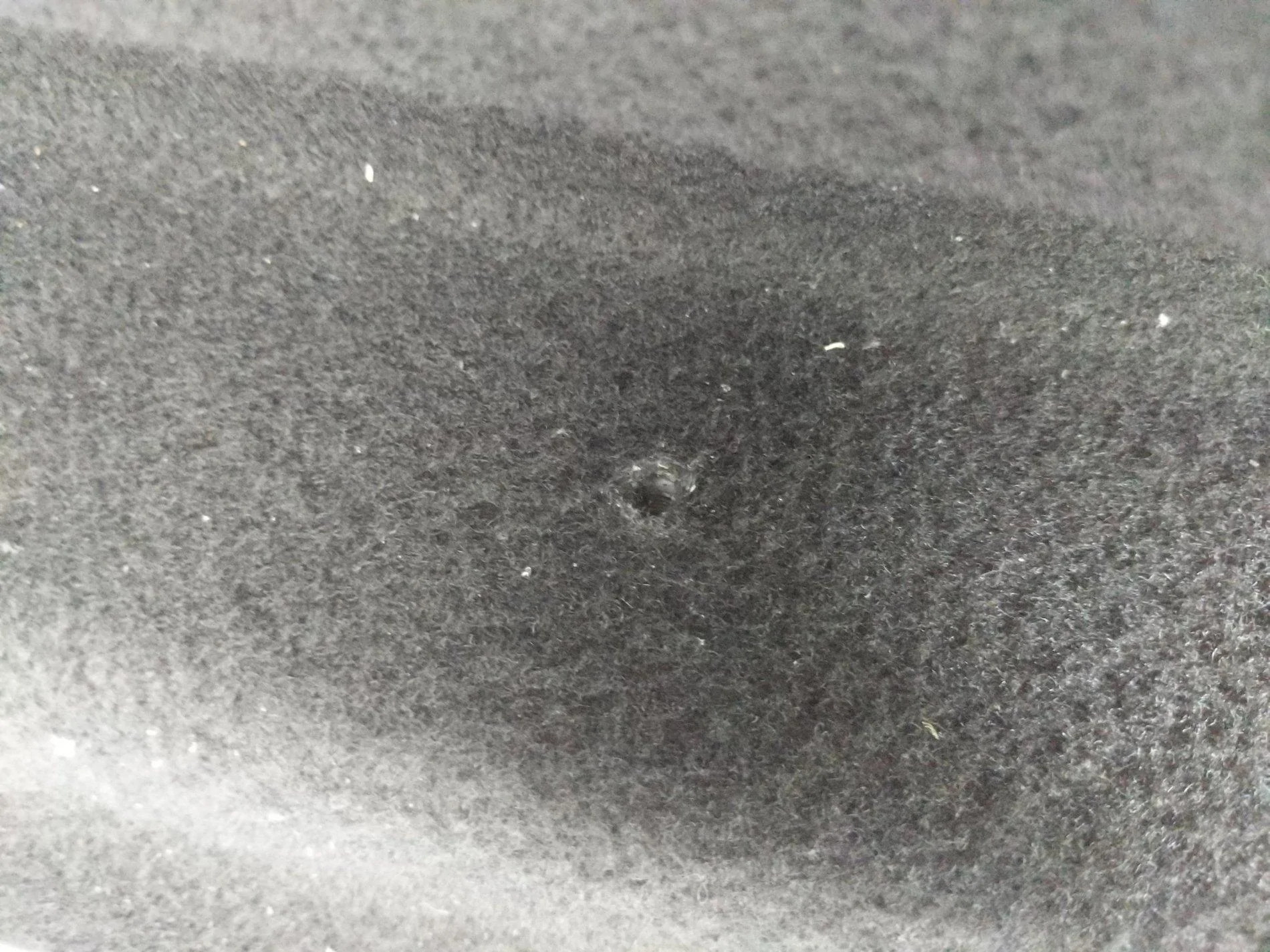

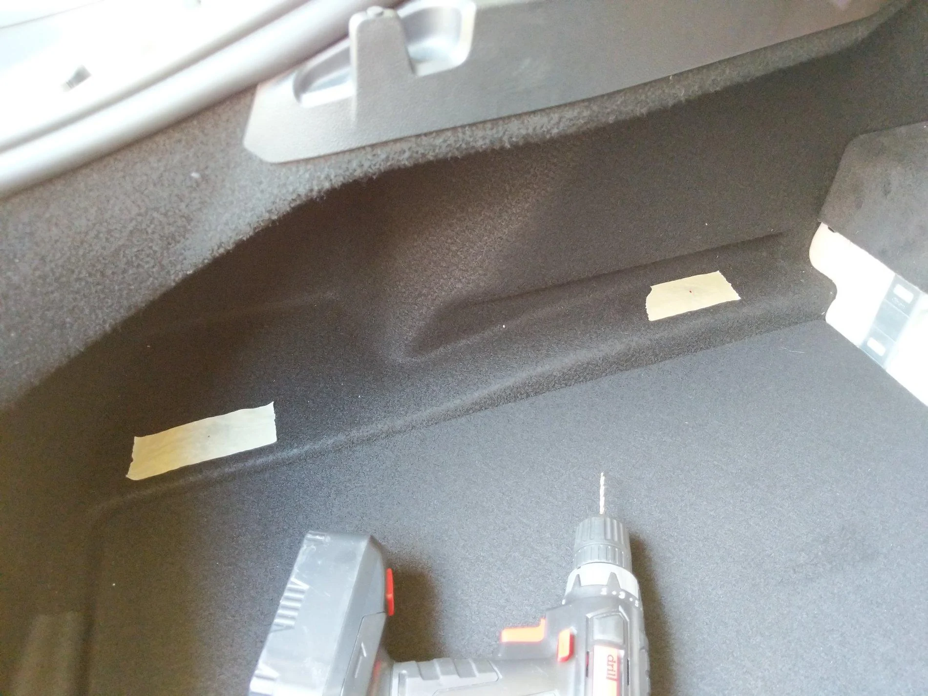

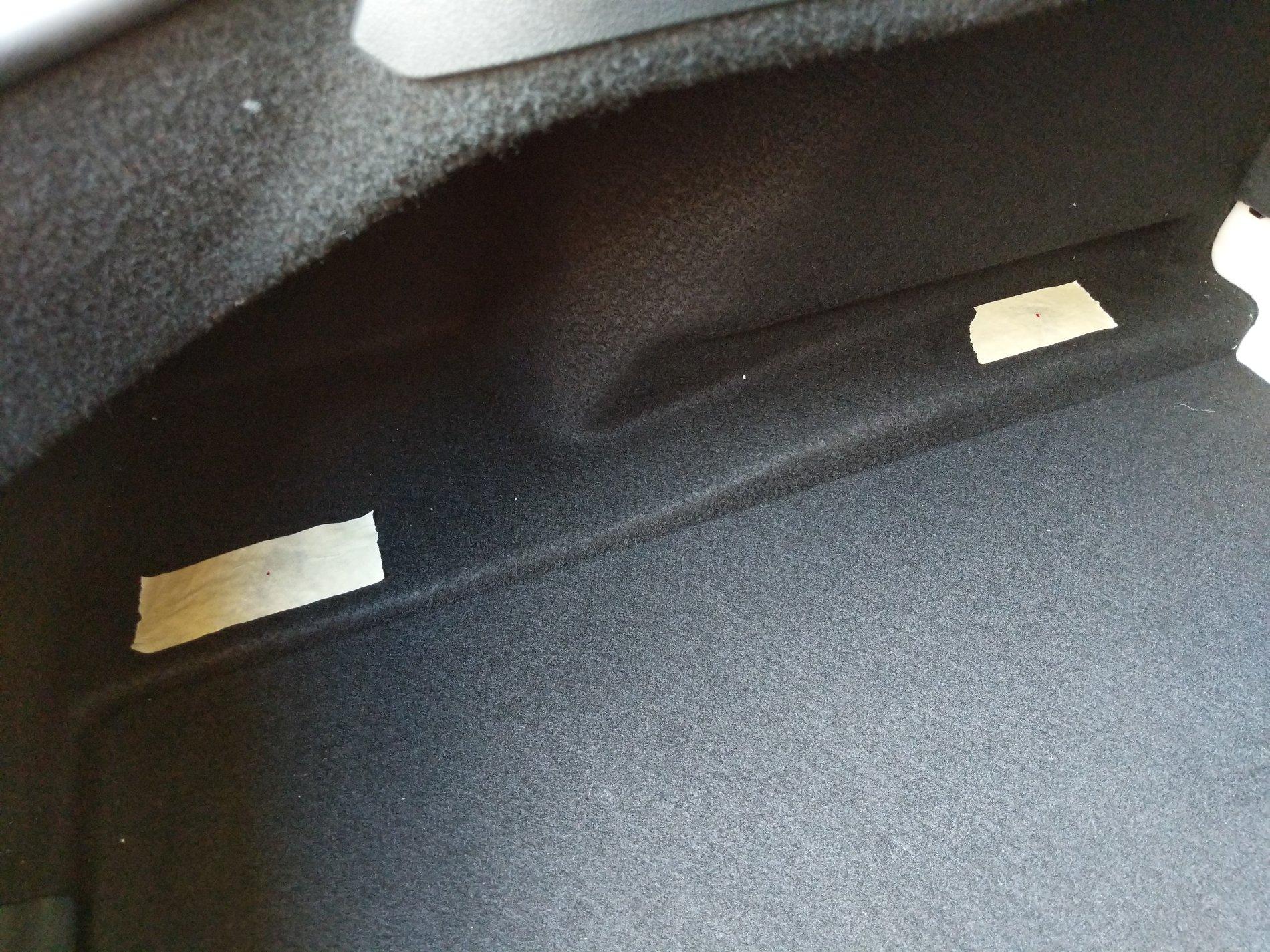

> Take A Piece Of Painters Tape Or Masking Tape And Place On Top Of Carpet
> Using A Marker Feel Around And Mark The Exact Location Of Bolt Underneath The Carpet
> This Will Be Your Guide For Your Pilot Hole To Cut The Carpet

> Remove The Rear Deck Lid Covering Battery

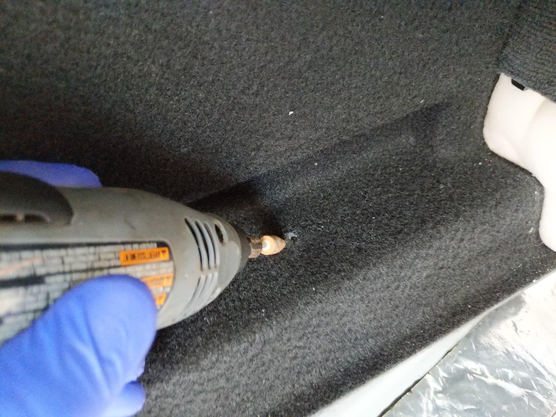

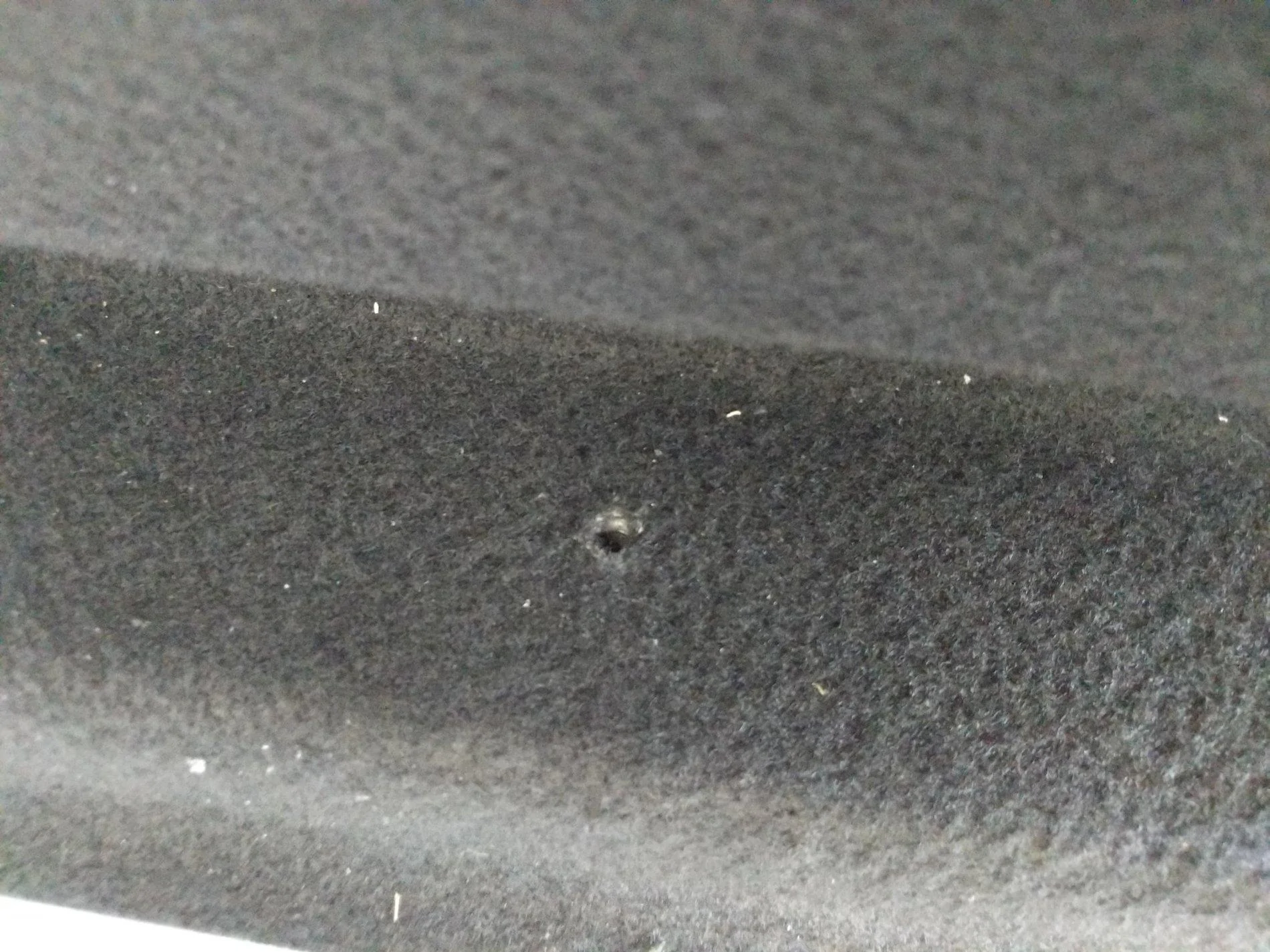

> Using The Marker Spot As Your Guide You Will Need To Cut A Hole In The Carpet For The Bolt To Go Through
Caution: To Not Cut The Hole Bigger Than Needed For The Bolt To Go Through. Also Be Sure To Not Cut Any Wires Or Into The Metal Of The Car
Tip: You Can Use Razor Blade, Cordless Drill, Or Dremel To Help Cut The Carpet
* * * Important Tip: Hold The Carpet In The Air While Cutting, Drilling, Dremel To Avoid Cutting Metal In Car, Wires, & Bolt Threads * * *

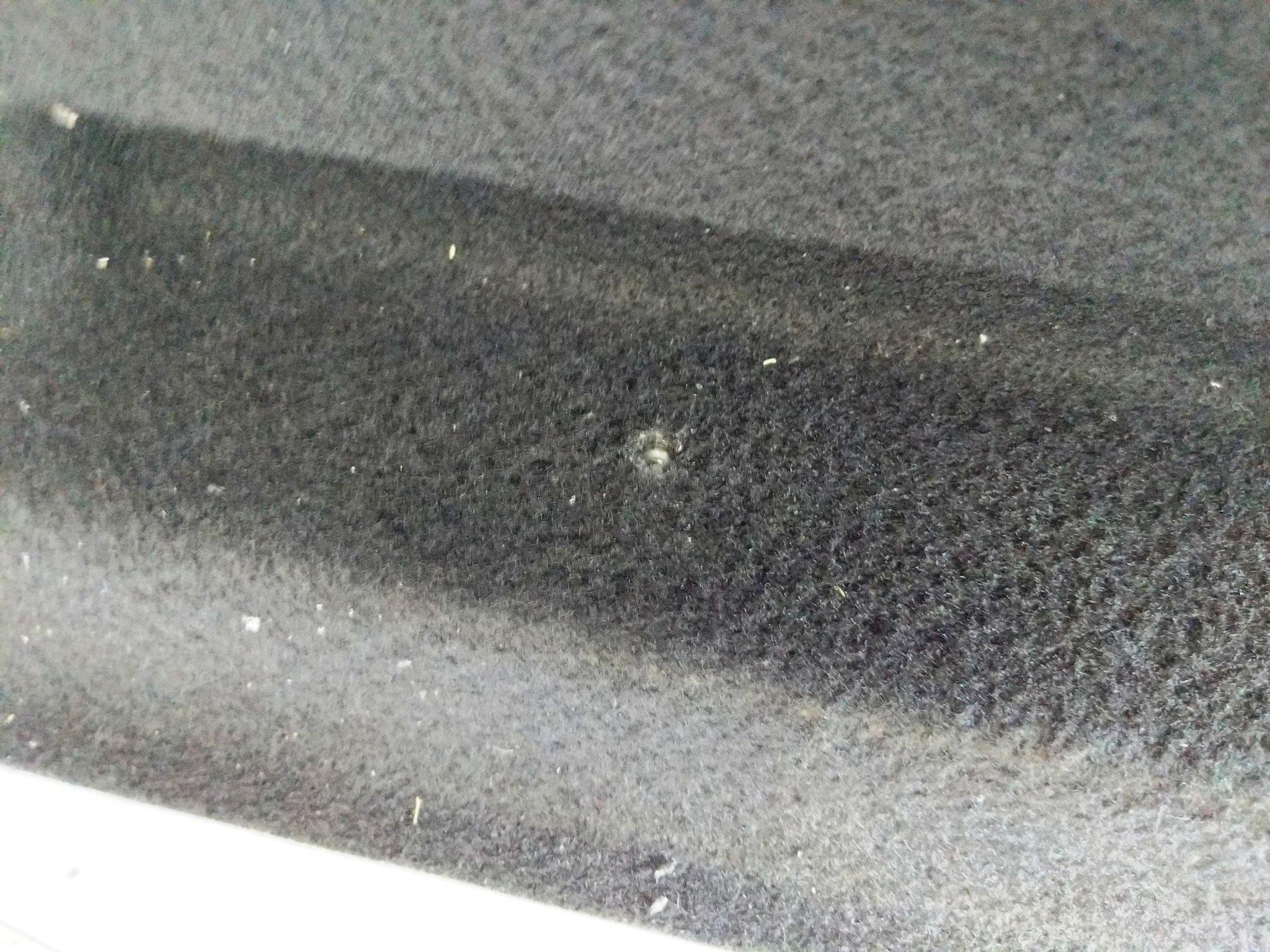

> Carpet Holes Should Now Line Up With Bolt Housing. You Should Be Able To See Threads.

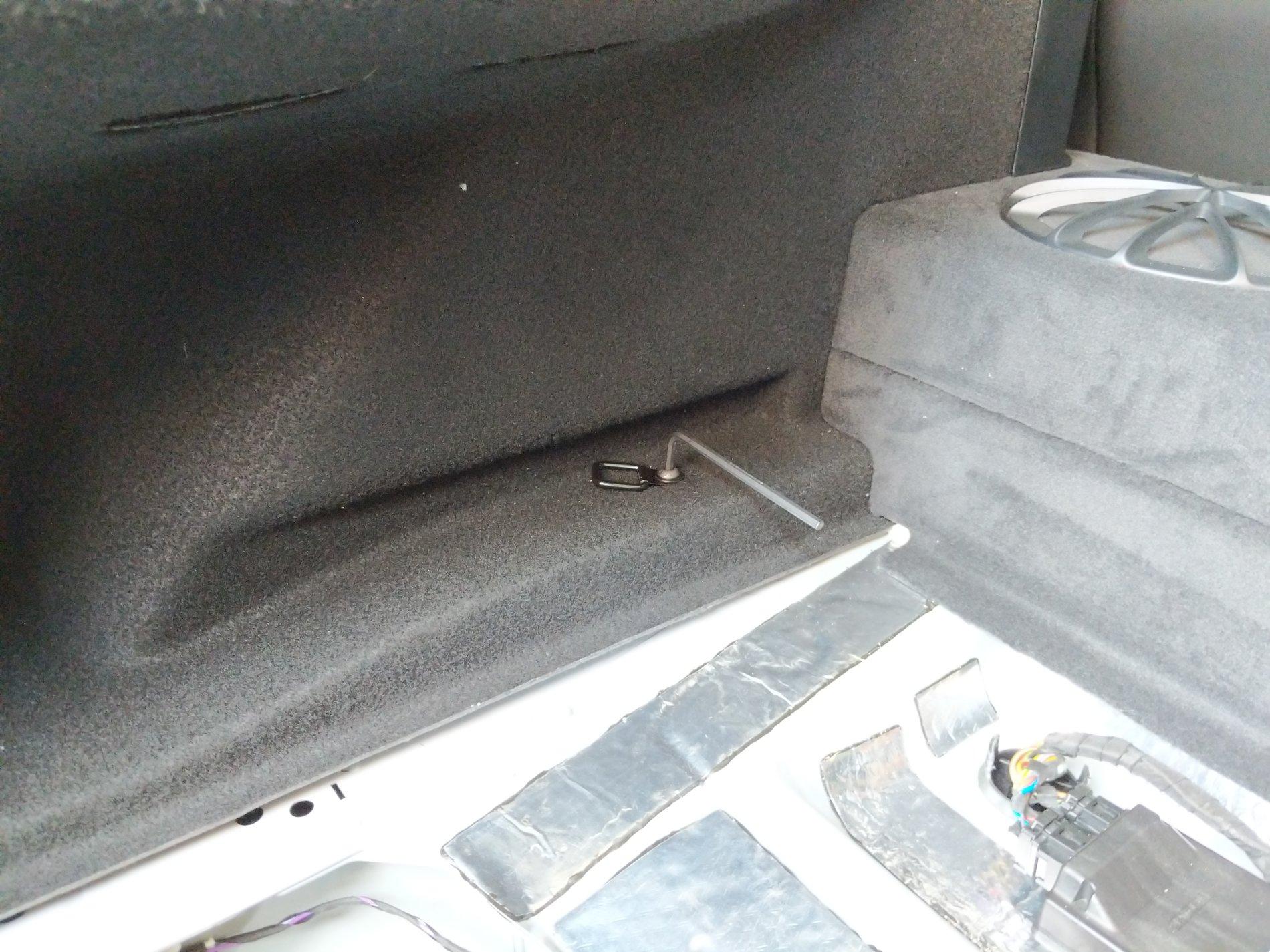

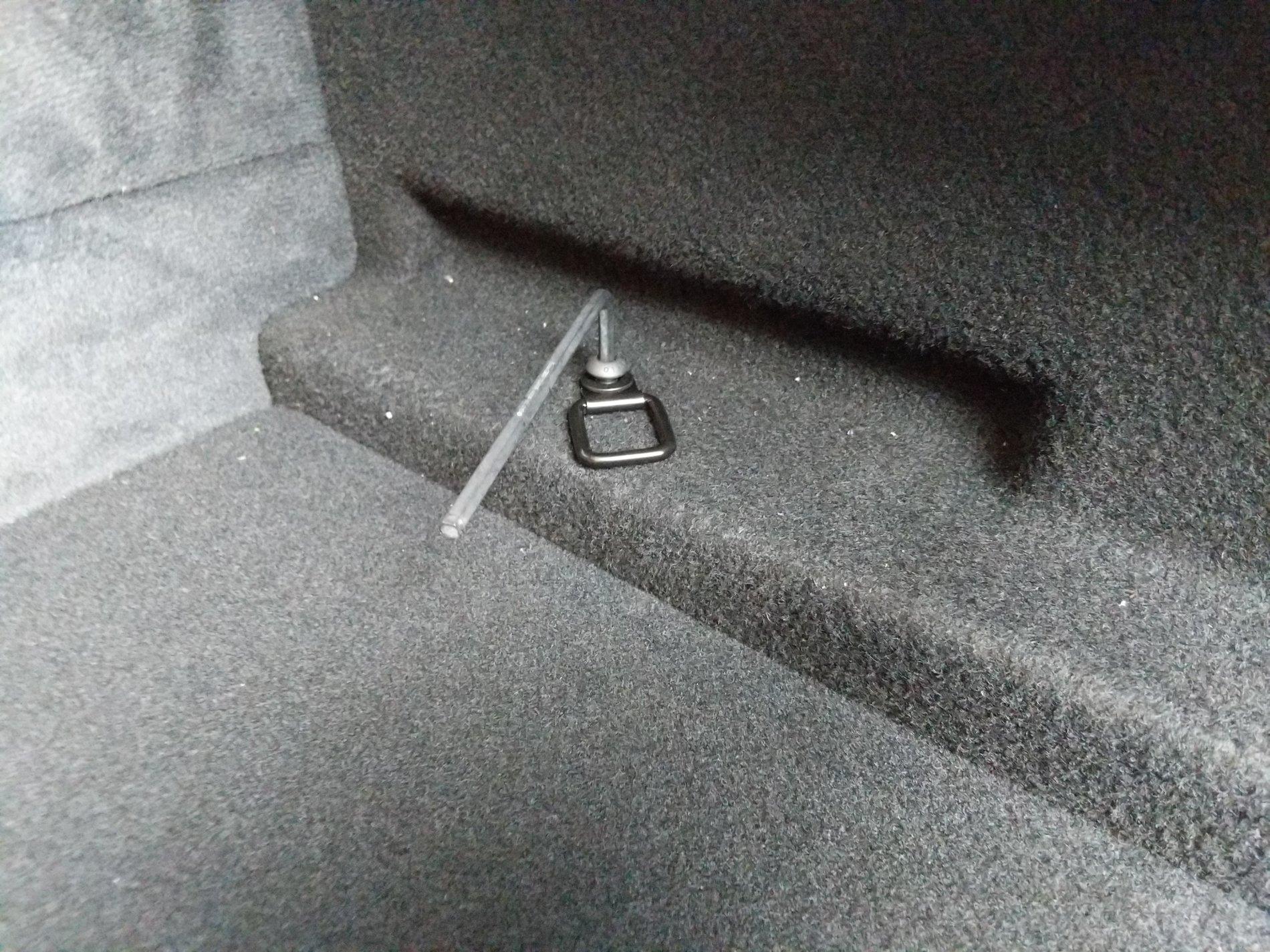

> Using Allen Wrench, Install (1) Bolt, (1) Washer, And (1) Lashing Eye On All Four Corners
> Tip Tighten Lashing Eye If You Want To Lock In Place. You Can Also Leave Semi-Loose If You Want It To Swivel.

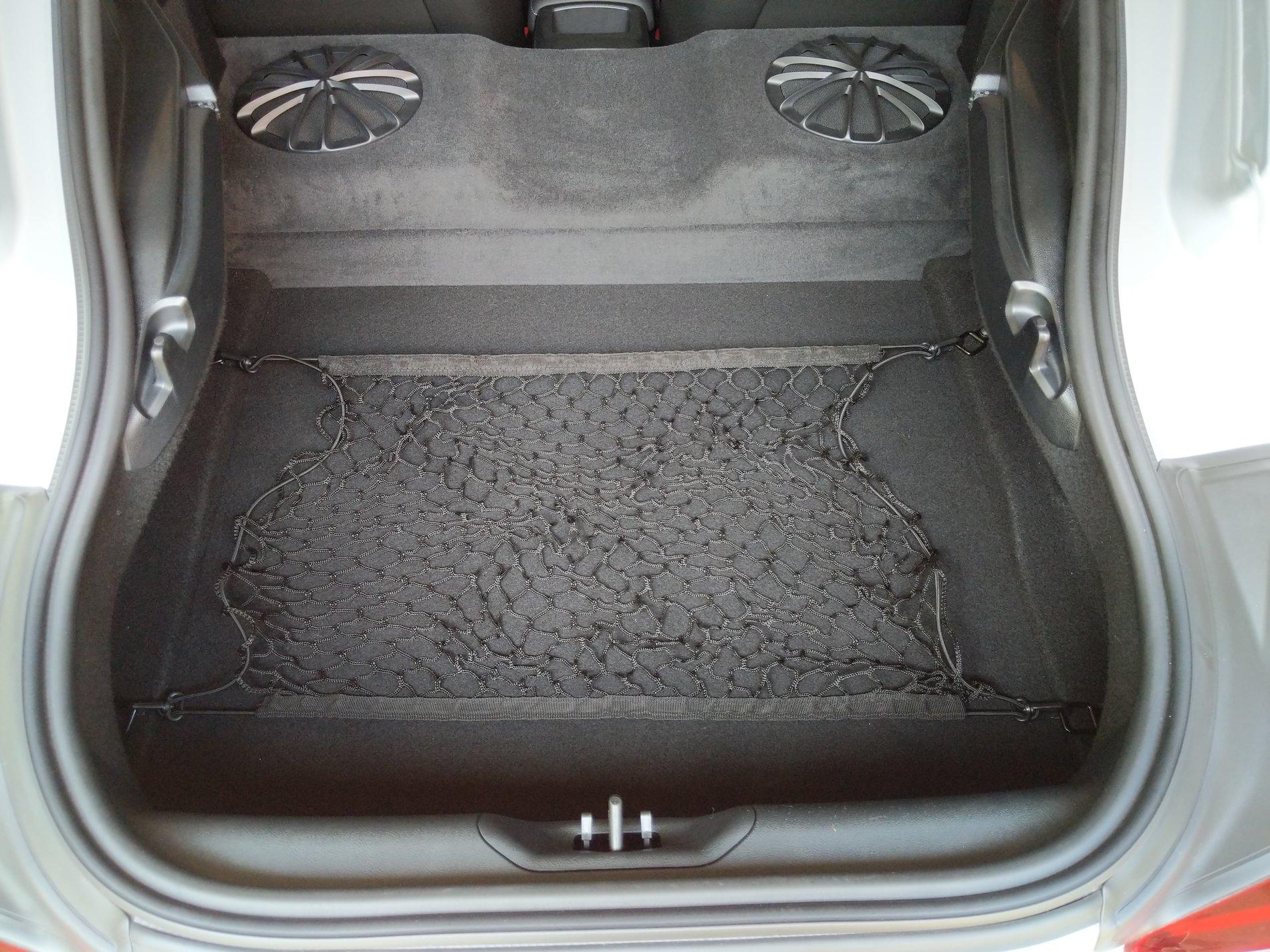

> Reinstall Subwoofer Rear Decking
> Install Net And Adjust As Needed
> Tip: You Can Pull The Outer Edge Elastic Strap And Tie Off If You Want To Tighten The Net Down
> Install Bungee Cords As Needed
> Install XL Soft Loop On Bag Hanger Hooks
> Install Flipped Soft Loop As Needed
