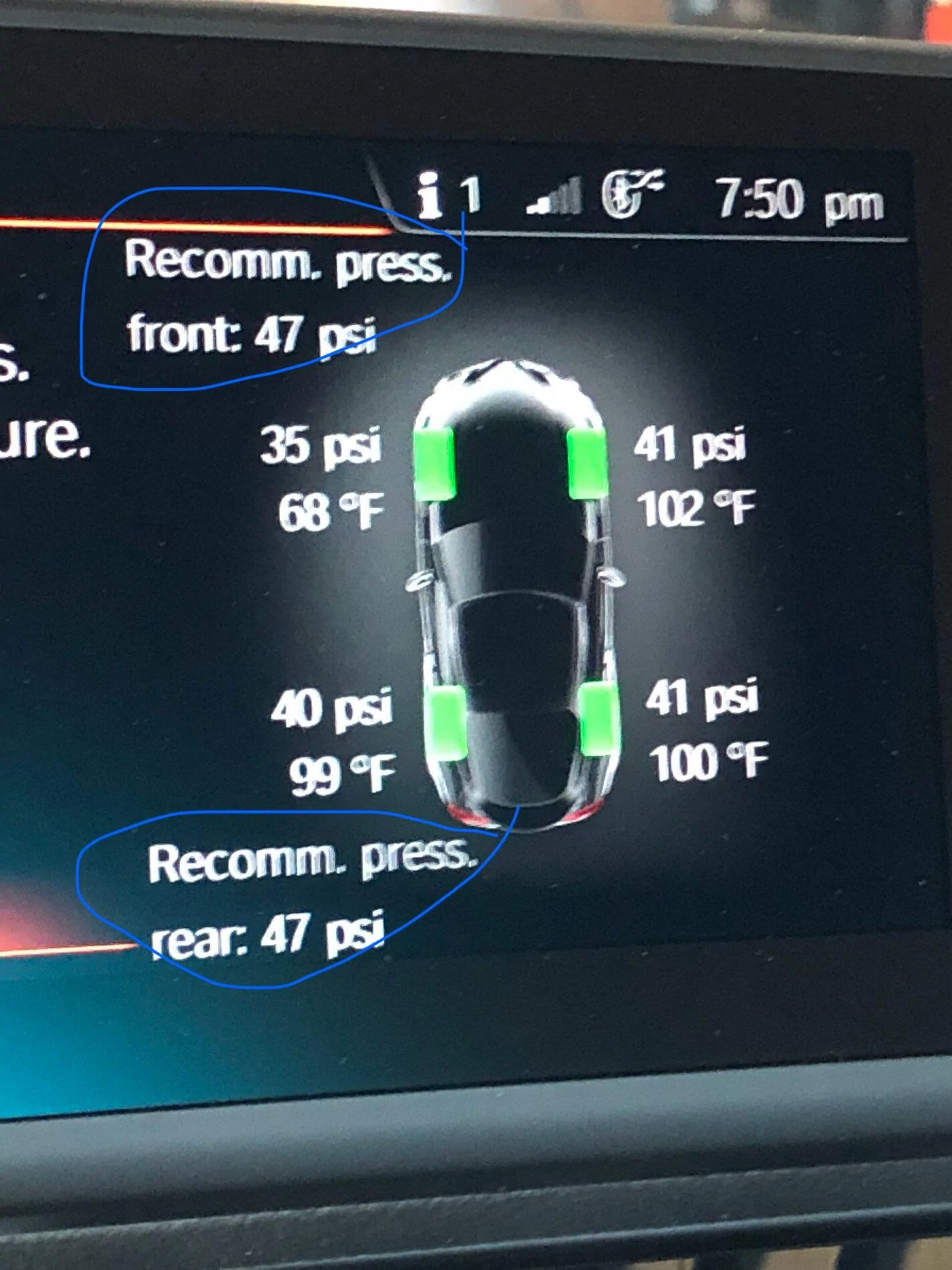

(I have a ā€˜20 3.0 premium) Sorry for being stupid, but where does the system show a recommended pressure? The screen I see under My Vehicle and Vehicle Status just tells me what the pressure and internal temp of each tire is.
TIA!
TIA!
Same screen, top and bottom (above and below the car outline).

Doesnā€™t exist on my screen.
I wonder if itā€™s because the prior owner put on wheels/tires and the sizes are listed as ā€œotherā€ in the setup screen.
(295/265 35-R19)
