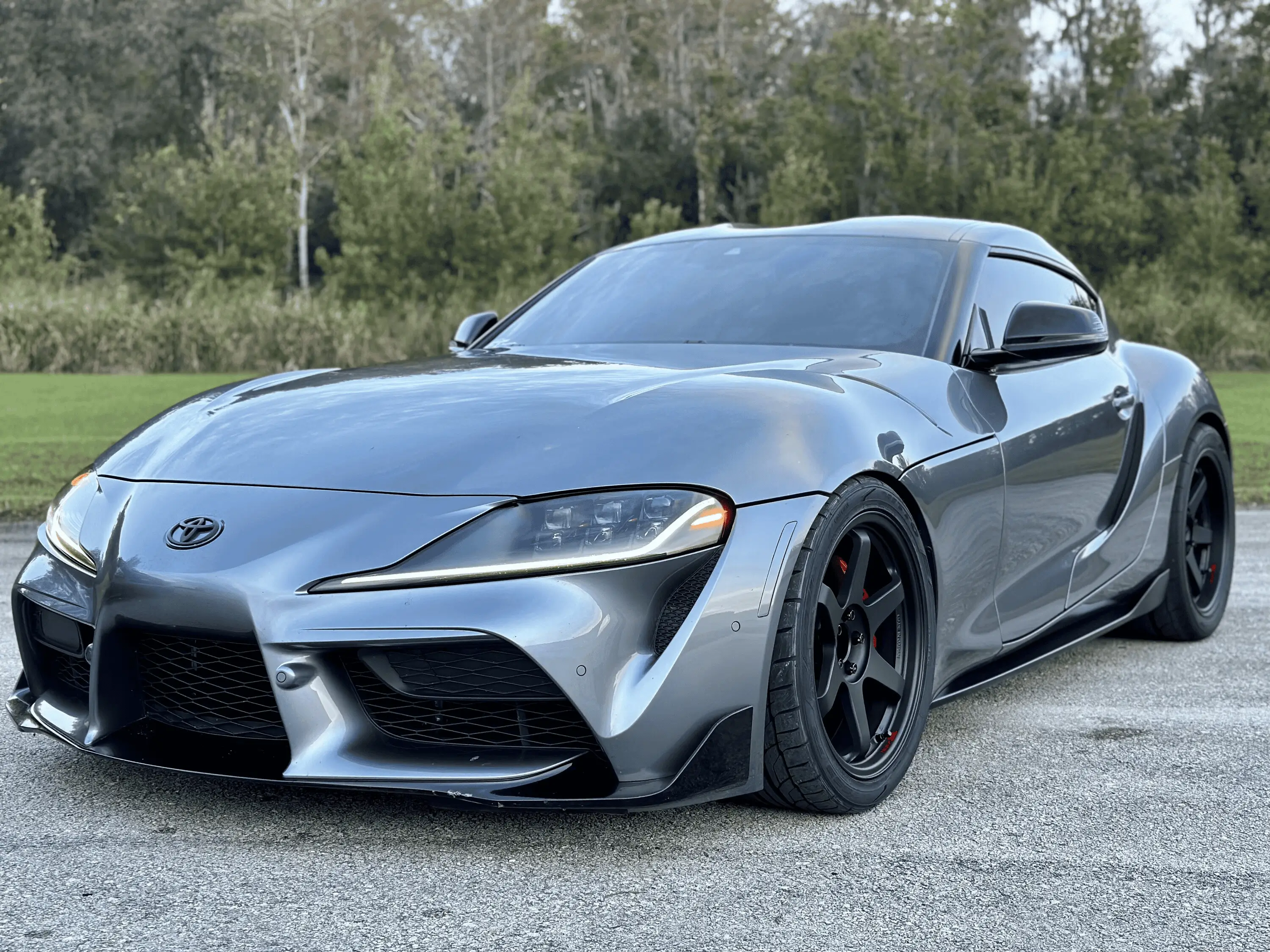

Nice! You coming to Sebring or Homestead anytime soon?
Love meeting all the local (Florida) Supra peeps 😍
Maybe but probably not, at least not with my Supra. I've gone with a buddy in his 911. I'm more of a drag guy, that's just my street setup in the picture. But always down to meet other Supra folk.
