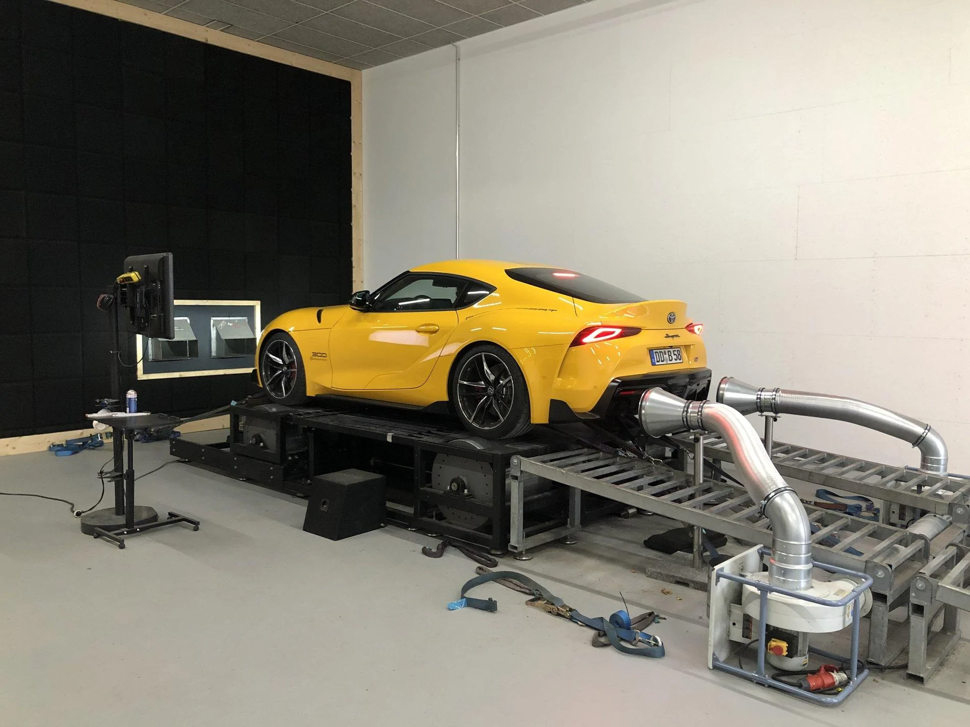

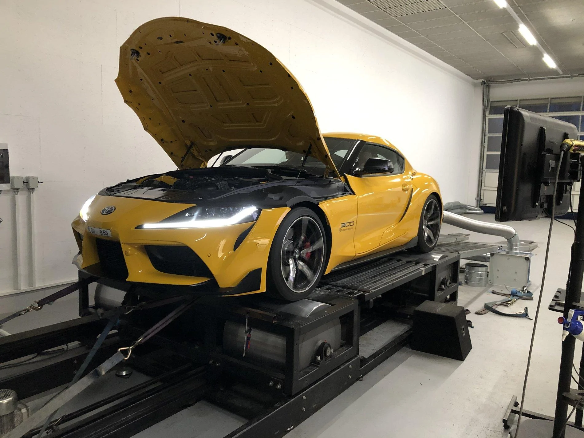

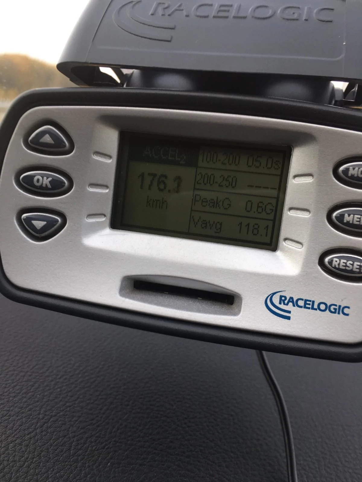

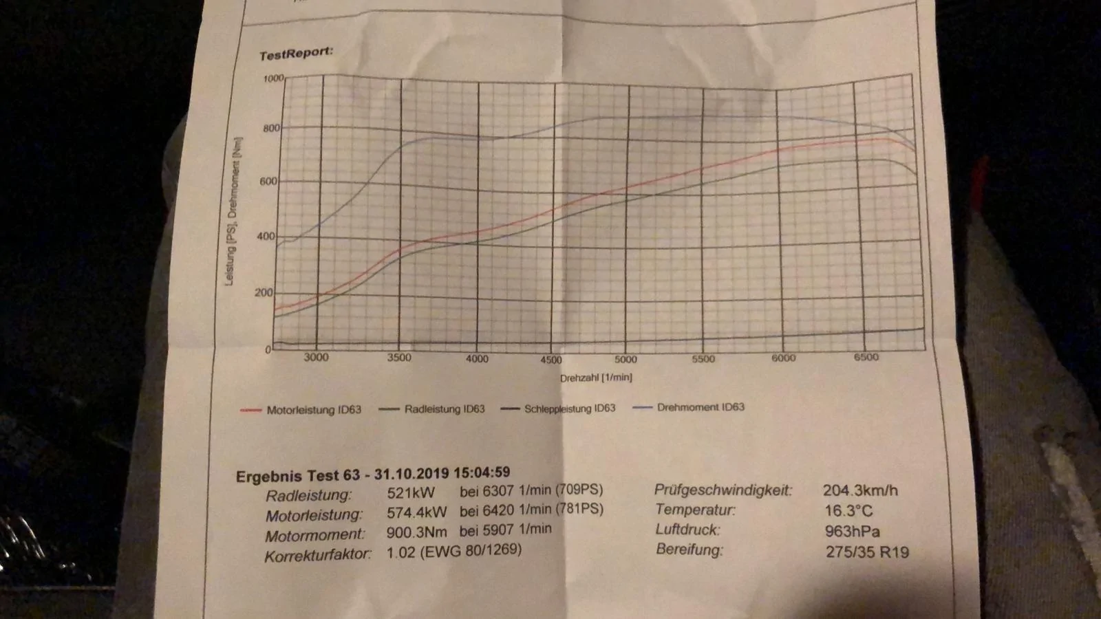

    New Toyota Supra A90 world record set by @dreihundertdresden , @pureboost.de & @mhd.tuning
    _____________________
    781HP / 900NM
    100-200kph in 5.0s (with slipping trans)
    This is now the worlds strongest and quickest Supra A90. We could have turned her up even more but the transmission startet slipping, a TCU tune is now needed (@xhpflashtool your turn!)
    MHD custom tune by PureBoost

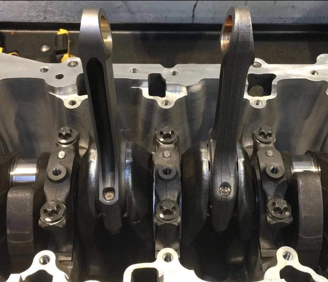

    Built engine & head work
    300 Dreihundert Turbo Kit Borgwarner EFR 8474
    Port Meth Injection
    Aral 102 pump gas
    #no piggyback or external boost controller

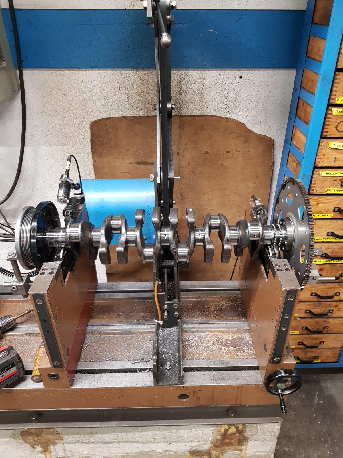

    Fantastic. Was there much involved with the head work?

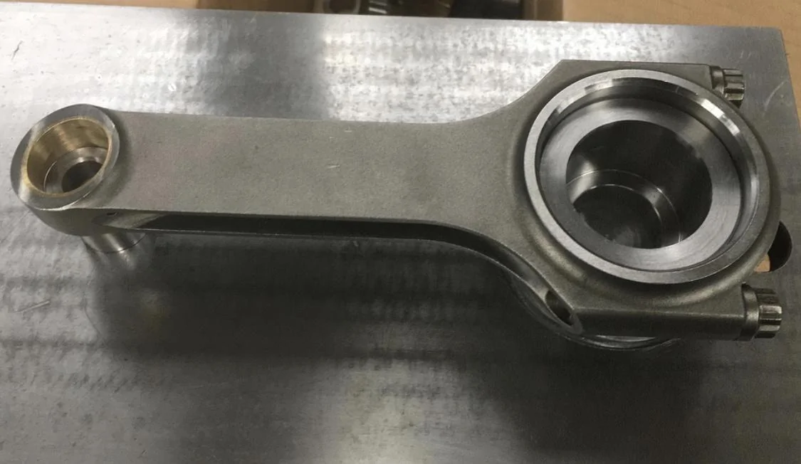

    Is this on stock internals?

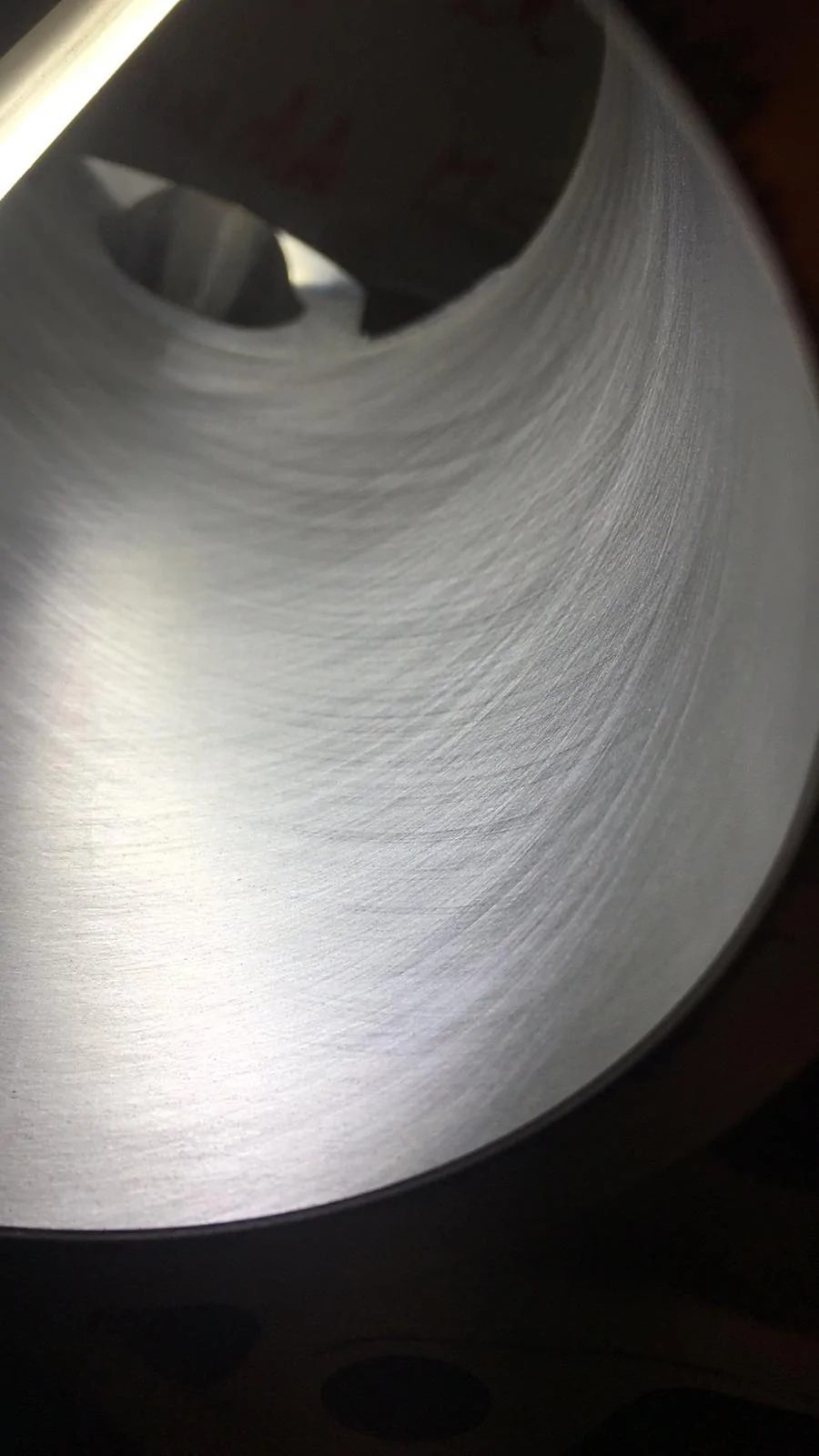

  8. OP
    Dreihundert
    Dreihundert Member
    First Name:
    Andy
    Car(s):
    Supra A90
    Joined:
    Oct 17, 2019
    Location:
    Germany
    Posts:
    Liked:
    40

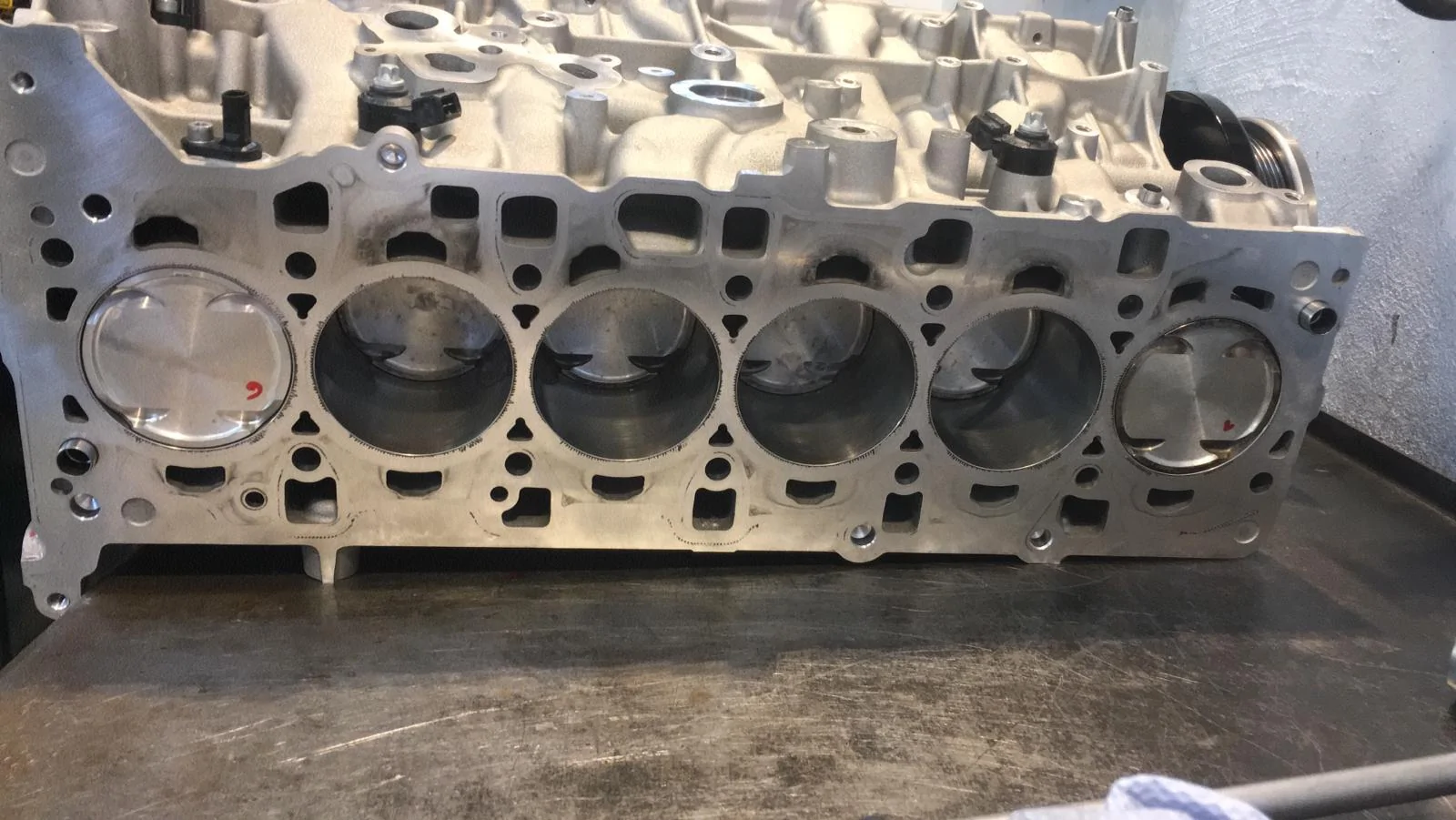

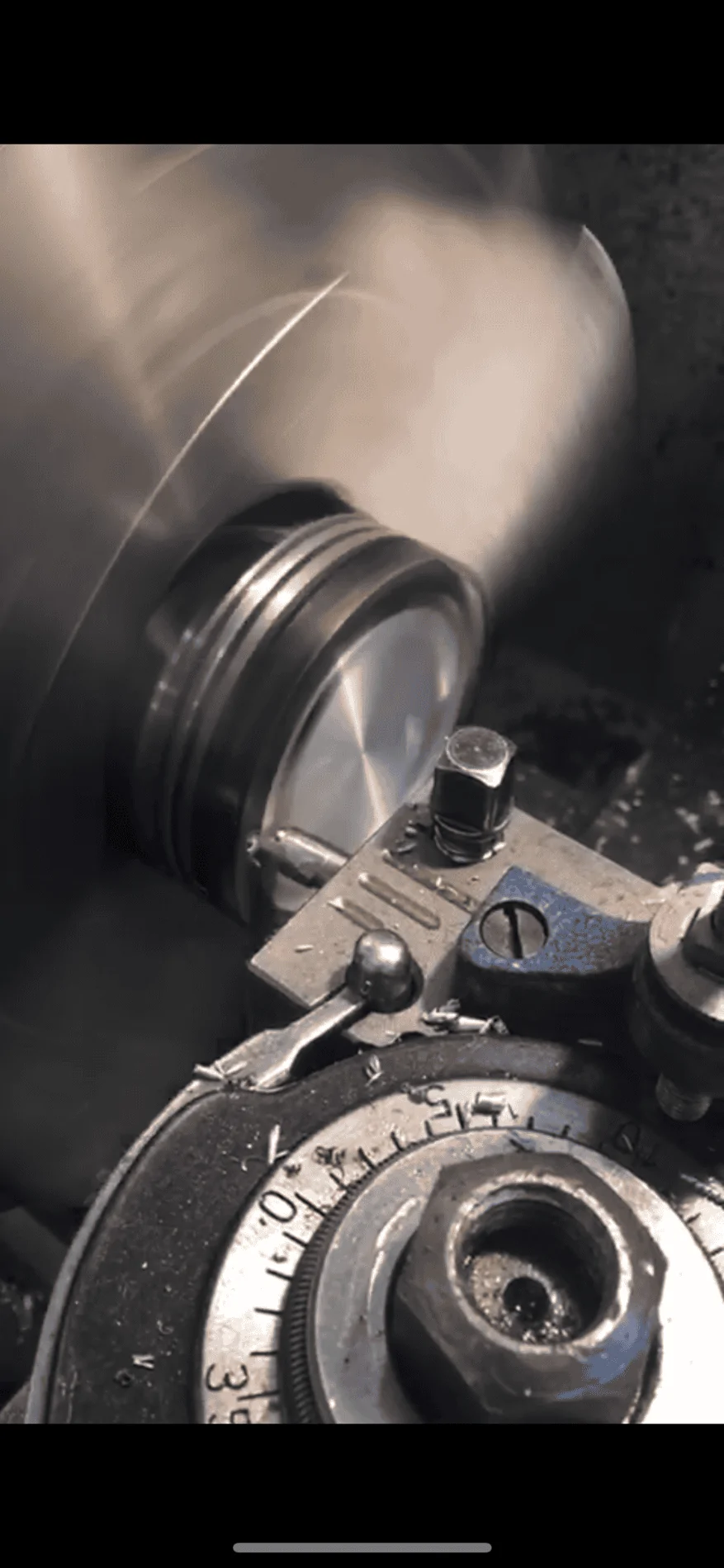

    -Upgrade connecting rods.
    -reworked Pistons, crankshaft and cylinder head
    image5.jpeg image2.png image4.jpeg image3 (3).jpeg image1 (5).jpeg image0 (7).jpeg
