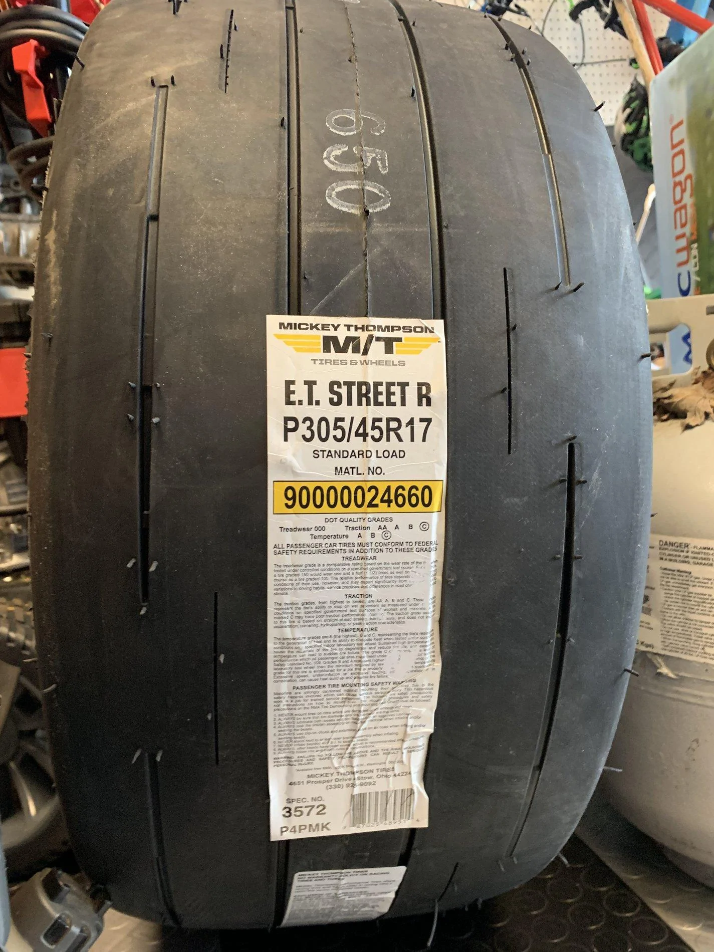

Hey guys/gals I have a quick q regarding my drag wheel/tire setup.
I have the Titan Motegi 17” wheels and Mickey thompson 305/45/17 ET Street R’s.
My question is whether there will be any deleterious performance issues if no Oem TPMS sensor is used with the drag setup.
Should I get 2 new oem sensors and run those? Or will the car be fine without them?

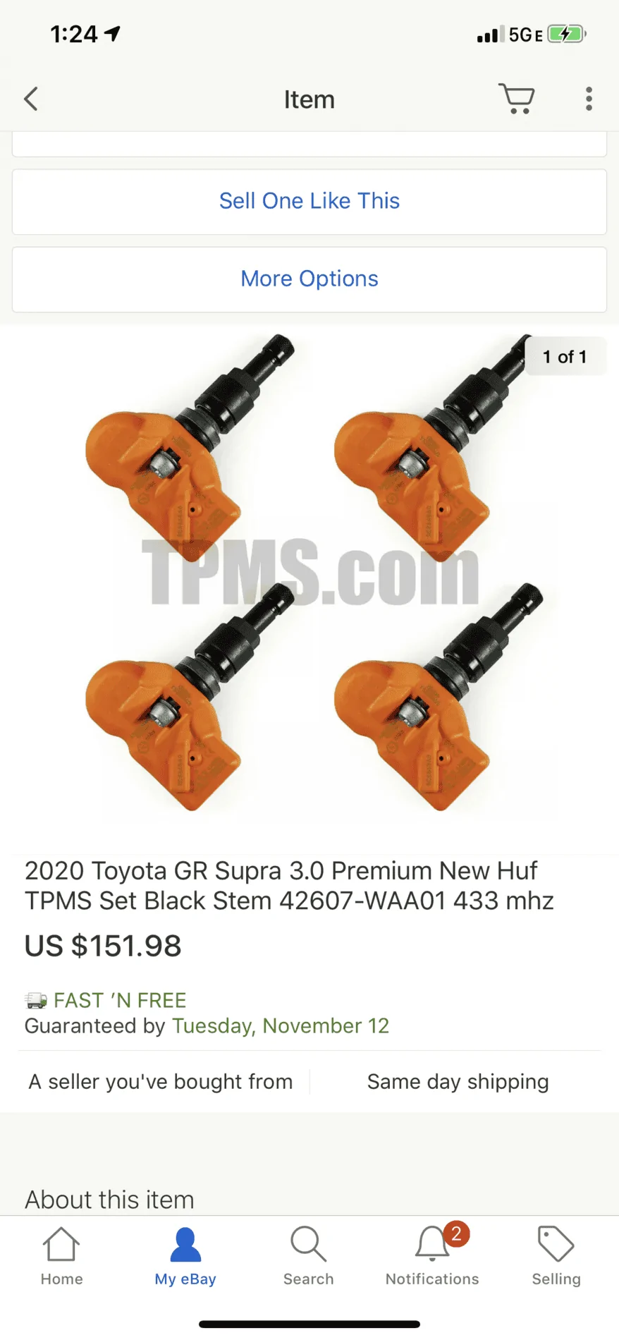

Thank you! I found the oem Toyota ones on eBay - about 160 bucks for 4.
So since I will be adding two new TPMS sensors with the drag wheels I will need to re-calibrate the tire pressure settings each time I switch between the drag wheel and the OEM wheel, correct?

I haven’t received them yet but should be here today!
These are the ones I got:

Tires are being mounted with tpms right now - hopefully we will know whats up soon!
