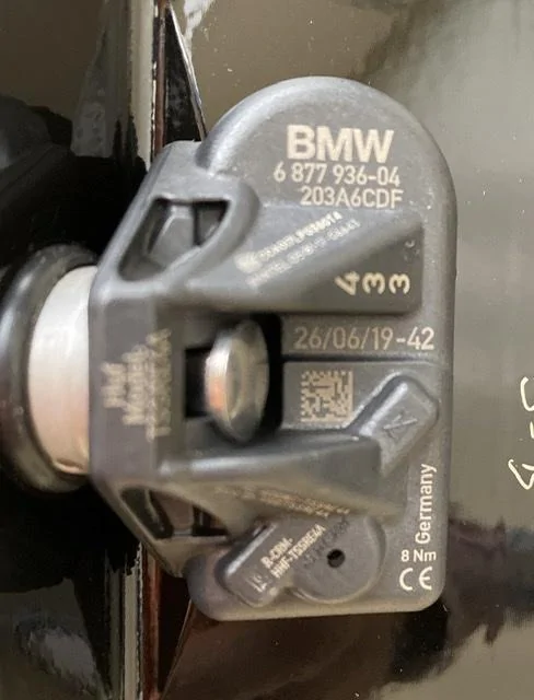

So, ran over the smallest nail in existence and had to get a patch plug this morning... figured i would snap a pic of the TPMS sensor since a lot of people have been asking about it... here is the pic and i will link below a Wurth cross reference manual with OEM part numbers as well... P/N on the TPMS sensor is 6877936-04 so that crosses to Toyota OEM P/N 42607WAA02 which is a 433mhz sensor, not a 315mhz like everyone has been saying... So a little clarity on TPMS sensors for everyone

Toyota has spec'd two different sensors for the Supra, the first was 42607WAA01 which is 315MHz. Second is 42607WAA02 which is 433MHz. Both are still "live" in the parts system and tagged for the Supra. I don't know the difference or when/why there was a change, but I suspect both are generics and not a repackaged BMW part like you get on the car from the factory.
If the Supra is like recent BMW models, it would be able to handle either frequency and the cars may come with one frequency or another depending on the market or maybe even suppliers. So if anyone is getting a sensor in the aftermarket from a wheel vendor, expect variability in the specs.
