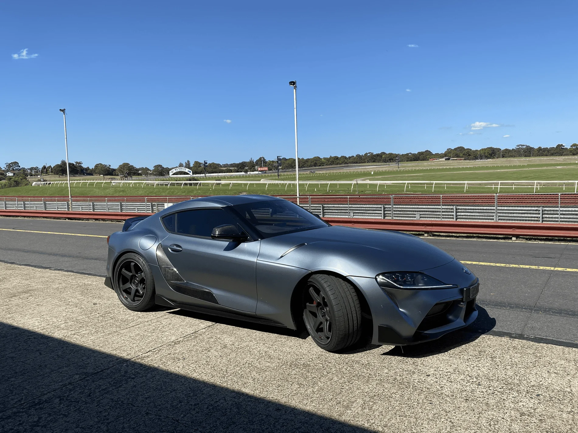

Had my first track day at Sandown Raceway (Australia) on the weekend and had a blast on a beautiful day (see photo). Best lap was 1:28.085 on this 3.1 km track with stock tyres, which I felt cemented the car as a good track car IMO, as I am an amateur...
