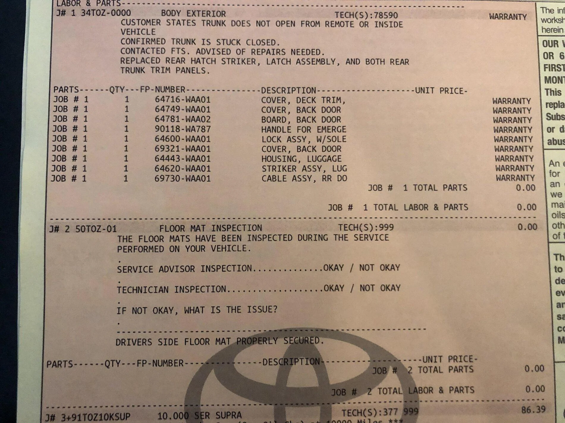

Hey guys, I closed my trunk after taking some stuff out and the latching didn't sound normal -- I tried to reopen it with both the release button on the door as well as the fob and the trunk is staying locked. No "trunk unlocked" warning shows up when I turn the car on. I can see that the emergency release handle is hanging off its usual spot when I look through the opening near the cupholders.
Any advice on how to get it open, short of taking it to a dealer or someone else?

No luck with the emergency pull. Dealer it is.

Update: Took the car in over the weekend -- the Supra tech told me the latch has no tension whatsoever and is very likely why it is stuck. They weren't able to solve it without Toyota engineering on the line, and have asked me to bring it back in on Thursday to try again.

Magic Toyota -- they have a Supra tech. I got an update this morning. The tech is flying out next week, and they've ordered some replacement parts for the trunk latch, so I'll be taking it back in on Tuesday. I'm bringing the car home for the weekend since it's way too nice not to have it for now.

Been a while, so I thought I'd update you. Parts took a while to come in, and a tech took training to fix the issue. They only got all the parts in yesterday and it took a day to fix. Parts are listed in the invoice.
