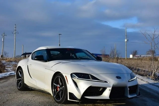

Hey just wanted to know if anyone has the same issue as me. The trunk open light came on in the summer and went away after a couple of days. But it came back on last week. I thought it could be because I added the Aimgain wing but I’ve had my wing for almost a month and the light just came on. If anyone has any advice please let me know. Thanks!!!
