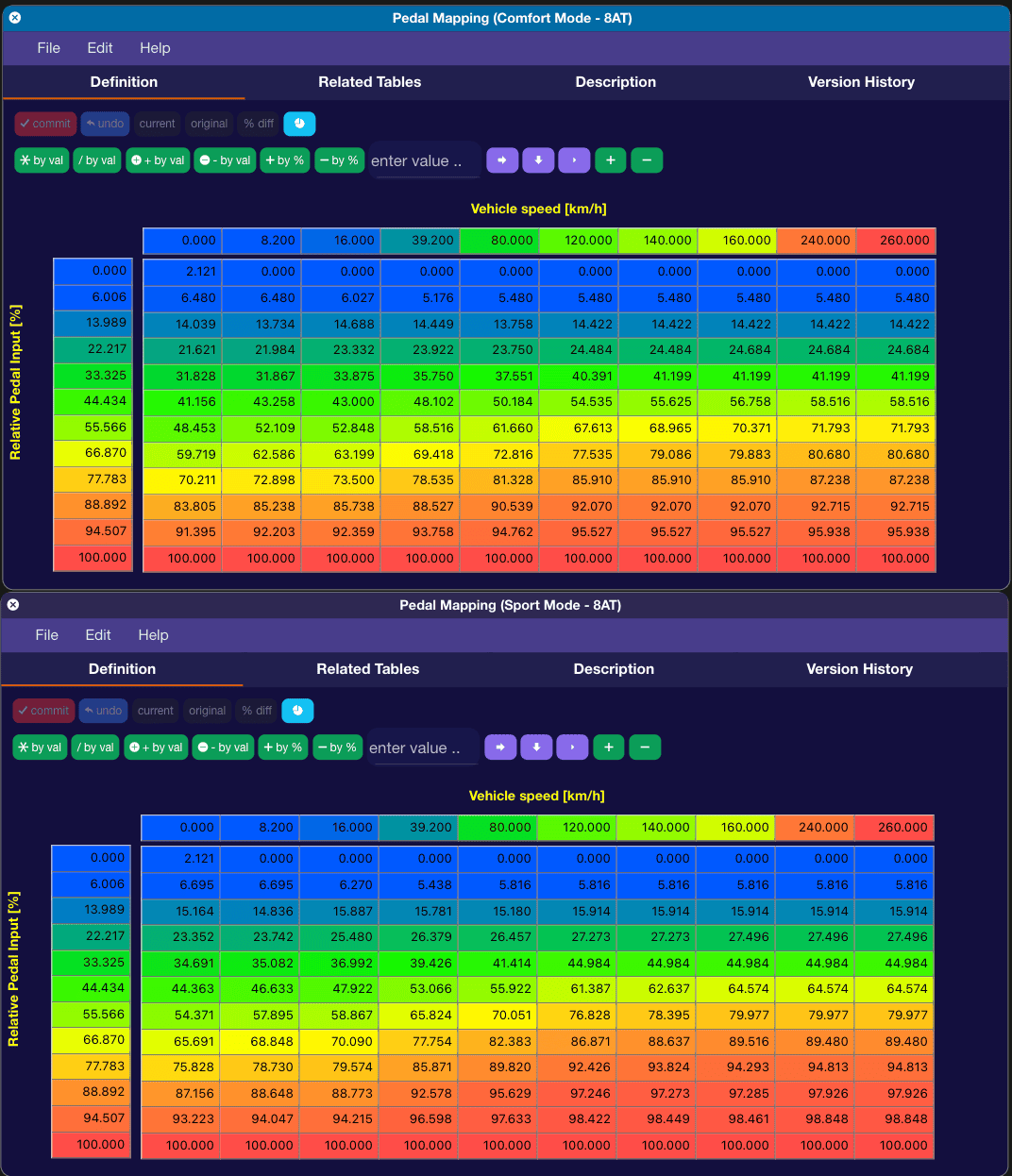

That is correct, and here are the differences in the throttle mapping:

That is awesome. Thank you!! I wonder how it would feel with true-linearity... especially in the MT cars
