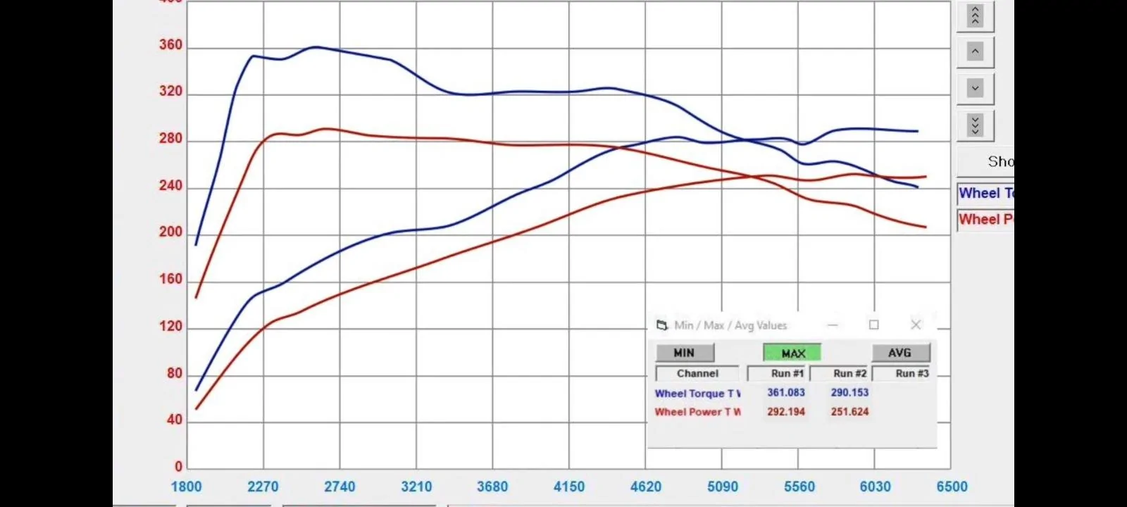

So recently I decided to look at another forum where a guy made 40whp/70wtq from a tune called Turbo Transformer on a 2020 330ix with the exact b48(255hp/290tq) as ours(330ix Dyno below). The price of it was spectacular and I liked how you can fine tune the base, slope and delta. I purchased it from a vendor on here and it arrived yesterday.
Wow!!!!! Is all I can say. The guy who made 40whp/70wtq, I decided to use his fine tuning but it yield a different result for my car.
He had 3.2 psi Delta, 0.4 slope, 7.5 base = 21.5 psi(292whp/361wtq)
I did the exact delta except for the slope(0.2) and the base(4.8) and a K&N filter = 22.7 psi
My car feels like a ruckus lil monster now despite me already loving the stock performance.
The TT is the best $170 I ever spent period!! Also I can now hear the pops and crackles more and normal mode feels like sport and sport feels over aggressive like I like it.
