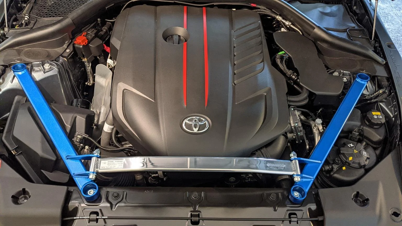

My goal is to build the car for HPDEs and something to have fun with on the road. As such, my first goal is to improve the stock components which I find lacking. The front braces on the car seemed pretty cheap and flimsy on the '21s - almost like an afterthought - so I decided to upgrade to the Cusco front brace:
This definitely helped tighten-up the front end, made turn-in sharper, and made the car feel more precise. Definitely worth the upgrade, even on a '21 that comes with the bars from the factory. Next up was fixing the less than stellar brake pedal feel. So I picked up and installed the Verus Engineering master cylinder brace:

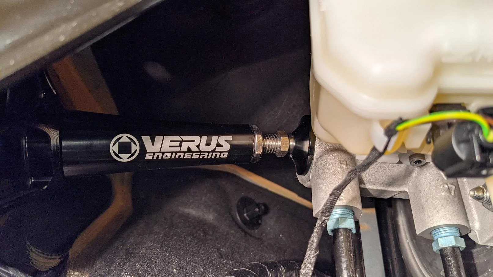

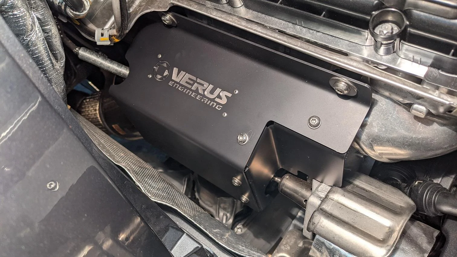

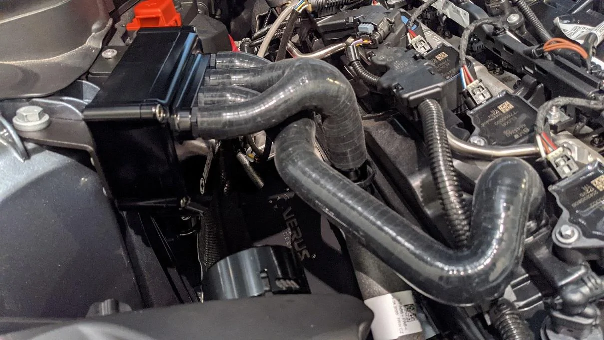

This helped significantly with pedal feel. So with that aspect of the car improved, I worked on a trio of modifications that are convenient to do at the same time: The airbox resonator delete, an air/oil separator, and the turbo heat shield, all from Verus Engineering:
A better shot of the turbo heat shield after installation without the airbox in the way:

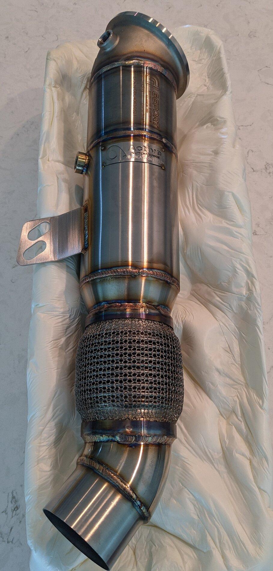

Next up was a downpipe. After ordering and inspecting the aFe catless downpipe, I decided to return it. I was a low-quality component and the piping was stepped-down opposite of the airflow direction, resulting in a sizeable ridge against the airflow, ultimately resulting in turbulence and unwanted backpressure in the exhaust system. aFe customer support was atrocious (I ended up canceling my sway bar order with them as a result, as well). I considered it a significant design flaw. They considered it normal.. I paid $90 shipping to return - they wouldn't cover it. After many recommendations from members here, I went with the Active Autowerke catted downpipe:

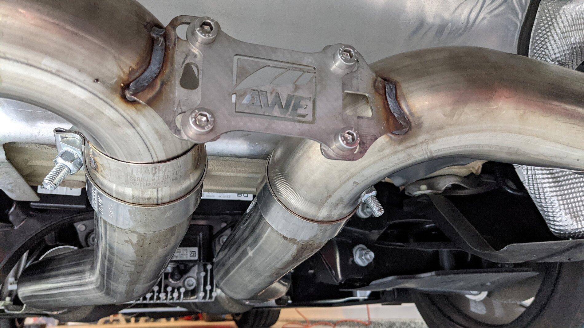

First impression was that it's a very high-quality part. With the stock exhaust, it produces a good amount of additional power, as measured by my butt dyno. On the way home from the shop where it was installed, the car actually caught me out on the cold tires and I almost looped it on a public road. Very impressive. It also gave the car a bit of a raspy sound with a more aggressive tone overall. Still very subtle. While I liked it, I was looking for more.

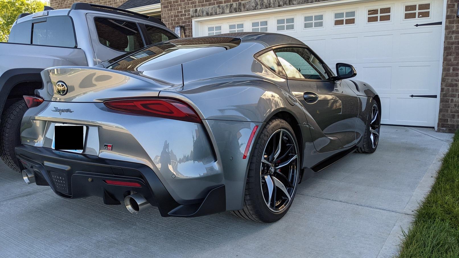

So next up was upgrading the exhaust. Based on the information in this community, the stock exhaust is just fine and likely doesn't require upgrading unless you're making 600hp+ at the wheels. However, I derive significant enjoyment from the aural experience with any car I own. After much research I decided to go with the AWE Track Edition exhaust. I was warned it would be loud. And it is. Very loud. But the tone is intoxicatingly good. I highly recommend this exhaust system:

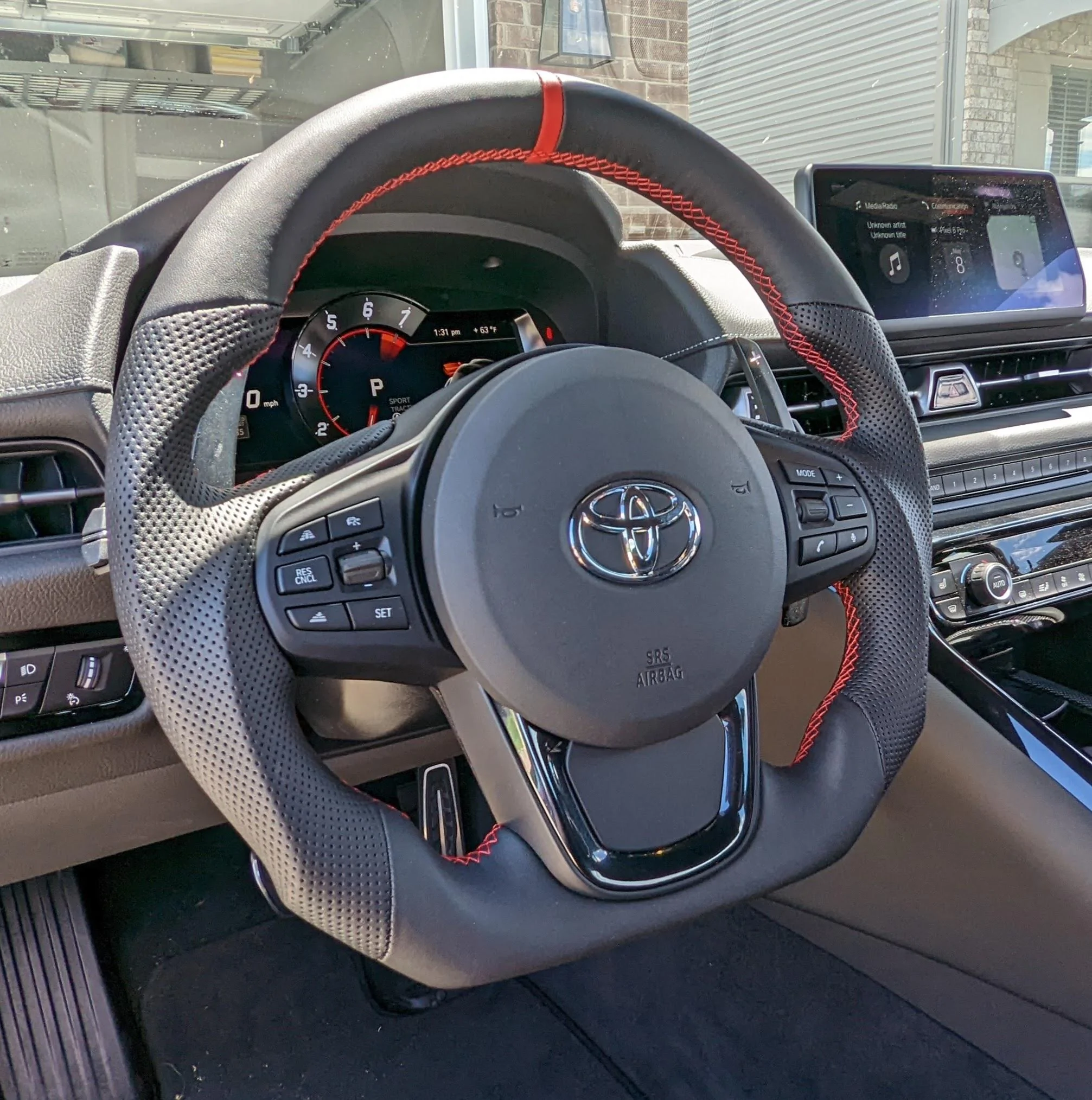

After creating a discussion here about our member's favorite upgrades (not necessarily ones that made them faster), I decided to buy a custom steering wheel based on the feedback about it. To me, the OEM steering wheel feels like it was straight out of whatever leftover parts-bin Toyota had sitting around. A user here recommended I reach out to @lpperformanceco (on Instagram), which I did, and after discussing what I was after and getting me a quote, I pulled the trigger:
It's a super high-quality part, the material feels great, has curves in all of the right places, and is nice and thick (which is the thing about the stock steering wheel that bothered me the most). The wheel makes a huge difference in how much I enjoy the car every time I get into it. I feel more connected to the car and the road. Plus it's pretty.

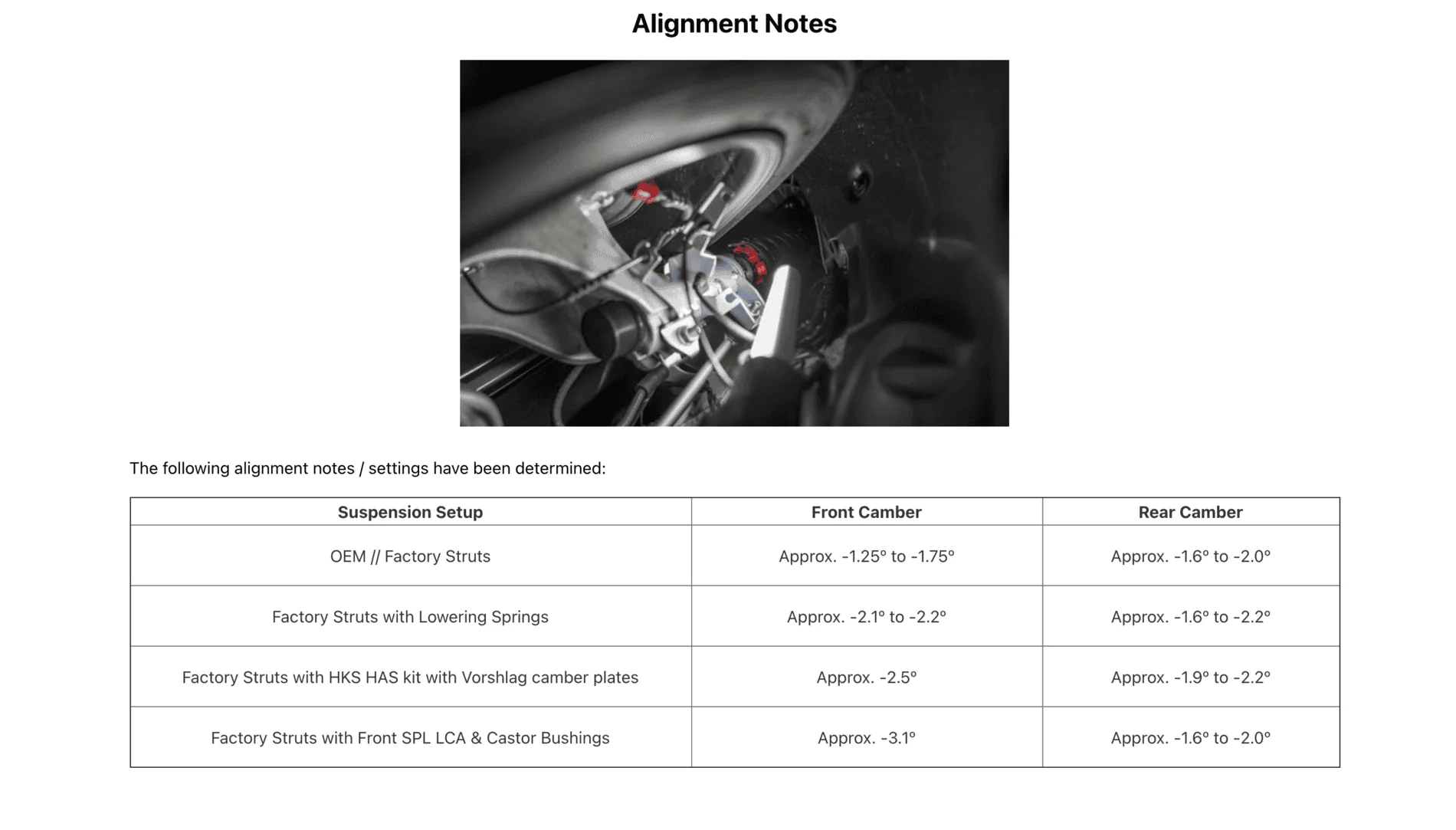

Following along! Regardless what tires or wheel combo you end up with, you're going to want more camber (at least in front) and unfortunately front camber is not adjustable from the factory. Lowering the car will give you a bit more camber but you'll probably find on track you'll fight for even tire wear and understeer. Good luck and enjoy!
Doh! Thanks for the tip. The first place the car is going after the spring install is to get an alignment, which honestly, I should probably do now from the factory anyway given how out of spec some of these cars are coming. I'm considering a full SPL setup ($$$) which from what I understand, will given me the ability to adjust the front camber to the spec I desire. It's just such a big investment, however, the increase in road feel and the ability to tell what the car is doing under you is probably worth it. I'm not a big fan of Toyota's over-boosted power steering!
EDIT: I should probably mention that I'm planning on just buying another set of the factory wheels to put race rubber on. I will likely powder coat both sets, but they are solid, light, factory wheels for a car like this.
It's a pretty common strategy to get a second set of factory tires. Something to consider that others have done is run a small front spacer and get a second set of rear wheels for the front (275 square or 285 if you like).
After chewing through my factory tires - which perform decently on track - great learning tool and exposes my mistakes for me to correct - I'll be installing the SPL FLCA and Caster bushing. I'll see how I like the car and the wear from that point forward. Everyone's different and it's more fun to experience the car's changes over time than just changing everything at once, not knowing what actually made the biggest differences for you.
All you need to adjust the front camber is the SPl front lower control arm. That is what I did while lowering. You at least don't have to do the entire SPL catalog at once. Haha
Nah, I think I want to do it all anyways because I have more money than brains. ?
