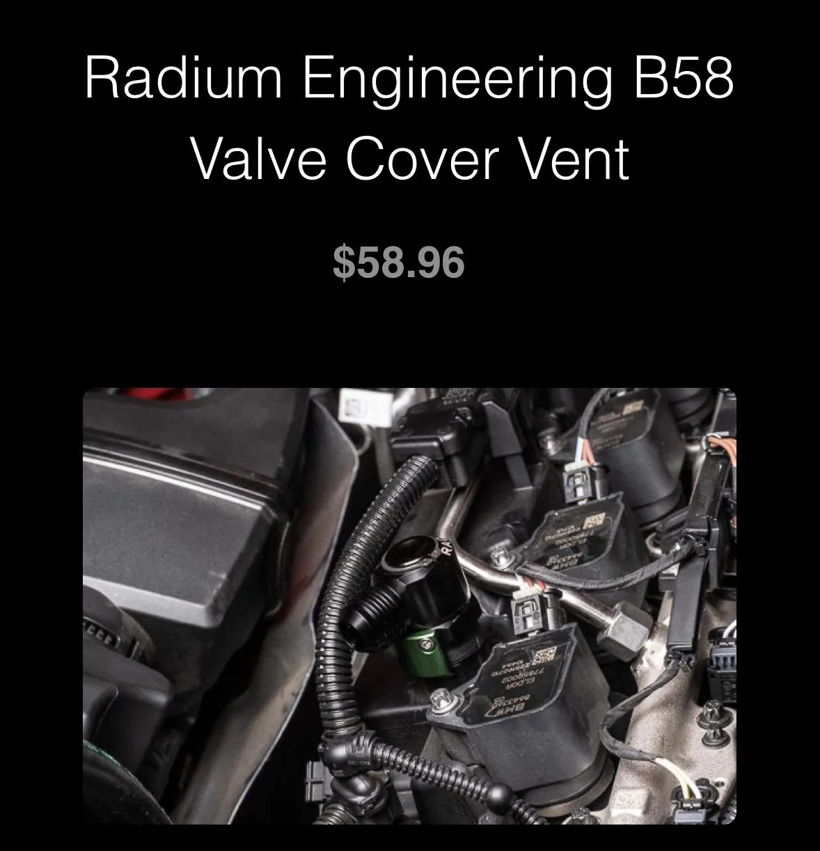

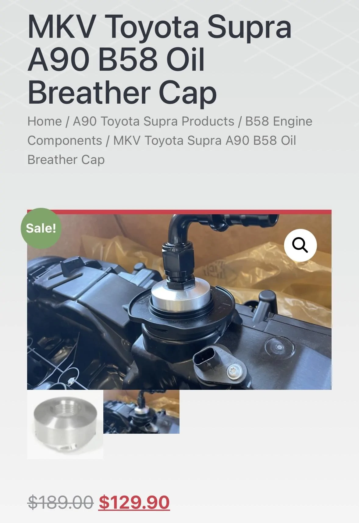

I got a lot of blow by while tuning the upgraded turbo, likely blew the valve cover diaphragm.
I have head pins coming in to block off the crank case vent soon. Once they are in, I’d like to get a catch can on.
My question is, does it matter wether the valve cover is vented to the catch can via oil fill location or the stock valve cover location. Photos added to help explain

So I'm actually running both of these to a catch can. The radium CCV vent cover and the oil cap breather are hooked up to my motion raceworks catch can via -10an.
Do you need any check valves between these 2 points and the catch can?
What did you do with the bottom crank case vent?
