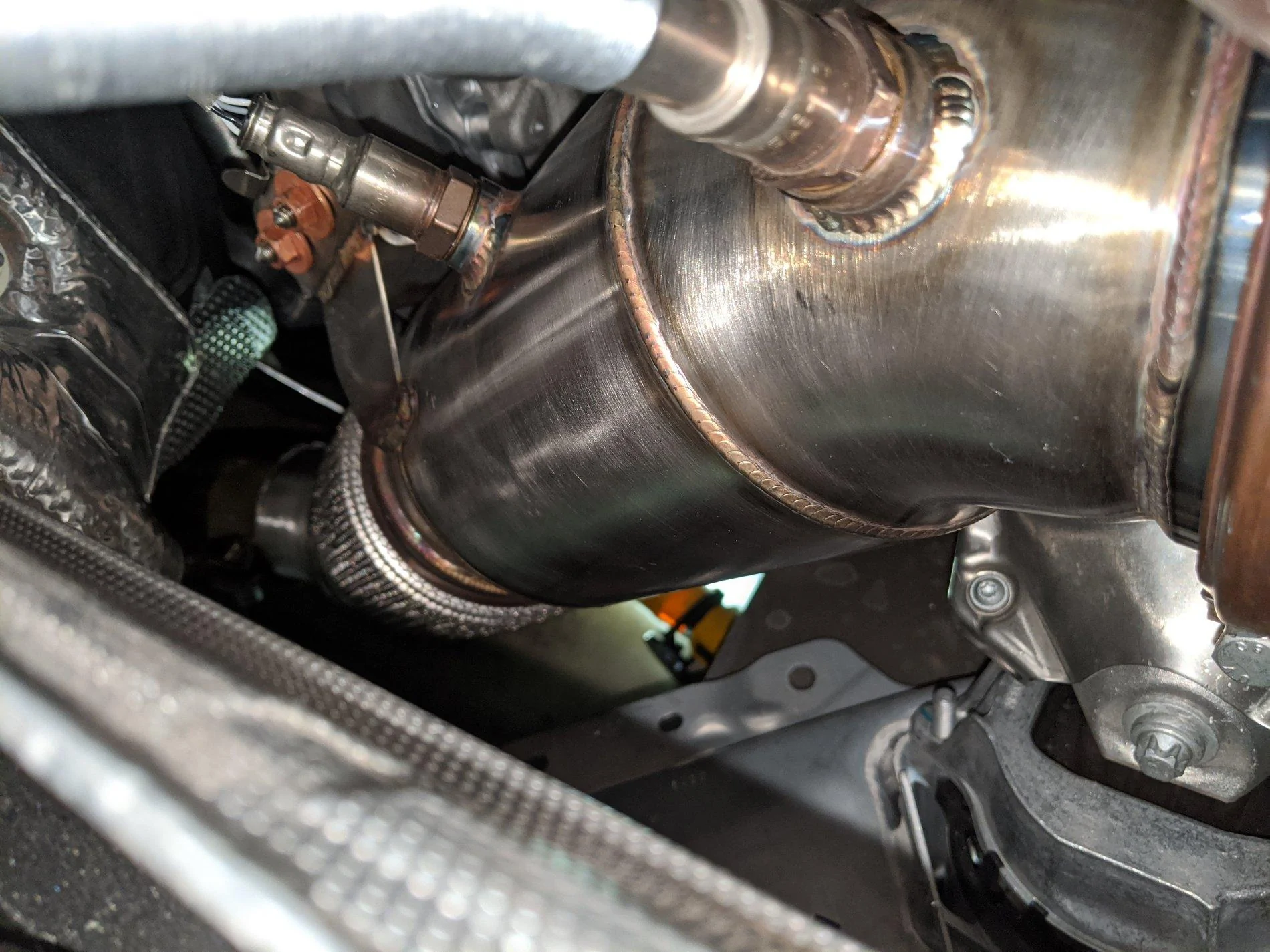

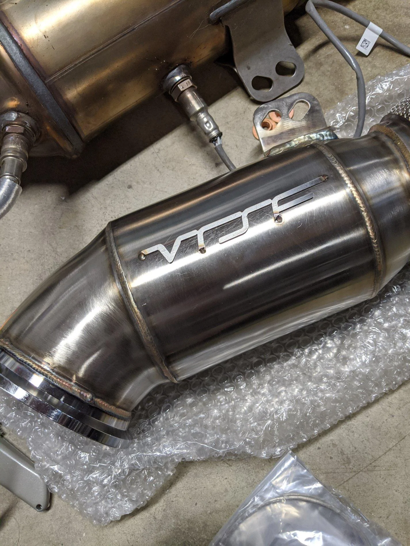

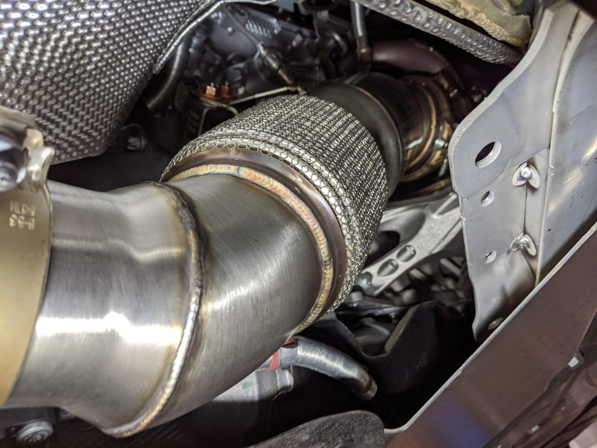

I placed a pre-order on a VRSF catted downpipe a while back and it finally got here! I installed it by myself with a set of ramps and a floor jack. Overall, installing a downpipe is doable as one-man job, but obviously a lift and/or two people helps to save you physical fatigue.
The downpipe is not as loud as the catless downpipes, but it is significantly much louder than stock DP. Paired with the stock cat-back exhaust, the downpipe improved the sound to the point where I likely do not want an aftermarket catback. I am running a BM3 Stage 2 on 91 octane tune with the cold start adjustments.

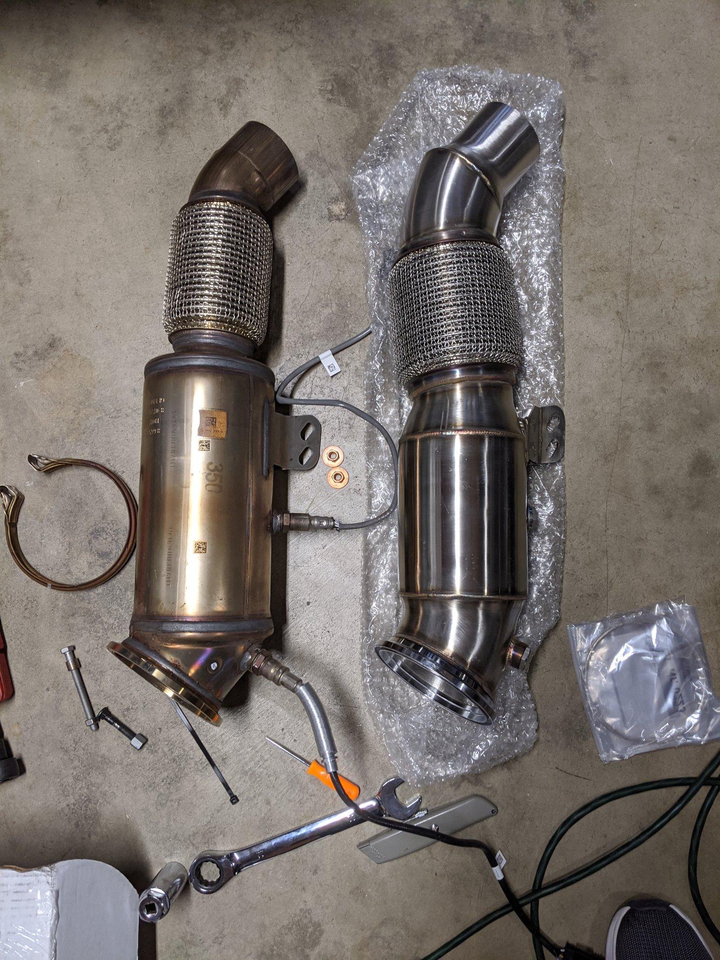

Picture kindda suggests the VRSF is longer? was that so? if yes, any issues mounting?

The angle of the pic makes it look longer than it is, but it was just a tad bit longer. There were no fitment issues; there was still plenty of room to move around the downpipe while getting it adjusted and such.
