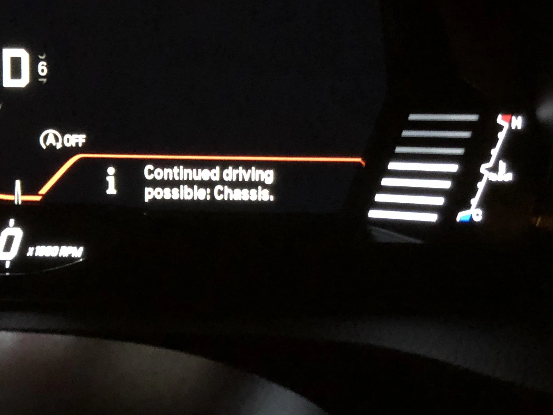

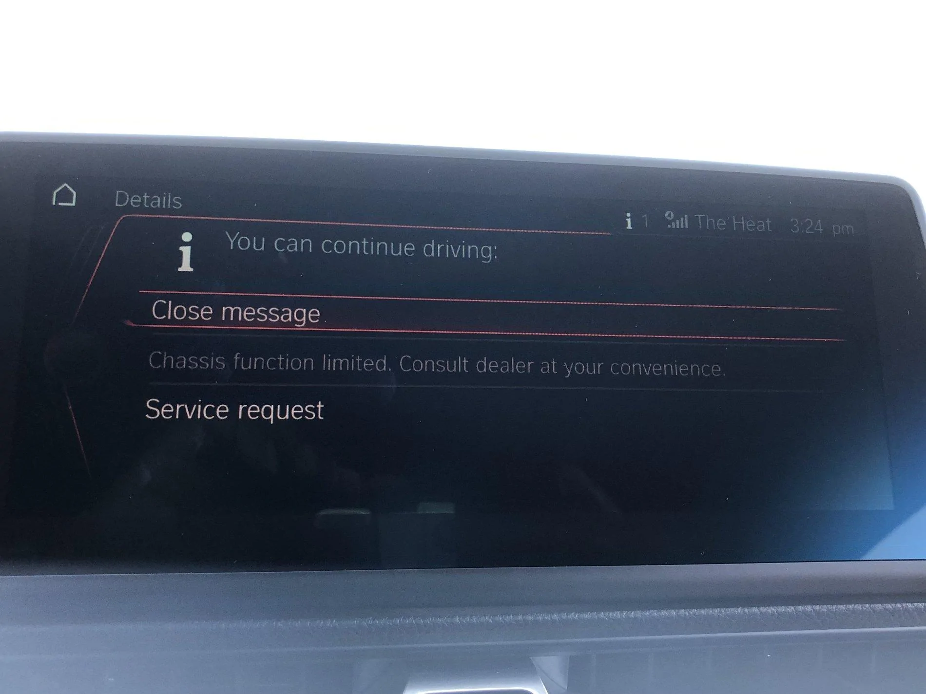

    This just popped up. Has anyone seen this message? If so, what was it? I’m not getting anything via google.
    I’ll call the dealer tomorrow and post what the issue is when I find out.

    Is this car stock?

    Yep. 100% stock and has about 150 miles. I got it yesterday morning.

    Ahh, thanks for posting this.
    Yeah, I meant nothing conclusive, or reports of Supra showing this message.
    I’m going to get in tomorrow and see if they can pinpoint the cause.

    Check tire pressures.

    I also have received this error myself somewhere just under the 40 mile mark. Bottom line is I think issue can be related a wide range of things and would be best to just take it to the dealer. When I was in town where my car is stored I made an appointment at the dealer and they said that the issue was due to headlight height adjustment arm and that it would take a few weeks for delivery. While I’m not sure what headlights have to do with the chassis, I did read on a forum online somewhere where it did clear the issue (on an BMW X5 I think). The part just came in yesterday but I won’t be back in town for few weeks, so I don’t know if that’ll correct the issue or not, but I’ll post the results when I get them.

    Ahh, interesting. I first saw it last night, then again this morning, but not when I went to lunch (when my headlights would not be on). The dealer told me today that they are suspecting something with active suspension, but I'll make sure they look into this as well since it only seems to be happening when the headlights are on.

    So my issue ended up being a level sensor arm for the damper. He said it looked damaged but not because it hit anything, so probably either a manufacturing defect or some carelessness when the tech removed the spacers during the PDI.
