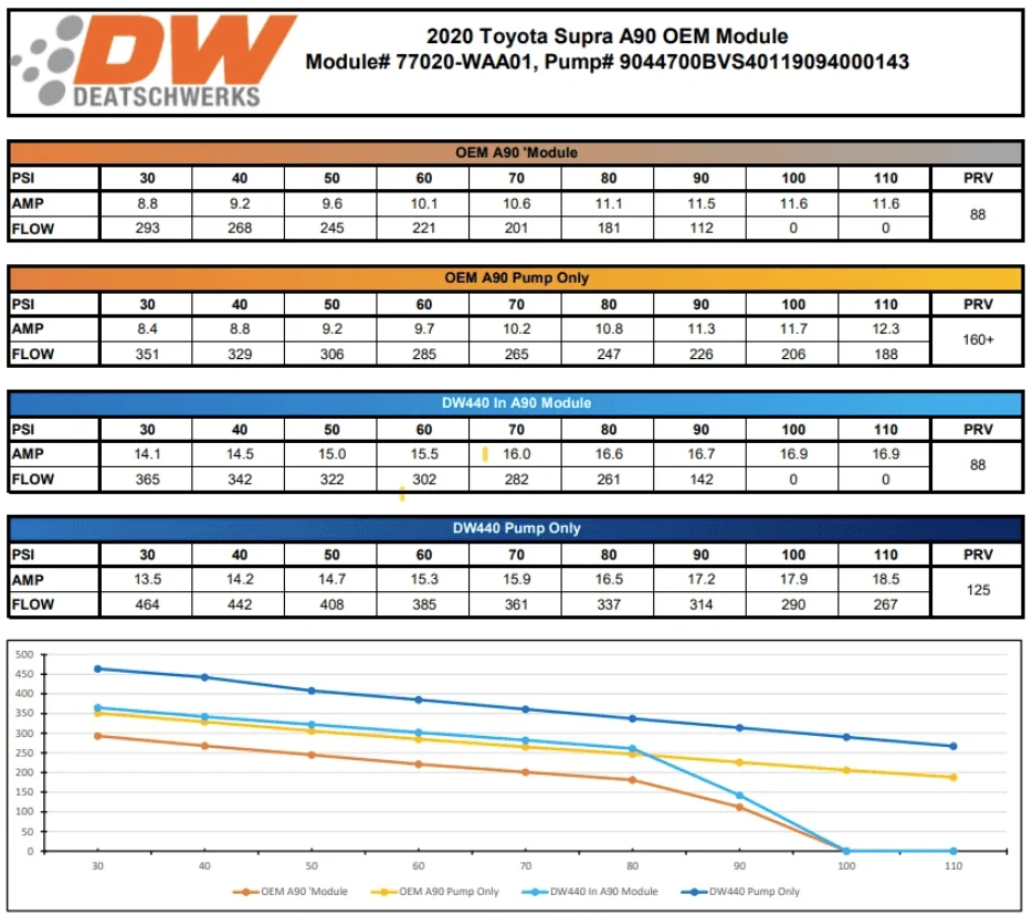

There are NO upgraded fuel pumps. The Dorsch pump is for the G1 platform that runs a 20MPa fuel pressure. The supras use a 35MPa system. This is not compatible. And even if it did the injectors on the supra would run short at high rpm. Port injection with Motiv is the only good way to do proper fueling beyond the stock setup.
A lift pump can also help as the fuel pressure does drop a bit.
