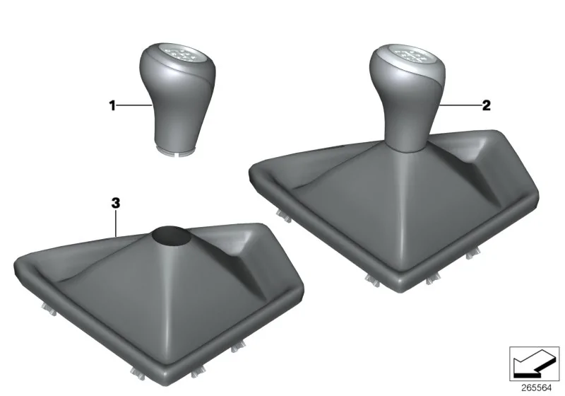

BMW 340i Shift Knob and Trim

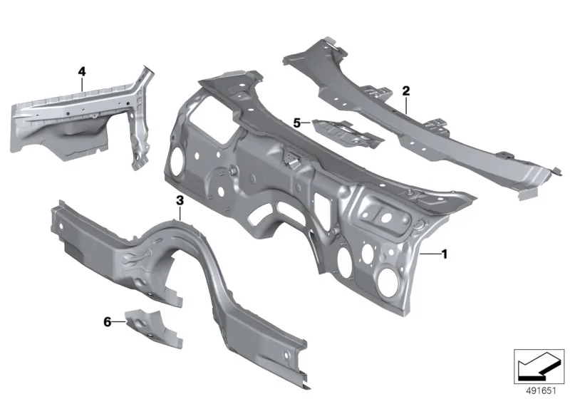

One of the bigger pieces in doing a manual swap may have already been taken care of by BMW, as the manual version of the Z4 appears to use the exact same firewall as the Supra. This means that even though the Supra is not available with the manual, all the mounting points for a clutch pedal and clutch master cylinder should already be present.
BMW Z4 and Supra Firewall. Part no: 41 11 7 479 621

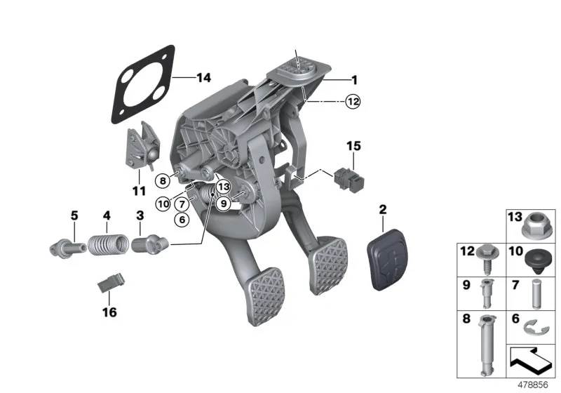

BMW Z4 Clutch Pedal and Brake Assembly. Part no: 35 00 6 873 116
Using the same firewall between cars is not unusual, especially in the case of BMW, as the E46 M3 had provisions for a clutch pedal even in the SMG version. Since we know that the Z4 clutch pedal and master cylinder will mount to the car, they can be ordered from European BMW dealers once the parts become available to solve that part of the equation.

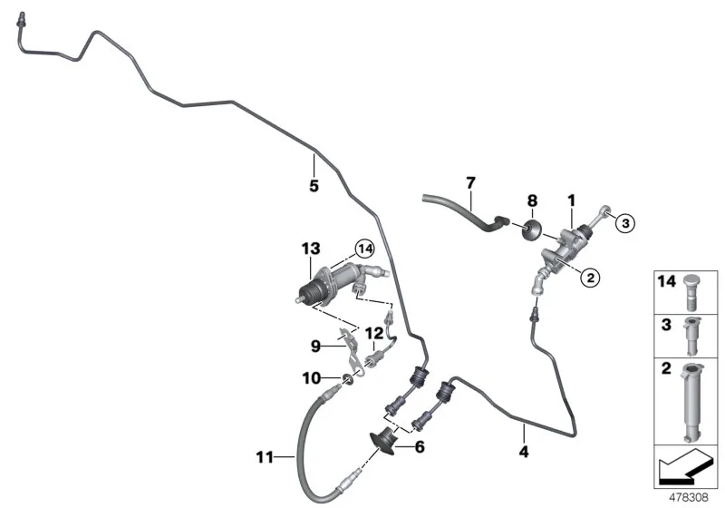

BMW Z4 Master and Slave Clutch Cylinders. Parts no: 21 52 6 876 370 and 21 52 6 795 711
The hydraulics that lead from the master cylinder to the slave cylinder can also be used and will likely mount in the Supra the same way that they mount in the Z4 so no custom lines should be required. The pieces are also very similar to the ones used on the last-gen 340i here in the U.S. so those could likely be also made to fit with some modifications.

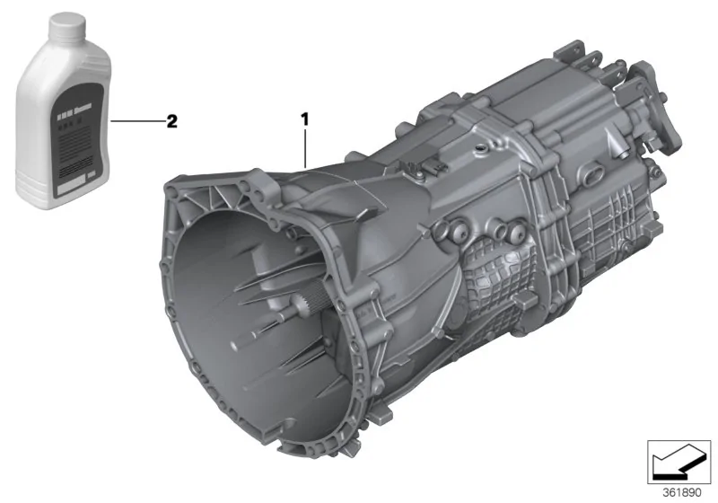

GS6-4BZ 6-Speed Manual Transmission. Part no: 23 00 7 643 881
That leads us into the next portion of the swap, which is choosing the right gearbox. Our answer may come from the 340i as it uses a variant of the same B58 3.0L engine and is available with a manual. The bellhousing pattern on the 340i engine and the Supra engine appears to be the same so the six-speed manual GS6-4BZ gearbox should bolt right up.

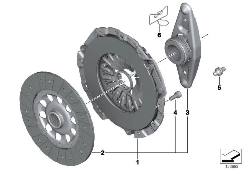

BMW 340i Clutch Set. Part no: 21 20 8 631 999
While this is the best available choice at the moment, it is important to note that the Supra produces 33 more lb-ft of torque than the Euro-spec 340i. While it should be within the tolerance range of that gearbox, this is something to bear in mind.

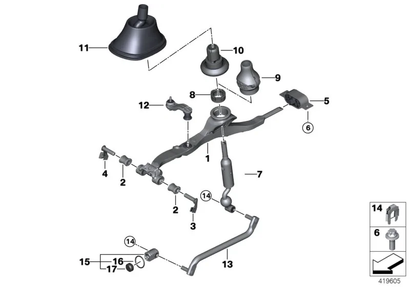

BMW 340i Shifter Linkage Prts
Supplementary pieces for the transmission such as the linkages and shifter can be grabbed from the 340i as they will bolt up directly to that gearbox but they may require some customization to be set at the correct length to match up to the shifter hole in the cabin. Alternatively, a Z4 shifter and linkages can be combined with the parts to minimize the fabrication once they are available for purchase.
The rest of the hardware, such as the driveshaft, will probably have to be customized since the new gearbox will most likely not be the same length but that part can be taken care of by most driveshaft shops for a few hundred dollars.

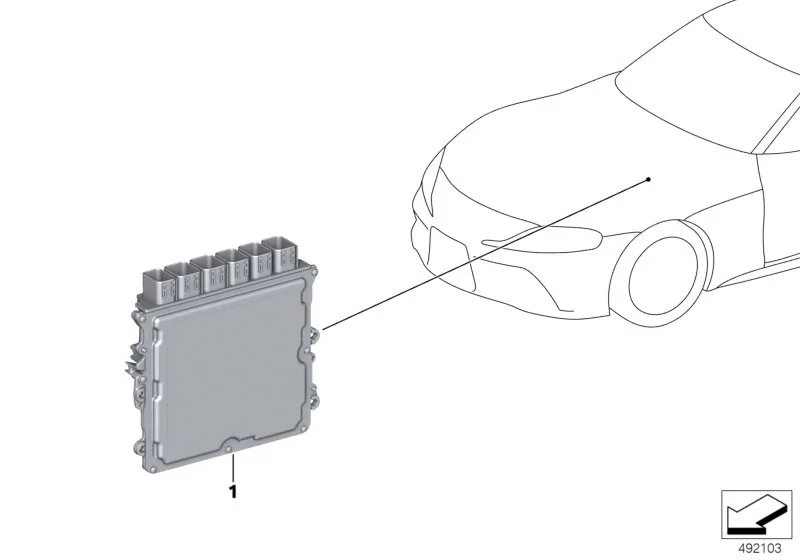

The only unknown piece of the swap right now is the electronics, since the ECU in the Supra will be looking for an automatic transmission and will go into a limp once it doesn’t find one. But luckily, there is precedent for that modification as well. Since the Supra uses a standard BMW ECU, or DME as they call it, the coding for the transmission should be editable. Once tuners are able to access it, the automatic transmission settings can be removed.

That Jalopnick article kinda glossed over the hardest part. That's a lot of assumptions right there about being able to write manual transmission code to the mk5 ecu from another ecu. I'm not sure this will ever work like a factory car with everything working the way you'd want. Also the cost would be pretty brutal. To buy one of these for 50k, then to order all that shit new from a BMW dealer and source a tranny, then figure out the electronics. Would be a 60k+ car pretty quick. But all reports suggest the real thing is on the way, let's hope no one has to actually go through with this.

Regarding the ECU and console, a manual is likely for the GRMN Supra. Adding to that the likelihood that it will still be using a B58, we will find ourselves with a publicly-available ECU/DME that exists for the Supra with a B58 and a manual. Pulling that factory software and calibration from a GRMN car and (assuming they use the same ECU) loading it onto an automatic Supra with a manual swap may possibly provide everything needed to convert non-GRMN cars into proper manual transmission models.
