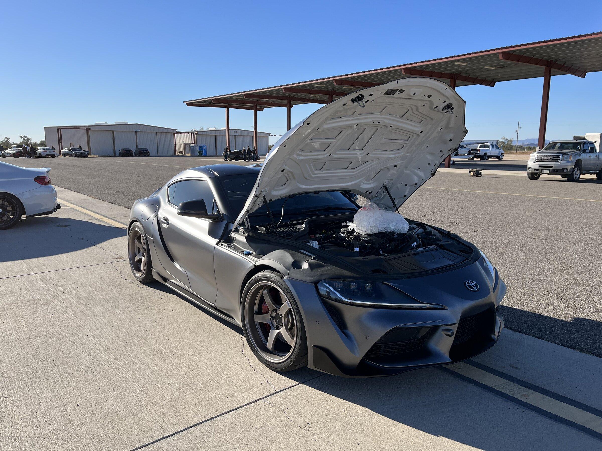

I heard you ran 171 from my buddies at CSG.. nice.. Congratulations on hitting that goal.
Thanks! I was pretty stoked especially with it being my first time. First run of the day was 171.3, backed up by another 171.3 later in the day.
Traction was a major issue throughout the day. I left the drag pack at home since I’m on stock axles and didn’t wanna end up stranded in Arizona. I was running 285/35/r19 R888R’s. Given the lack of prep on the track, I likely could’ve gotten away with using the drag pack, but it just wasn’t worth the risk to me. Hopefully I have dss axles next go around.
I believe there’s a few more mph on the table with the current setup as is. Can’t wait to go back!
