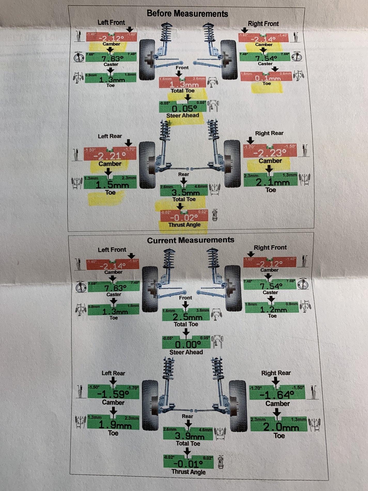

Here’s my before and after alignment measurements after H&R lowering springs. Without the alignment I was experiencing side-to-side bouncing coming off some bumps in the road and it no longer does that now.
Thank you Twitchy
