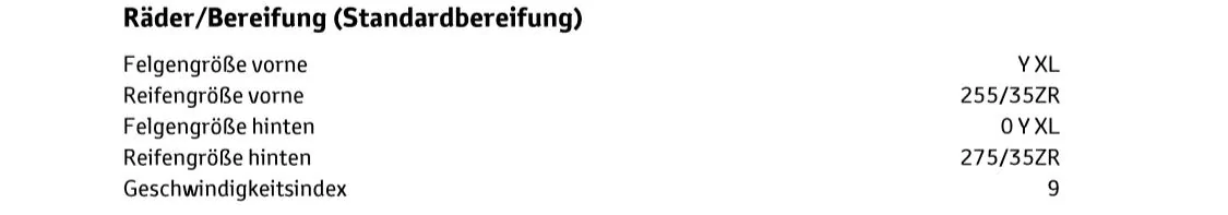

    Here is a pic from the front wheel i think

    Sorry in German but better than nothing ;)
    Front Wheels: 255/35ZR
    At the rear: 275/35ZR
