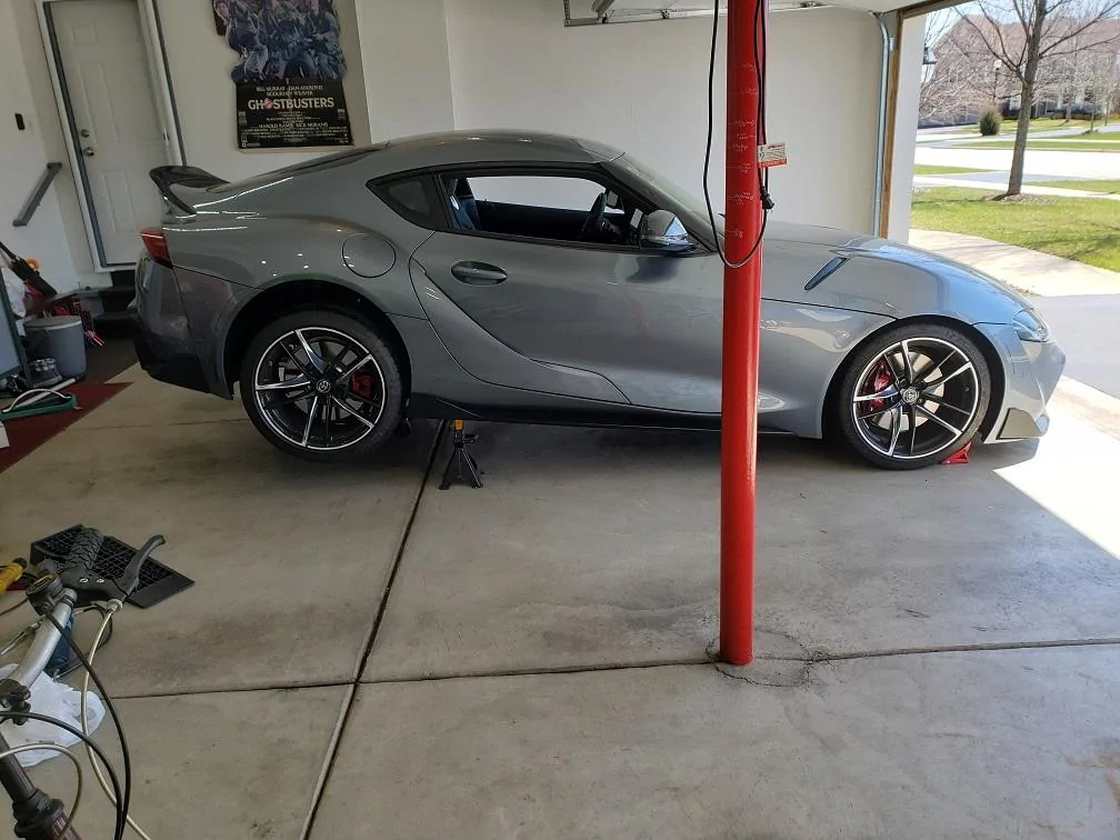

Possibly a really stupid question, I see where the Jack goes, but if my Jack goes where it supposed to where the hell am I supposed to put the jack stand? Anybody have any help on this?

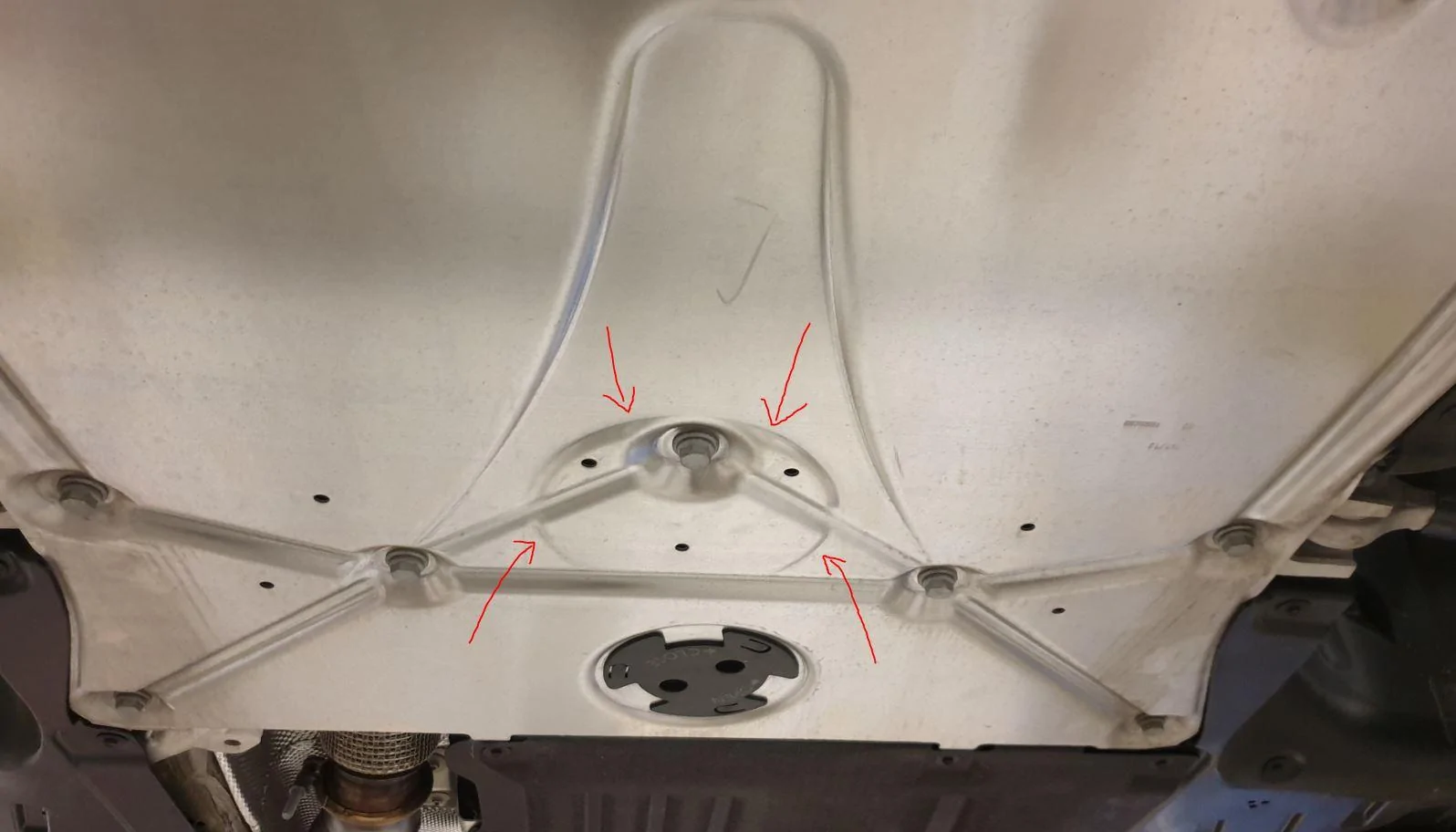

What would be nice is if there was a direct replacement for those shitty plastic jack points to make them aluminum or something. Attach it once and never thing about it again.
79
8,330
13,537
Or just crush them/remove them the first time and never think about it again.

I drive up / back up onto my Megan Racing Ramps for either the front or the back
https://www.ebay.com/itm/1136860483...zGppB+/b/VQzGjGgdigCXLoeCVag|tkp:BFBM9PCLpLdg

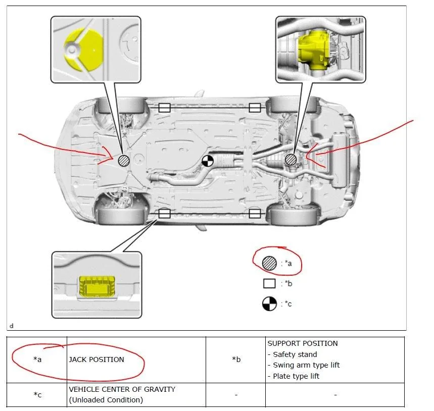

For the front - I jack up from the front jackpoint and then put jackstands on the front subframe.
For the back - I jack up from the rear on the differential and then use the rear side jackpoints with pads and put jackstands on there. You WILL NEED wheel chocks to do this.

Not too many ramps at a store that I have looked at will work well with a stock supra. I use these cheap megan ramps below to lift the car up enough to get a jack underneath it.

Seems very similar to my old MX5; floor jack under the engine and diff, jack stand on the pinch welds near front/rear wheels.
Is the issue with the material where the jack stand would go? They cover the seem with plastic?
What do shops with lifts do? I mean, I'd figure the BMW/Toyota dealers know about it -- but what about a mom and pop? Hell, what about if i'm stuck on the side of the road with a flat the goop won't fix? Odd.

Just looked under the car. Bizarre. There are little square cut outs where the jack would go. What the hell are you supposed to do with those???

I’m sure it’s been said before but there are plenty of jack pads to choose from for BMWs. Another option, I made small wood blocks that fill the center and stick out 1/4” to correspond with blocks I created for my QuickJacks. Off of that, you could always make the wood blocks and glue them into the jack points to always have the center filled so it’s flush.
