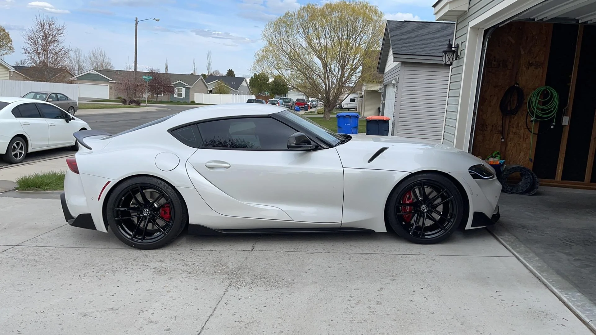

I’m running the eibach pro kit. 15mm spacers in the rear and 13mm in the front. No rubbing whatsoever. Have enough clearance as I haven’t really scraped anywhere.

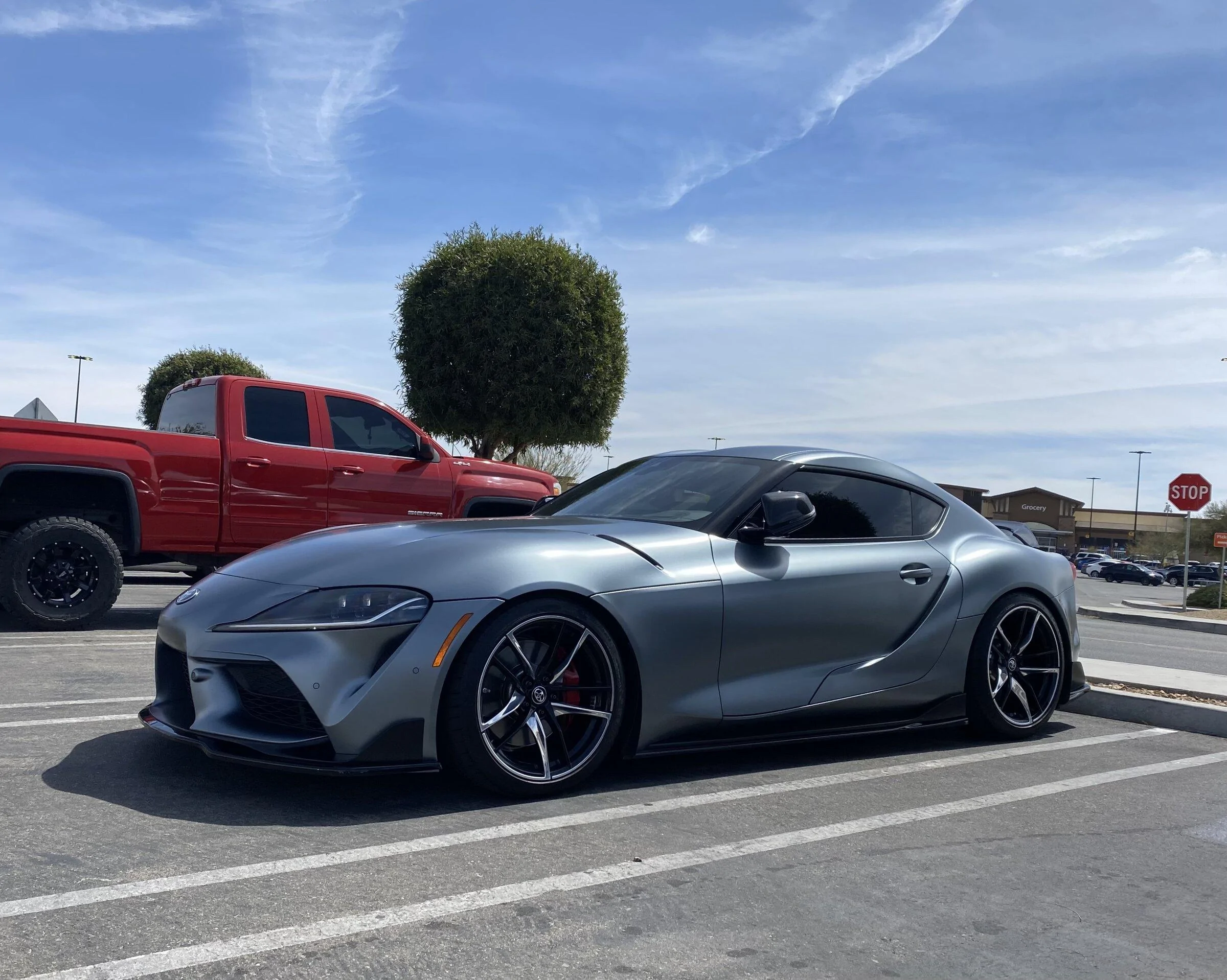

12/15 mm Motorsport hardware spacers and swift springs. Haven’t scraped yet. Not even on steep driveways but I’m always careful driving.

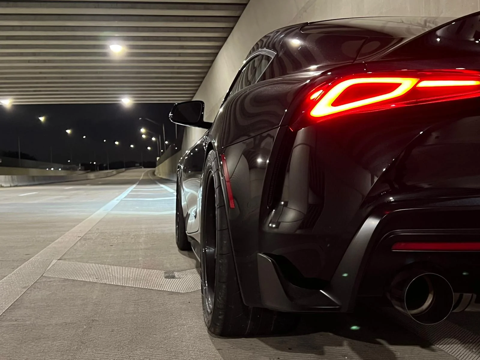

Swift springs with 13/15mm BMS spacers. I rub a little bit in the front on big freeway dips. It scrapes only when I'm not paying attention.

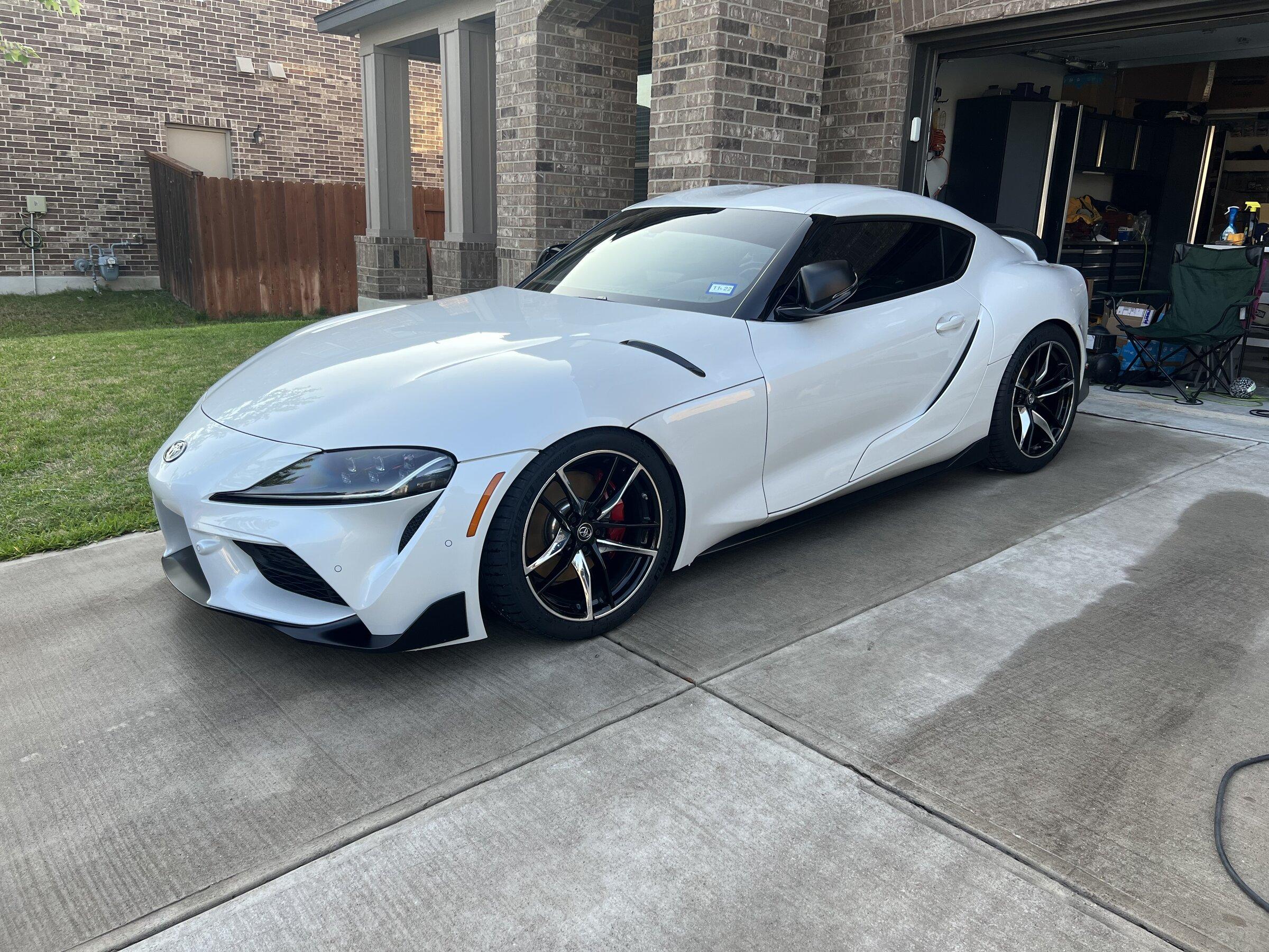

H&R springs with 15mm spacers all around. With stock tire size, no rubbing what so ever. Just installed 265/35-19 up front and it does rub on the bumper. Rears are 285/35-19 and it doesn’t rub at all.
