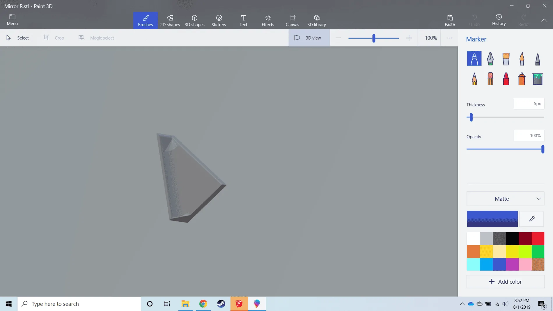

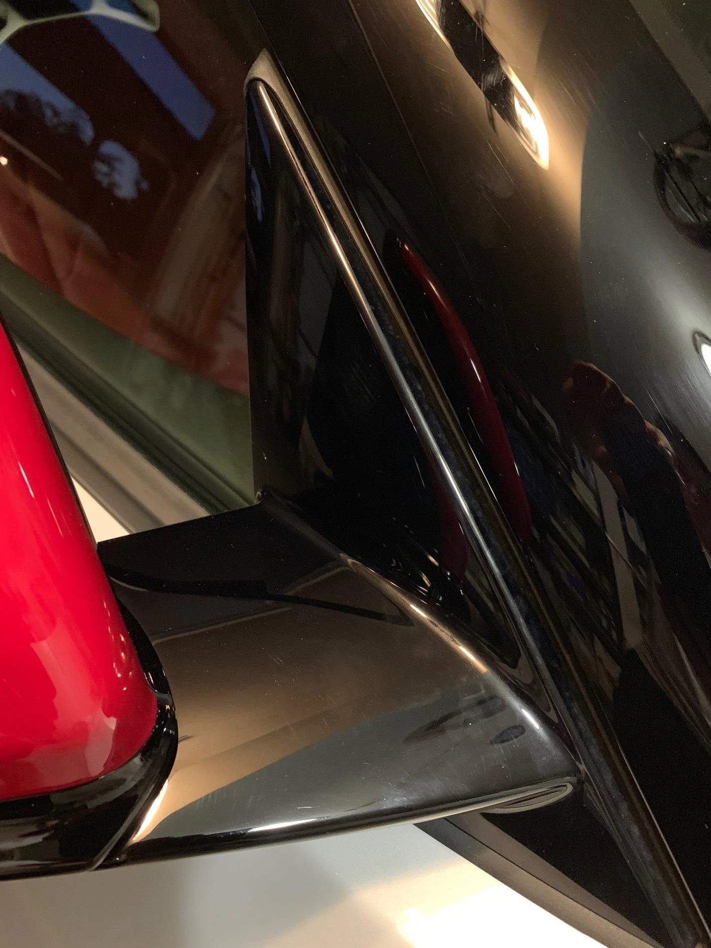

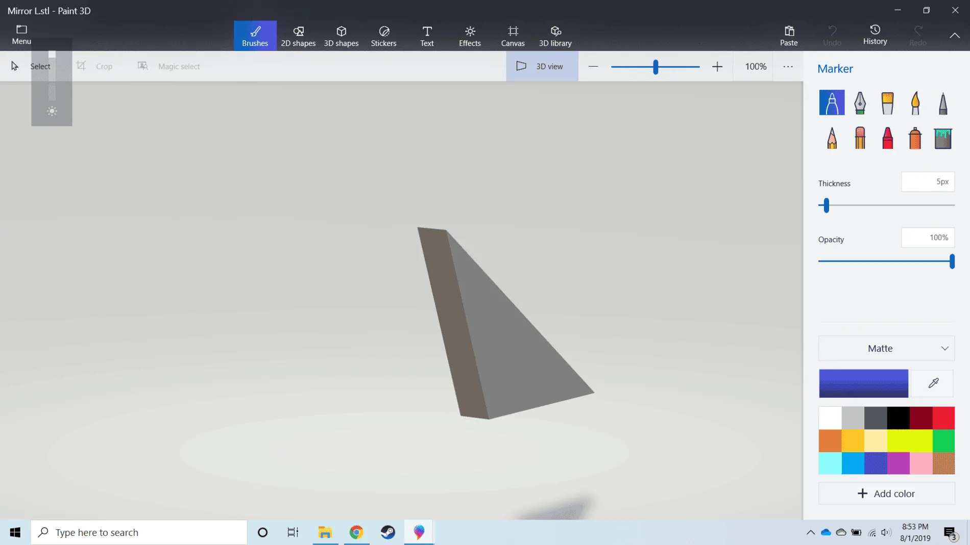

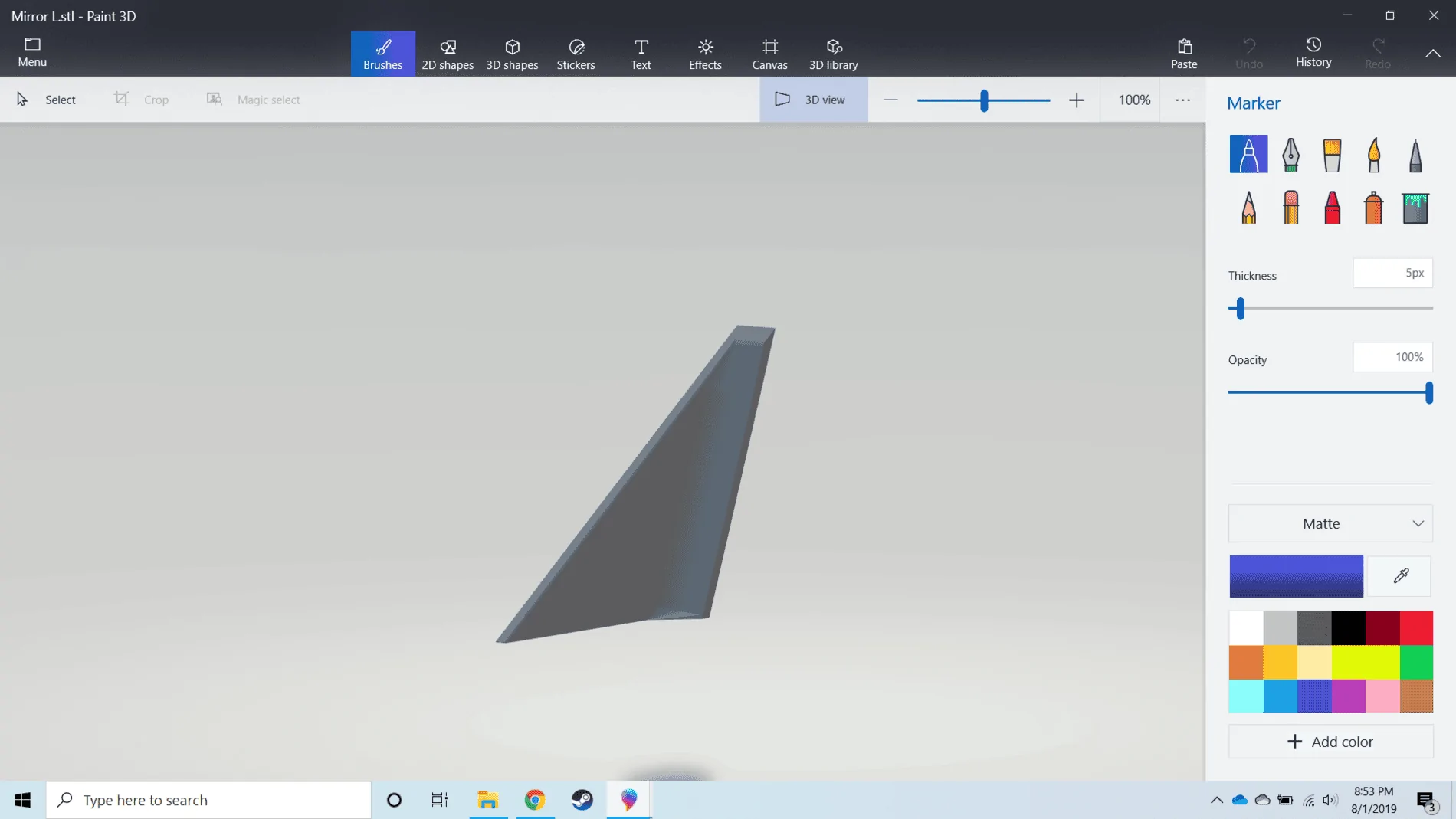

    I was just curious if anyone had done anything about the thrumming we get when we open the windows? I think it's pretty unbearable above 50 mph or so and would like to do something about it. I recall that some other people had complained about it as well?
    I mocked up a wind diffuser similar to those mounted to Porsche's and am curious if others would be interested in it if it worked?
    I test fit a to-scale drawing of it and it seems it will work.
    The hope is that it will stick to the plastic piece between the mirror and the door.

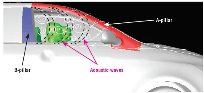

    Also, the small 2 seater interior cabin would cause more internal turbulence compared to a 2+2. The big smooth A pillars only seem to amplify it.
    “Wind buffeting typically occurs when an unstable shear layer is established at the upstream edge of the window opening, along the A-pillar in the case of front-side window buffeting. Vortices are shed from this location and travel downstream along the side of the vehicle to the structure. When these vortices reach the B-pillar, they interact with the B-pillar to generate acoustic waves that propagate inside and outside the passenger compartment. When the forward-moving waves reach the A-pillar, they trigger more vortices that move back to the B-pillar. At certain travel speeds and for certain window and cabin geometries, this process generates self-sustaining oscillations that can create large pressure variations in the cabin that are uncomfortable and annoying for vehicle passengers.”

    That is a great description and diagram. If that is the mechanism, then I can think of a few things to try -- one would be trip strips or some type of surface roughness applied to the A-pillar. Another would be some type of fence or tabs on the A-pillar. A third would be vortex generators along the A-pillar. It's a pity we don't have CAD for the Supra, otherwise I could explore this with CFD. It will have to be "cut and try" aerodynamics by an owner.

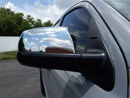

    Not sure if this is related but Toyota added these on the +2014 Tundra/Sequoia for some reason. Might be related to this issue.
    2007-2013
    2014-2020
