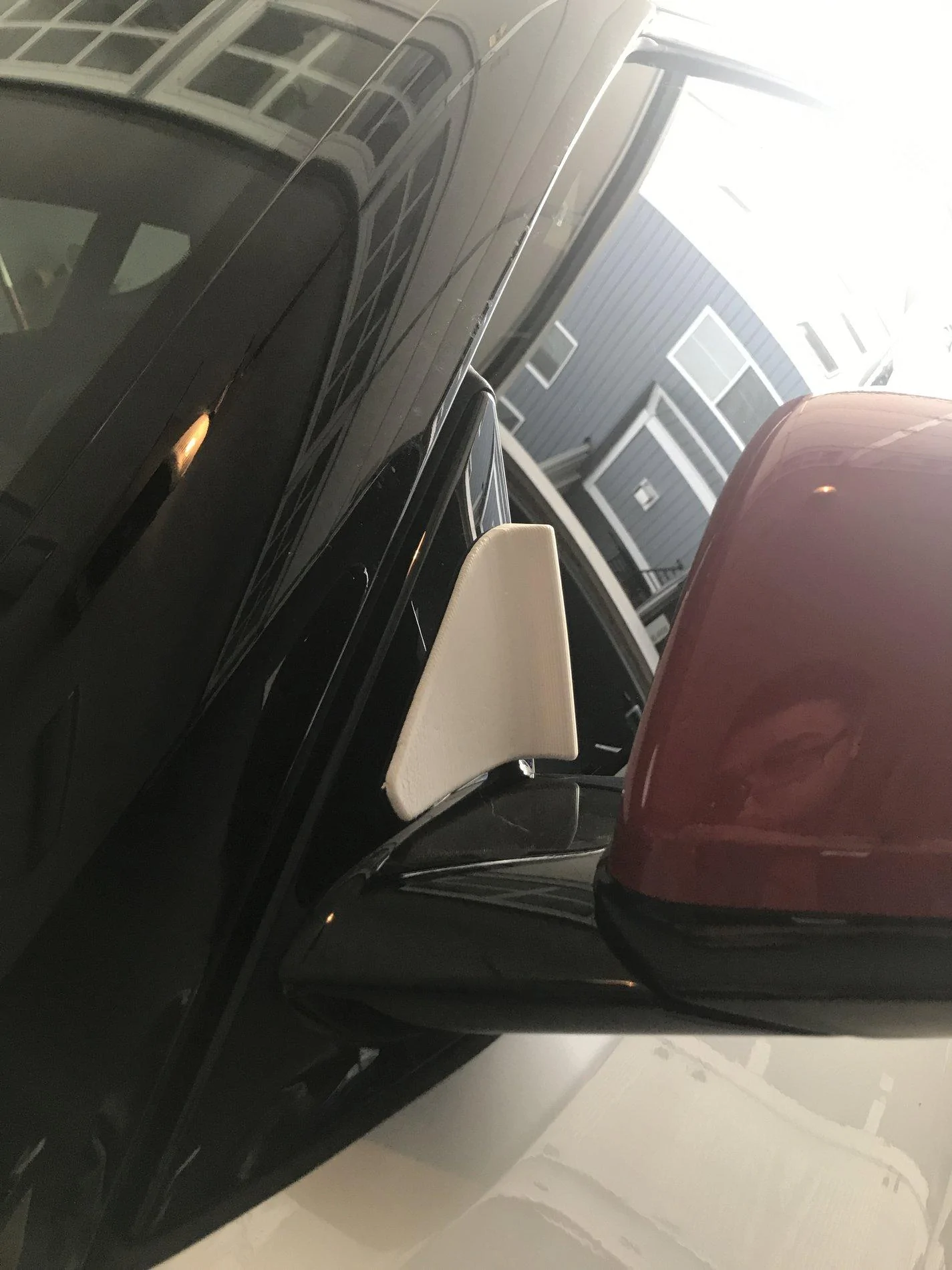

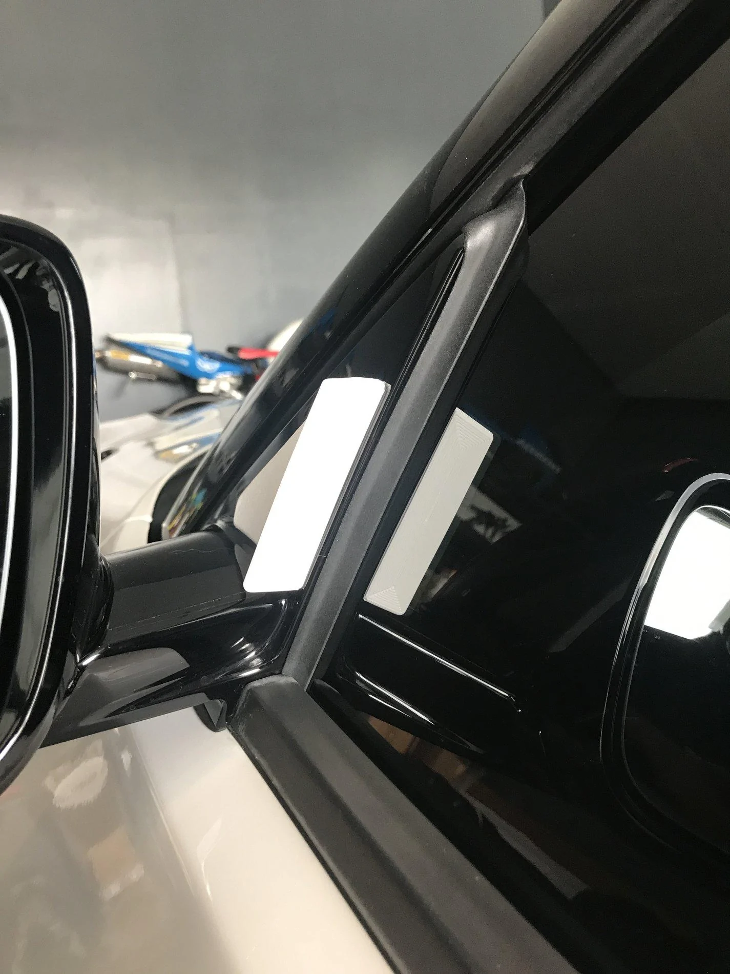

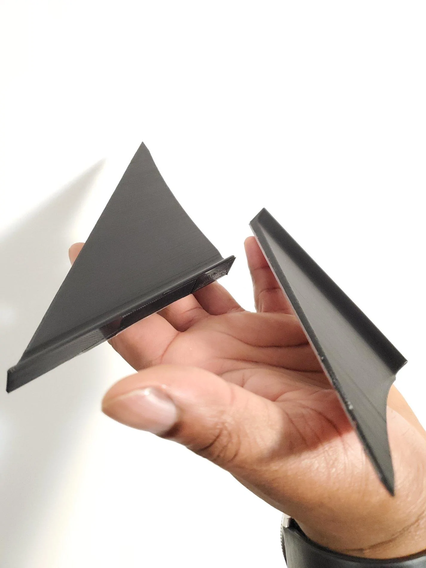

Quick update on our solution for the wind buffet. We had these printed over the weekend and did some testing. At stock we are start to experience wind buffet at 40mph. At 80mph it is pretty much unbearable. With our solution, we experience the slightest wind buffet at 70mph. At 90mph it becomes noticeable, similar wind buffet most cars experience at that speed.
if you are interested in beta testing this prototype please DM me.

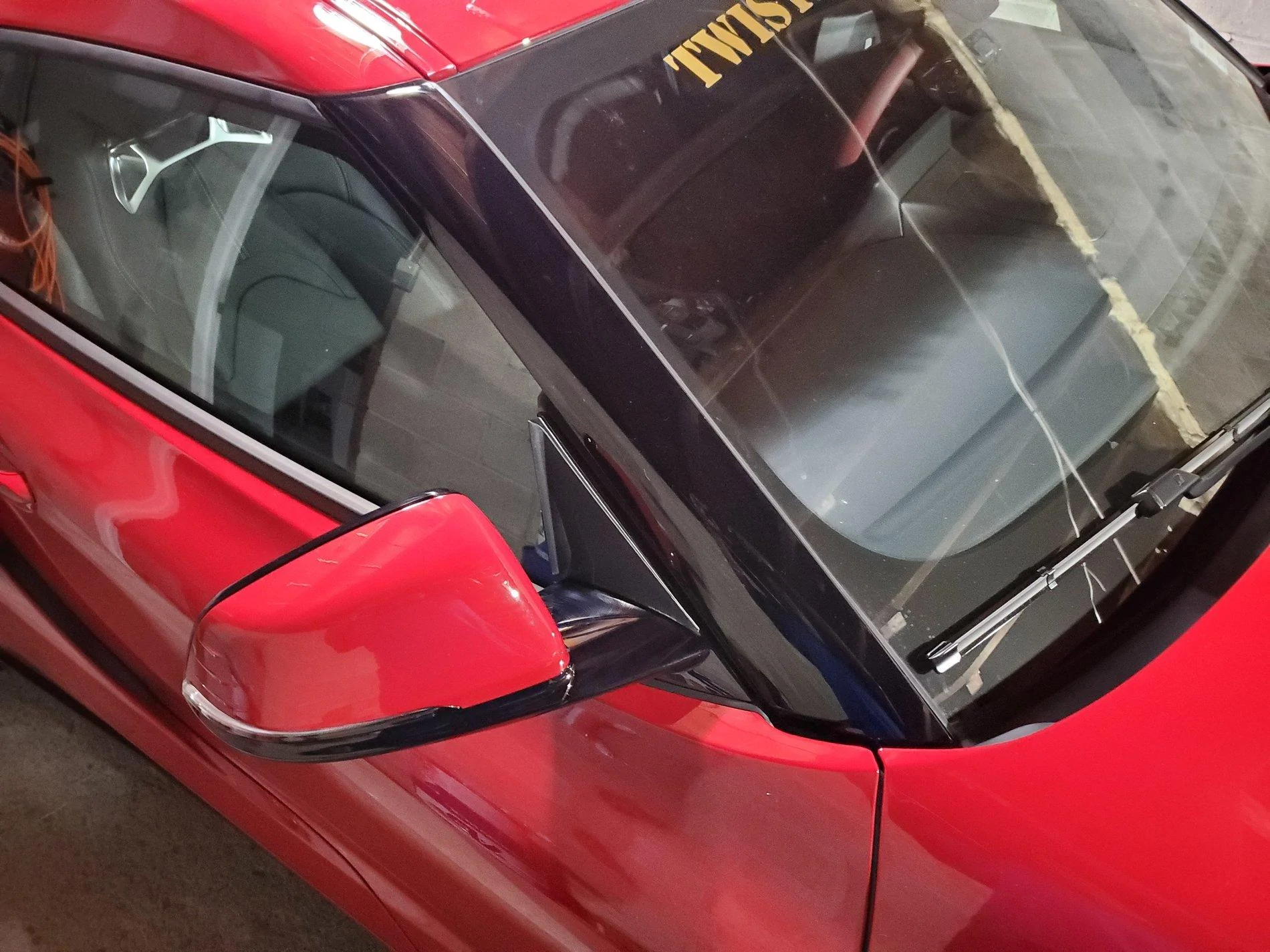

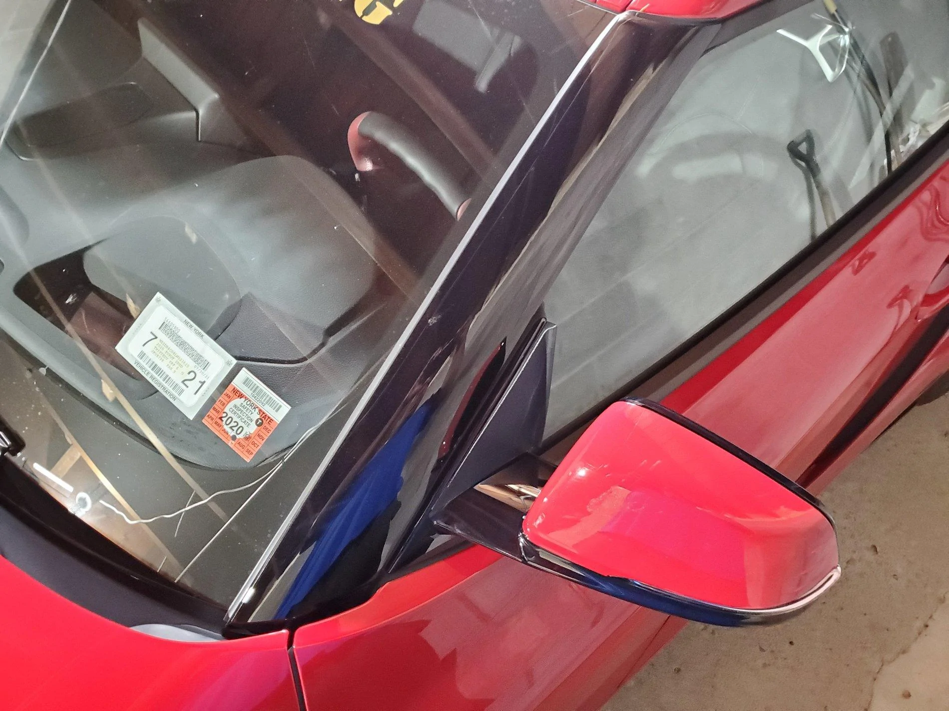

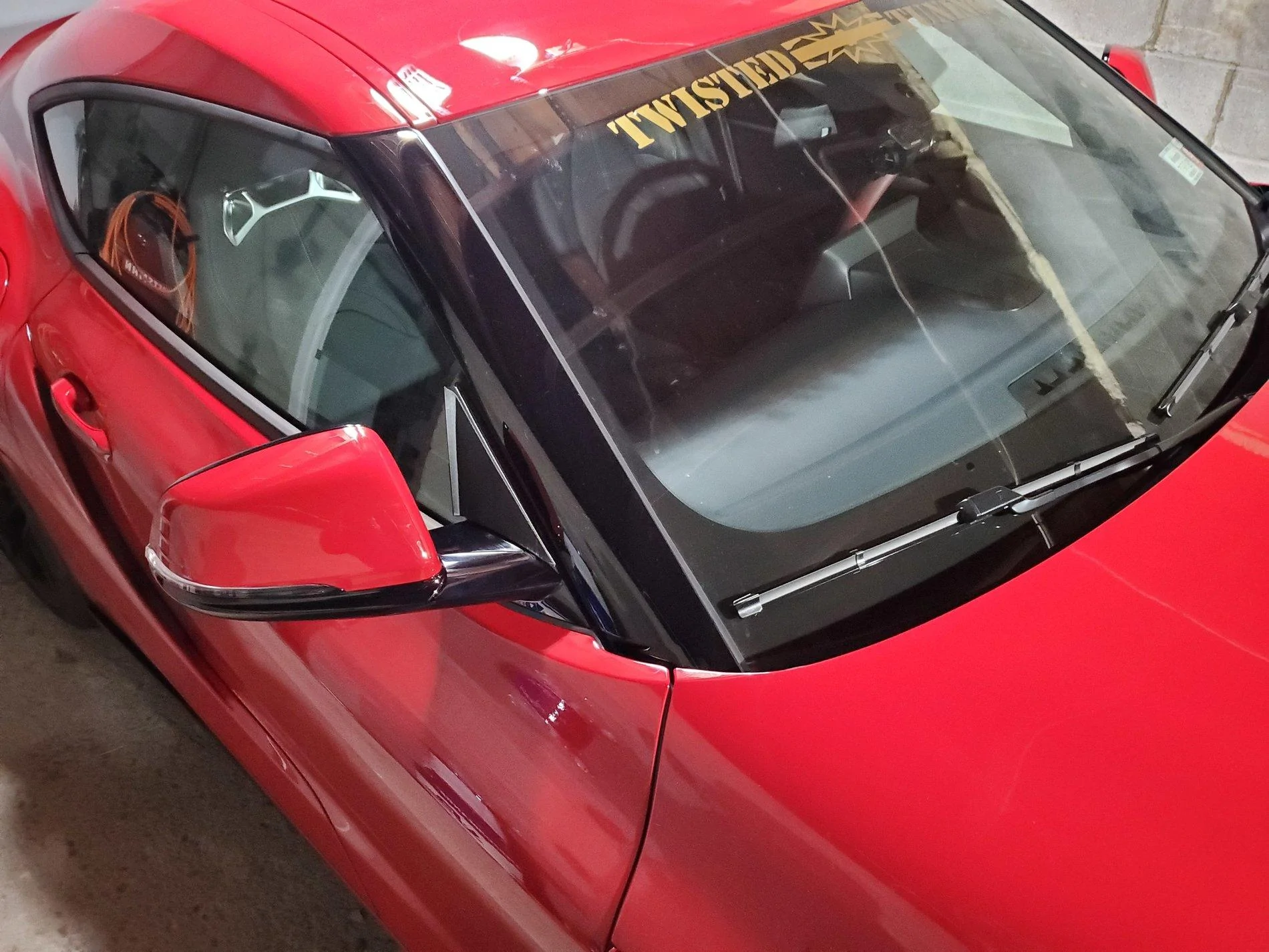

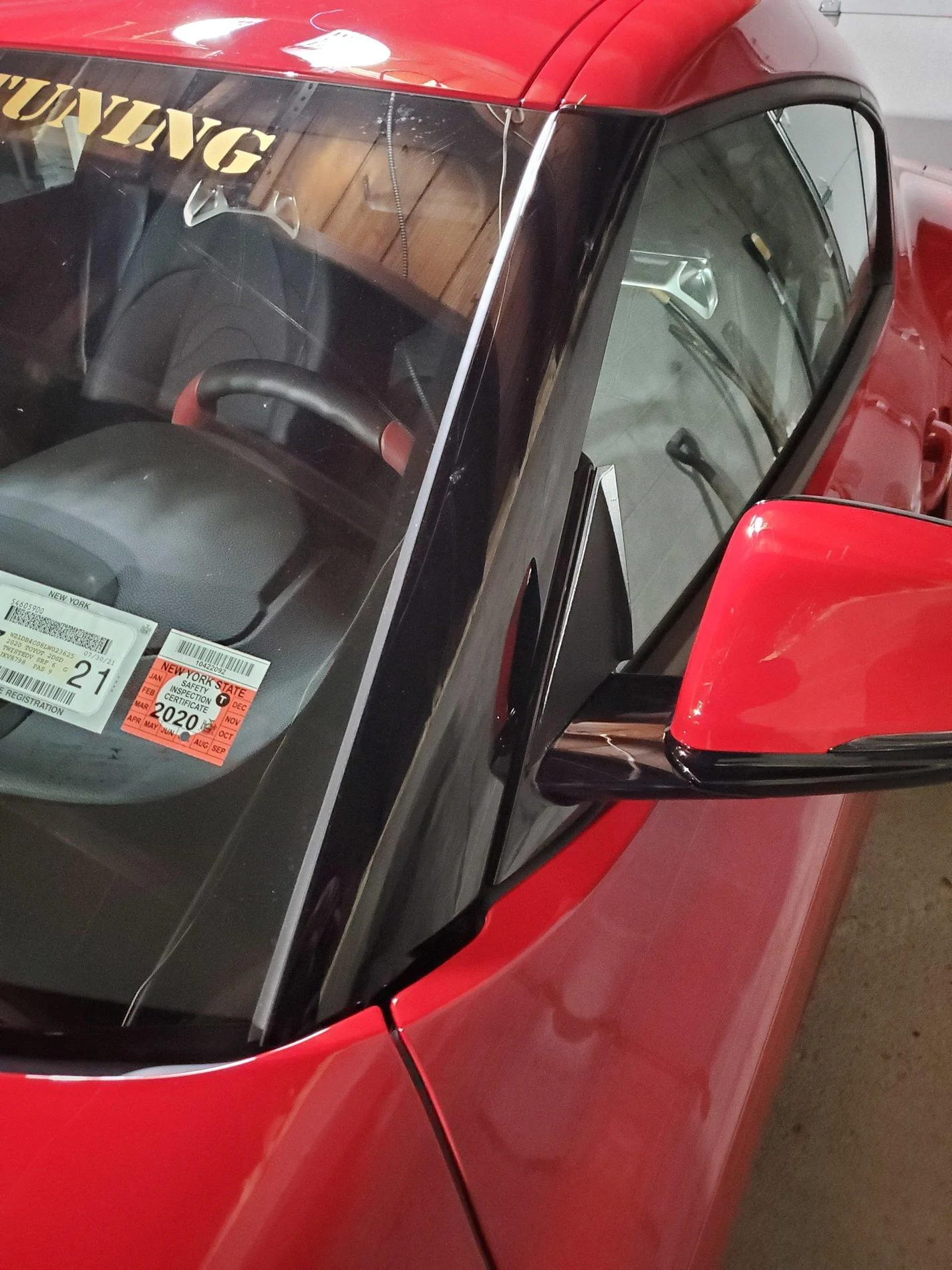

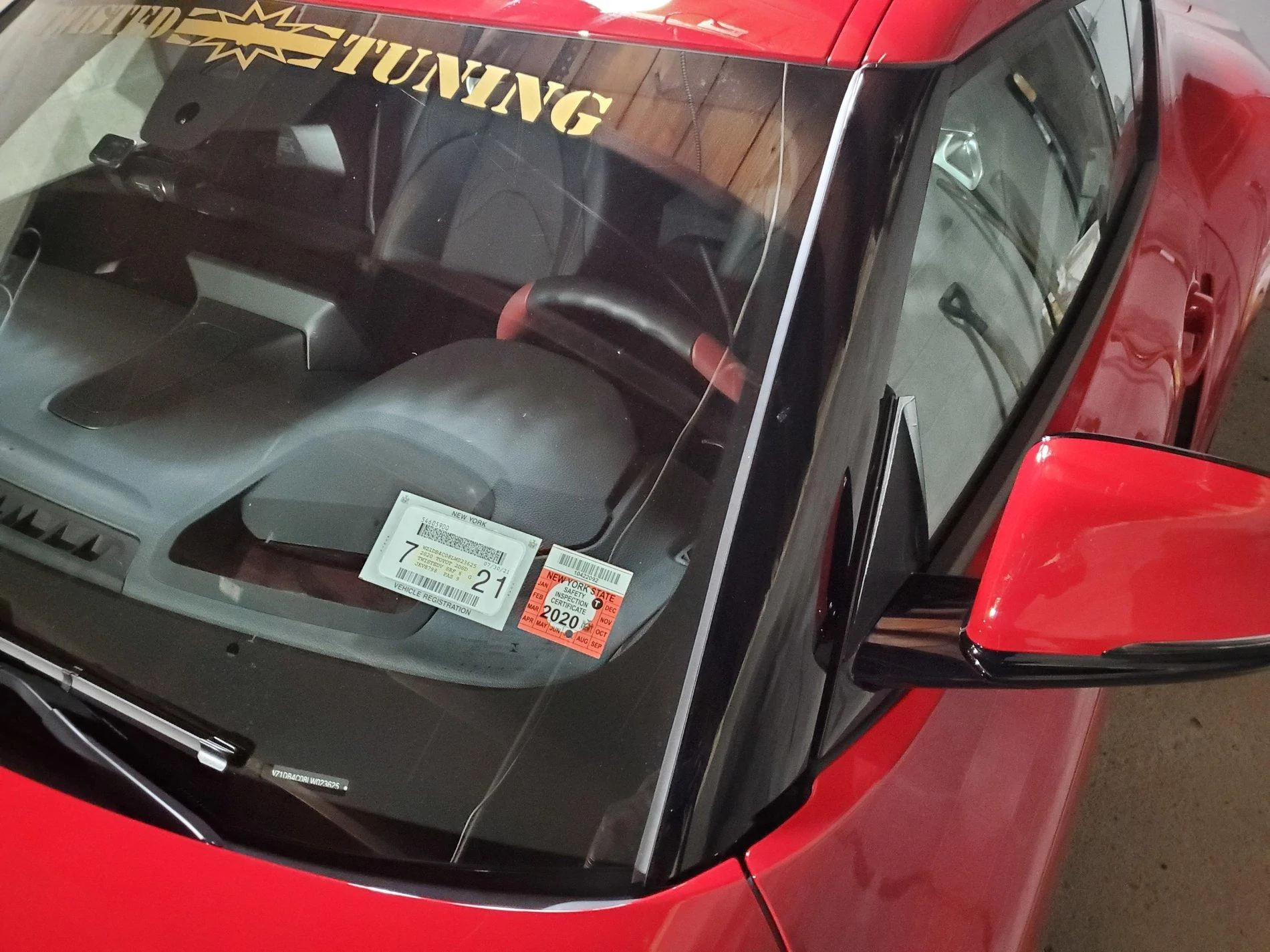

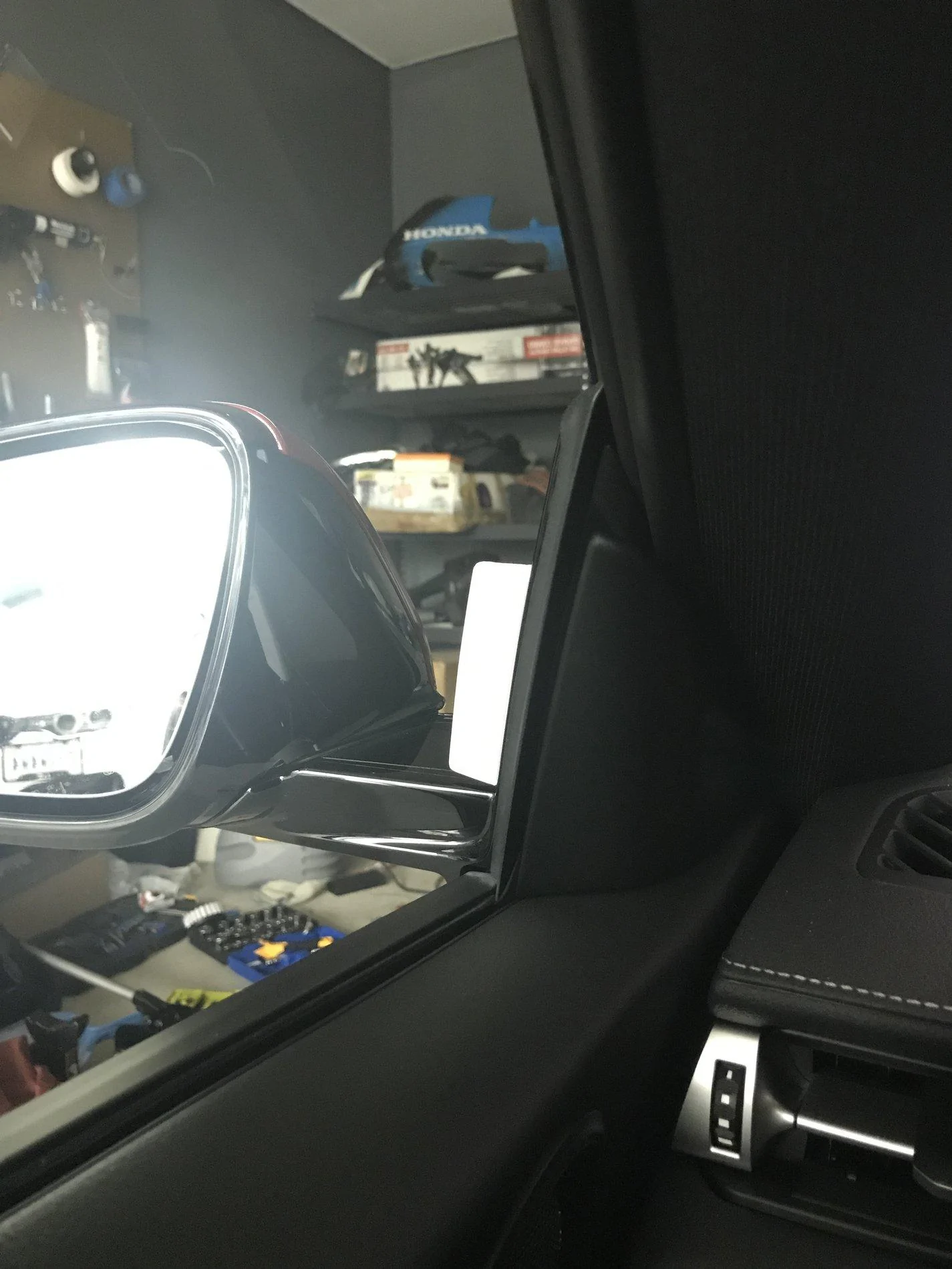

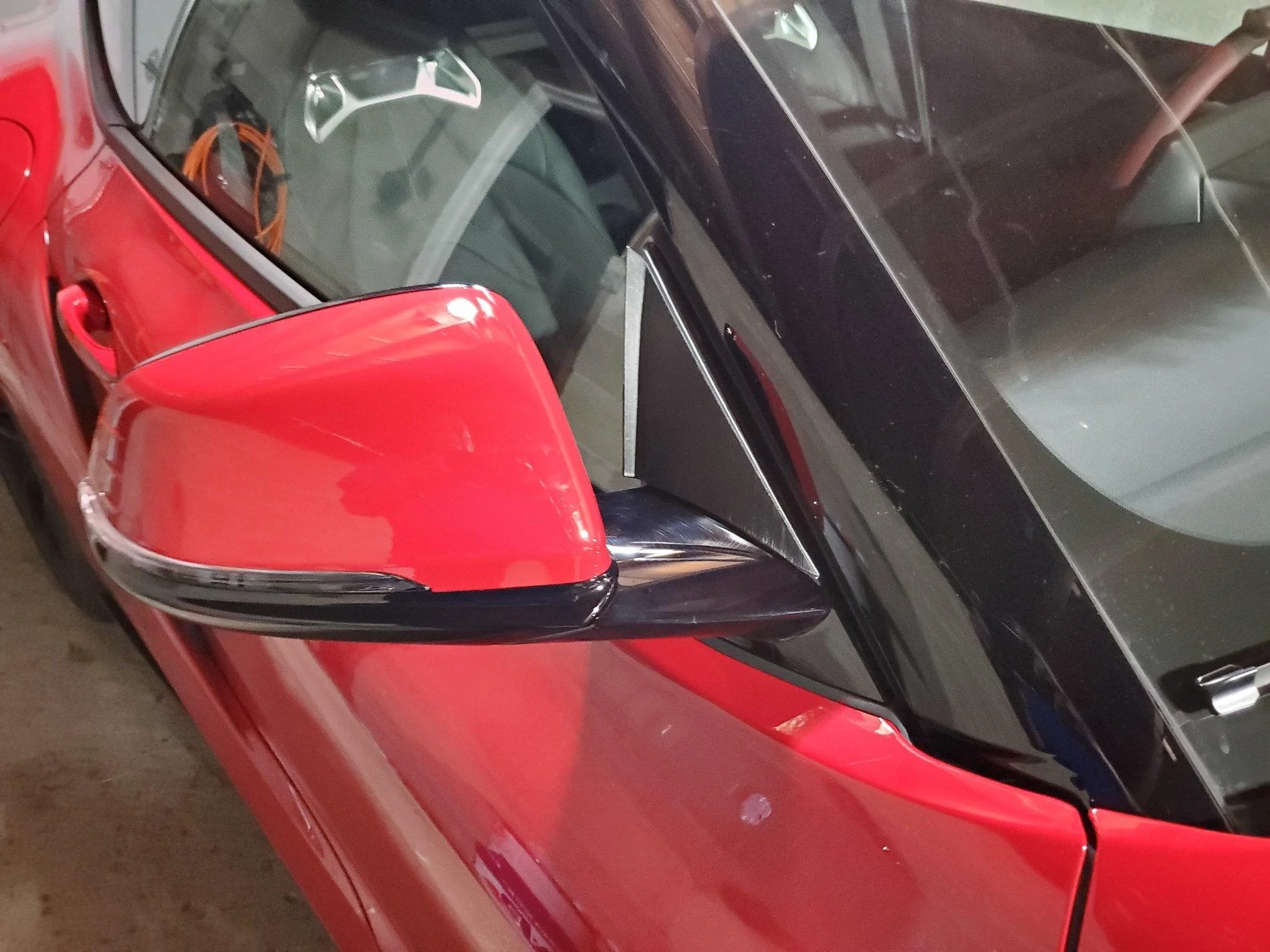

Example on the car.....goal was to get it to follow the mirror mount contour and be slim and gradually ramp up to the wind break.
Thoughts?
Thoughts?
wow you can barely tell it’s there. That’s pretty cool. I rolled my windows down over the weekend for the first time and must say it’s horrific the noise it makes.
Haros
Jul 16, 2017
195
269
Two feet
I would round off the top edge running horizontally. Probably wouldn’t even notice it’s there with that done.
I actually have a version just like that. This was quick to test the concept and make sure it worked
