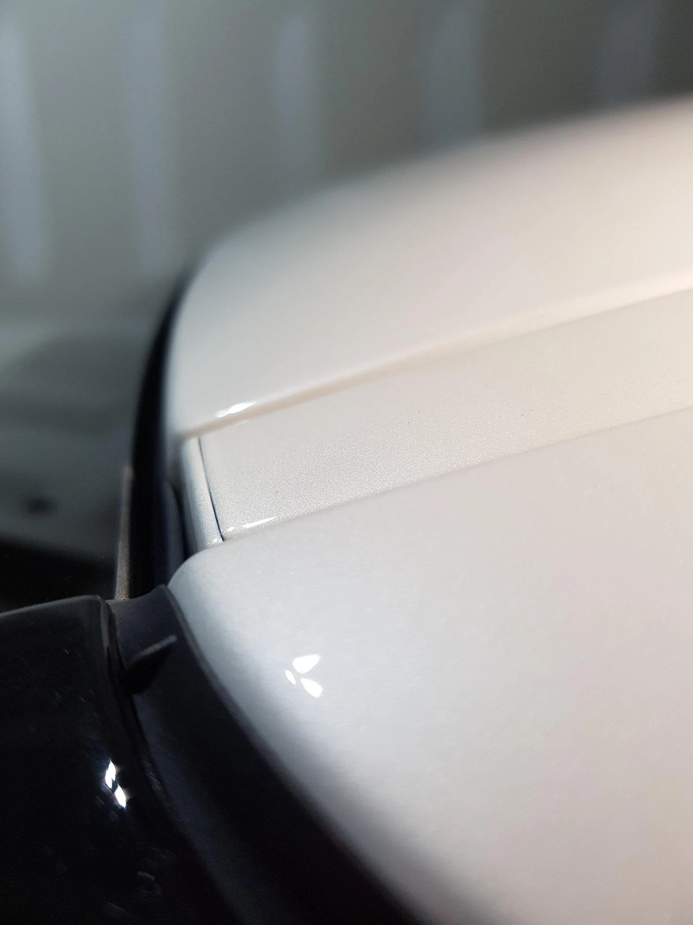

Can anyone else who got PPF using Xpel please take a look at your car. I'm seeing a TON of seams, is this because they used the pre-cut kit? I'm in the process of getting a complete wrap done, but I don't know how to proceed now.
This may get by on a back car, but on a white car this looks horrible IMHO. I need to take a better pic of the mirror cap, but ther'es actually something UNDER the film now on the edge after a few hundred miles of driving. I can easily see all the other edges getting dirty as well in a short period of time.
The pic of the roof, I think only that small strip on the roof has been done yet. I picked up the car early as the shop was going to Kentucky to get C8 training. This is not how I envisioned spending $4500 to make my car look like shit.

1st pic - mirror

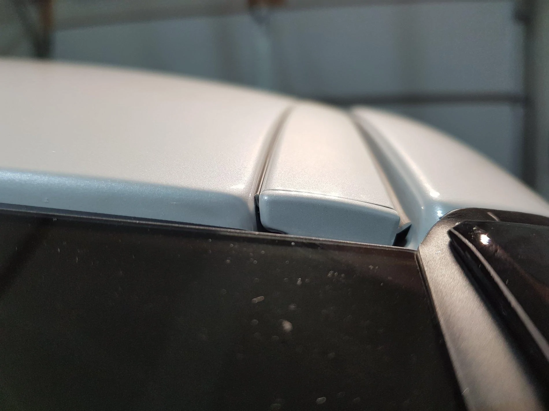

2nd pic - front quarter panel and hood area (hood was done in Suntek due to the Xpel length issue)

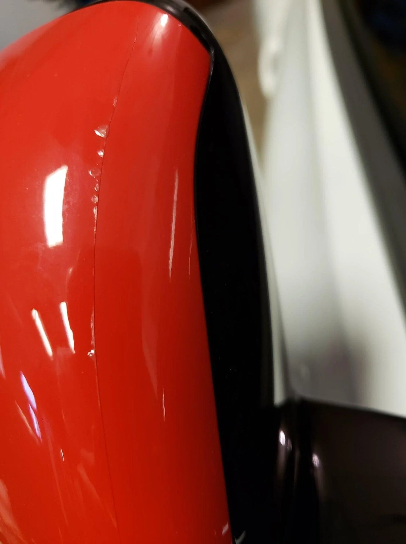

3rd pic - roof facing front of car

I donā€™t see abnormal raw film edges in pictures 2 and 3. Canā€™t see anything in picture 1.
Picture 2 shows a wrapped edge except for the very point. That cannot be wrapped, at least not reliably, so the film is normally truncated right at that point.
I donā€™t see a raw edge in picture 3, I see the seam from the factory ā€œcapā€ on the gutter cover.
Starting to think the car was wrapped unless you have pictures of film edges showing in obvious places.
Wait, so in pic 3 - everyone's car looks like that? They may not have wrapped that, I haven't went back to have the rest of the car wrapped yet, I just assumed they had done that since I didn't know why else it would look like that?

Wait, so in pic 3 - everyone's car looks like that? They may not have wrapped that, I haven't went back to have rest of the car wrapped, I just assumed they had done that since I didn't know why else it would look like that?
Yes. Hereā€™s a pic of the gutter cover on my M2 Comp, with no PPF installed. Supra is the same style part.

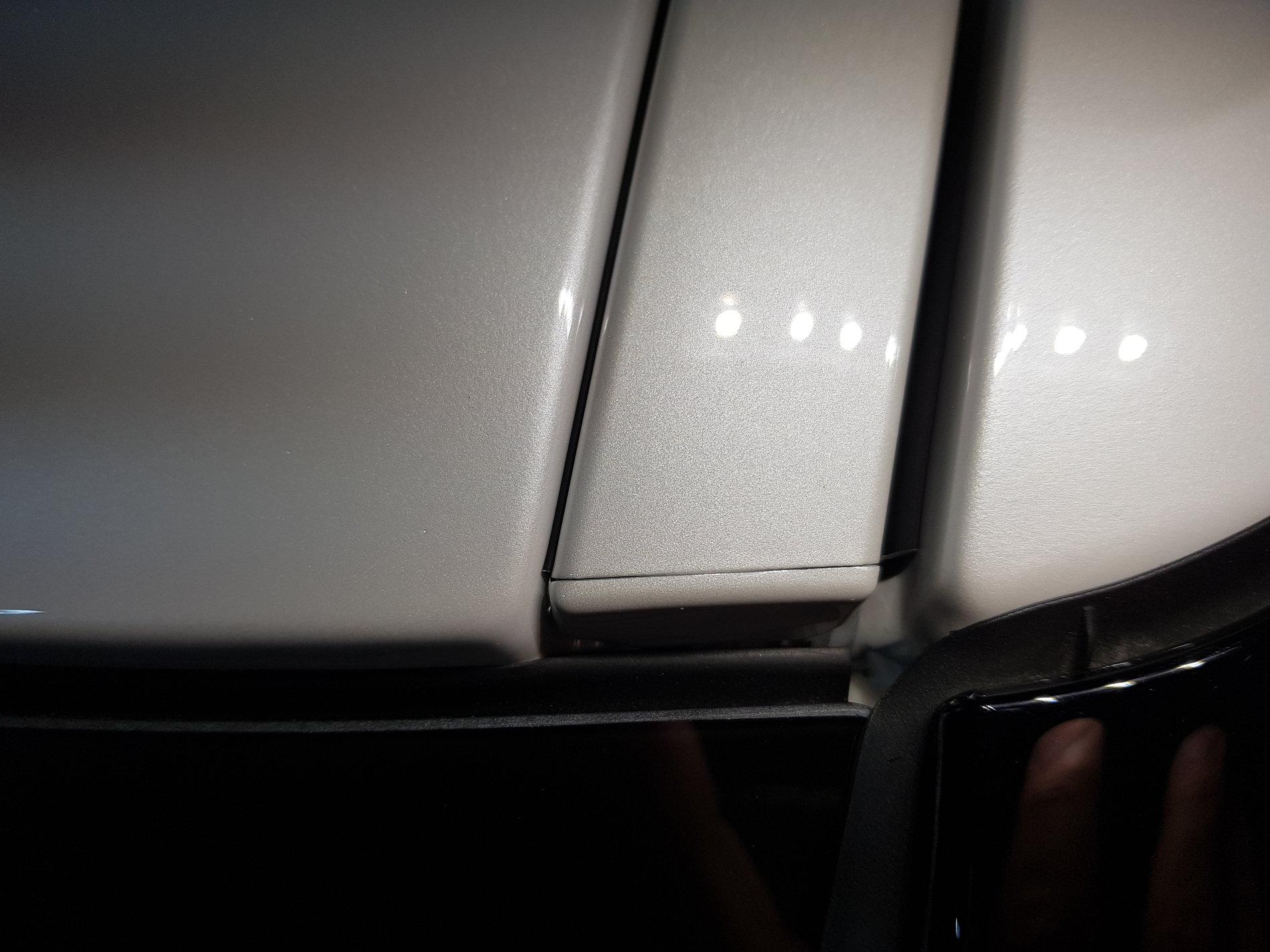

Here's another angle for pic 1.
holy crap. does the film end there??? that's quite unacceptable
pic 2, it can be wrapped. They stretch it and meet them in the end. if not they can make a small cut to relieve the edge. I think they cut it too far or after the application it moved.
pic 3. no wrap on my car yet see pictures
