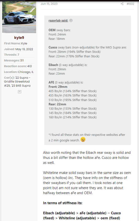

aFe is 29mm at its stiffest setting and 195% stiffer than stock.
Cusco is 28mm non-adjustable and 194% stiffer than stock.

Yeah, I skipped Eibach since they didn't publish their torsion rates. :dunno:

Well as a data point, I have been running an Eibach FSB since last spring and it has been dead quiet. As in, I wouldn't be able to tell the difference between it and my old OEM bar in a blind test, aside from the obvious increase in stiffness.
