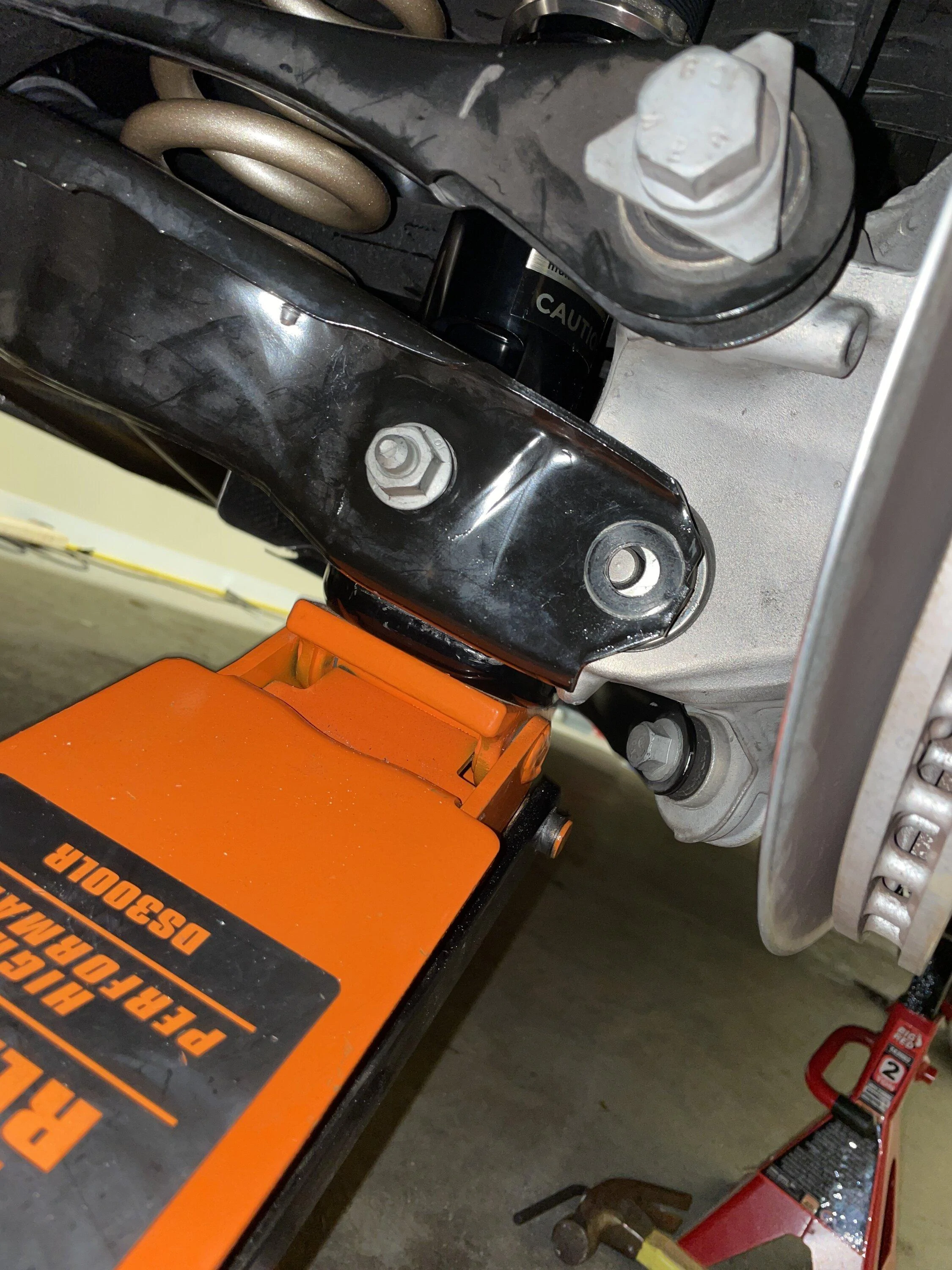

Hi all,
I have been in a real pickle trying to wrap up the install on some coilovers, no matter what I do the knuckle bushings is too far inside the rear LCA to correctly align the lca holes/knuckle for the Bolt to go through. Does anyone have any tips here? Perhaps loosening the LCA would help, or something? Thanks!

The knuckle/LCA bushing is a ball joint style so first make sure it's angled favorably. Use a floor jack to hold the LCA up. You can pull the knuckle IN or OUT to line up the bushing with the hole. Sounds like you need to pull the knuckle OUT board to line it up. Most people get tripped up on this because they are trying to line up the LCA to the knuckle. Instead, try the opposite and line the knuckle up to the LCA.

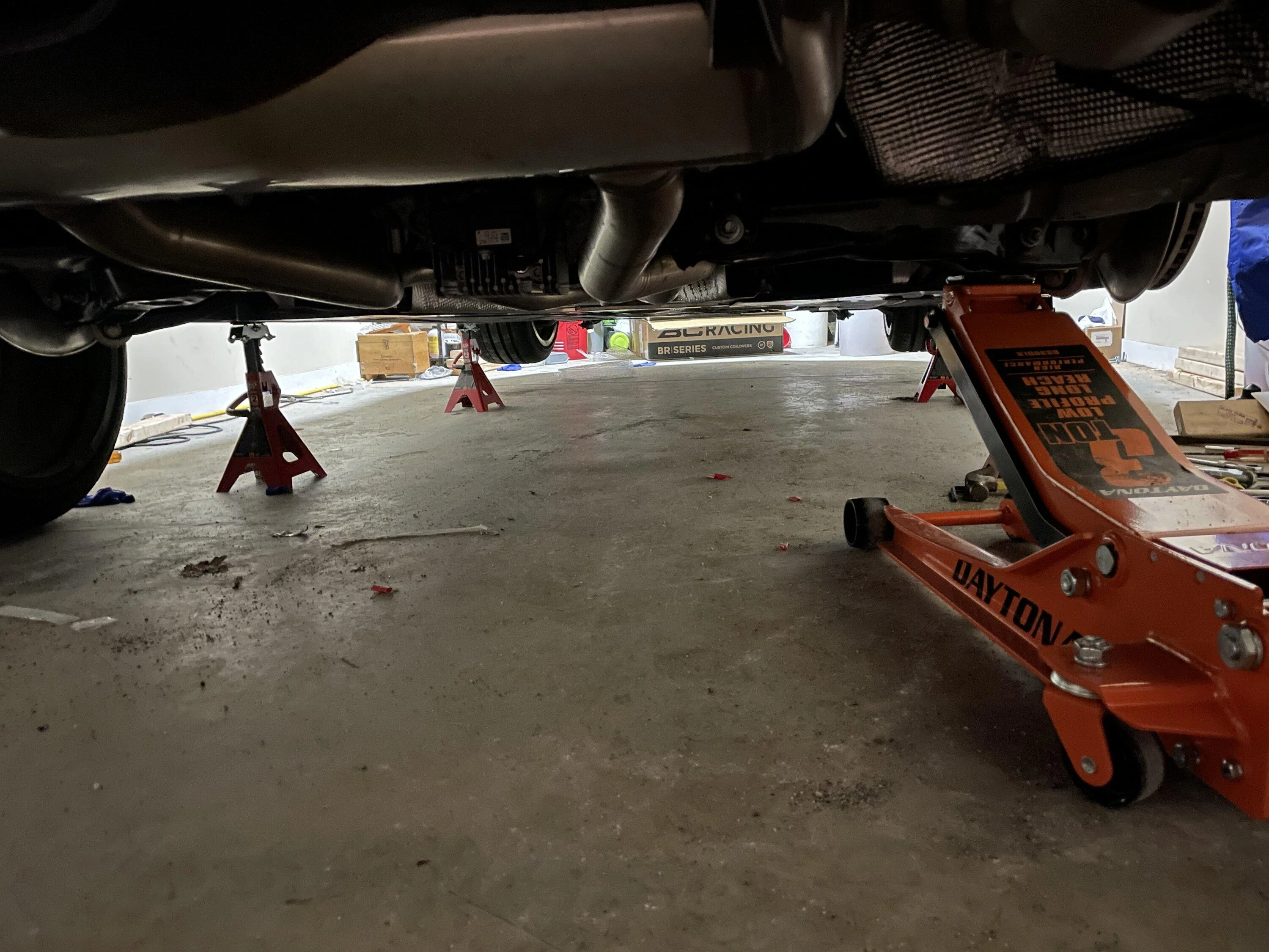

Can you take a pic of your setup? Is the car on jack stands? It is possible the sway bar is fighting you, but I suspect not. You may need to use another jack to raise the knuckle and retry at a different mating angle.

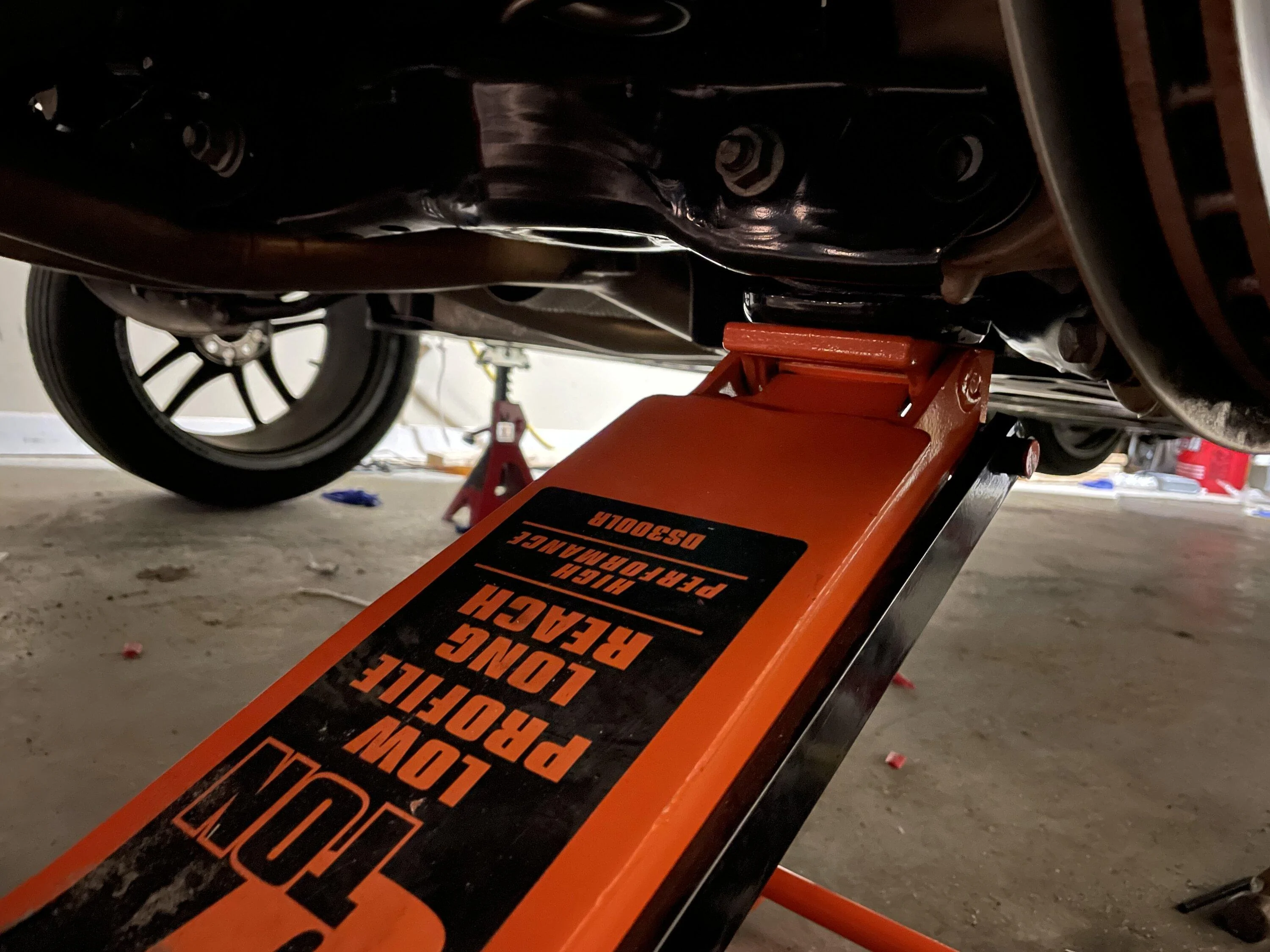

The car is on 4 jackstands, i only have 1 jack, and it is under the LCA. i currently have a steel punch in the hole to attempt to keep everything lined up, but as soon as i screw/hammer the bolt in further it just falls out, the bolt misses and the bushing misaligns again.
