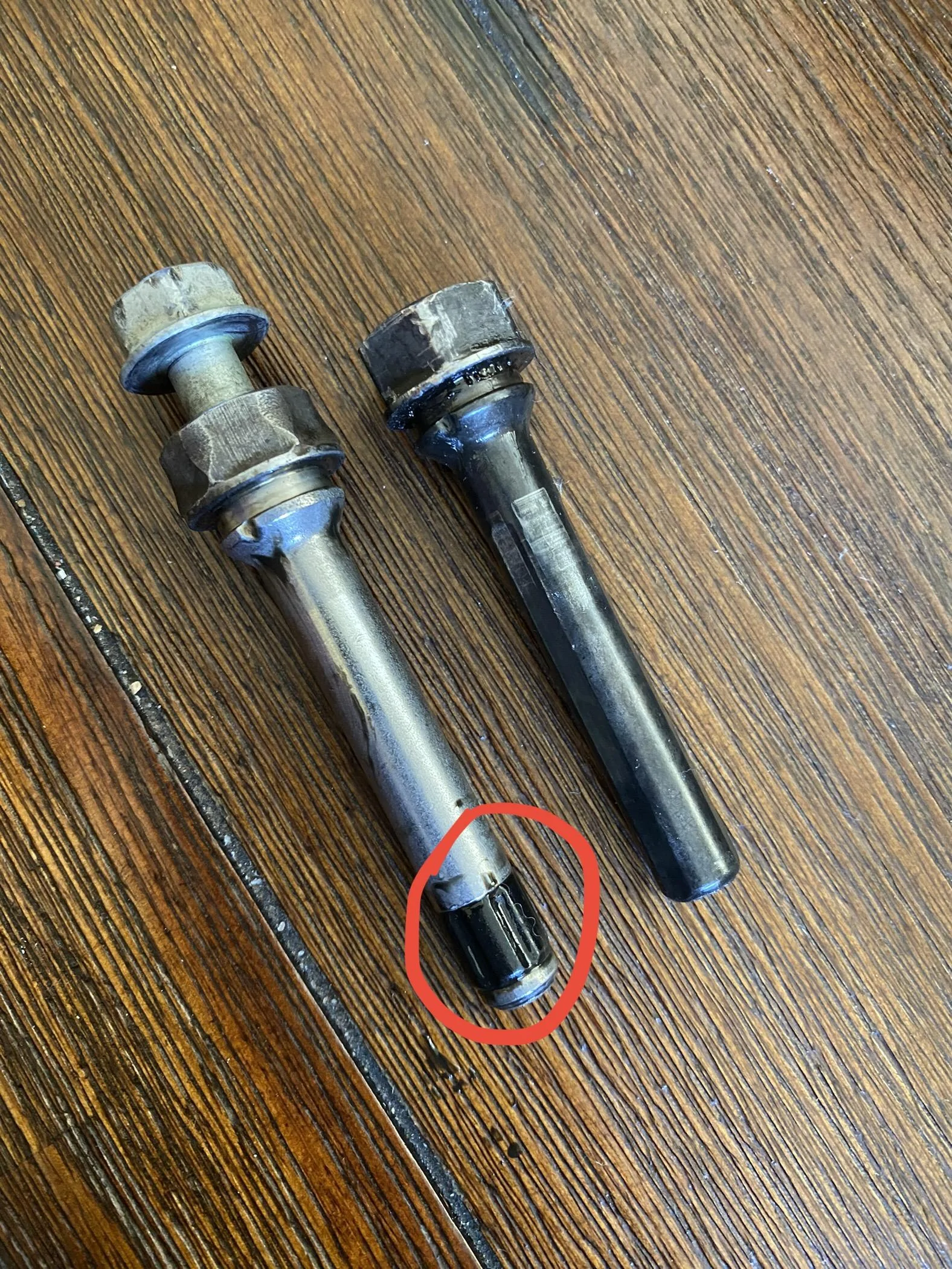

Does anyone know the part number for this? It goes on the rear caliper and I can’t seem to find it anywhere on Toyota’s parts website

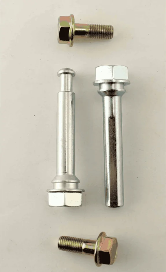

I believe it is 47775WAA02 Disc Brake Caliper Pin Boot (Rear) but don't quote me on that.

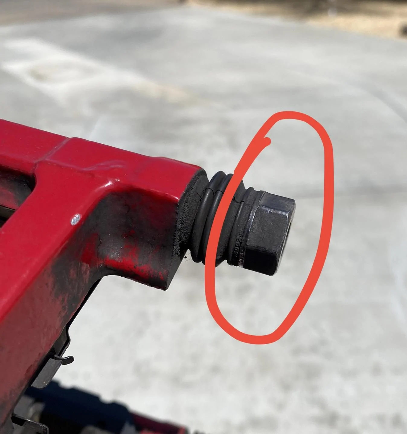

That’s what I thought too. It’s just the bolt and the rubber that covers the slide pin. Turns out the part I’m looking for isn’t sold separately. It comes with the entire caliper bracket

You are confirming you have used that?
No, but I'm totally confident in it being the kit OP needs. I did some digging on this earlier today, and also concluded that BMW/Toyota doesn't sell the slide pins a la carte, and this was one of two compatible kits I came up with while doing reverse BMW cross-referencing.

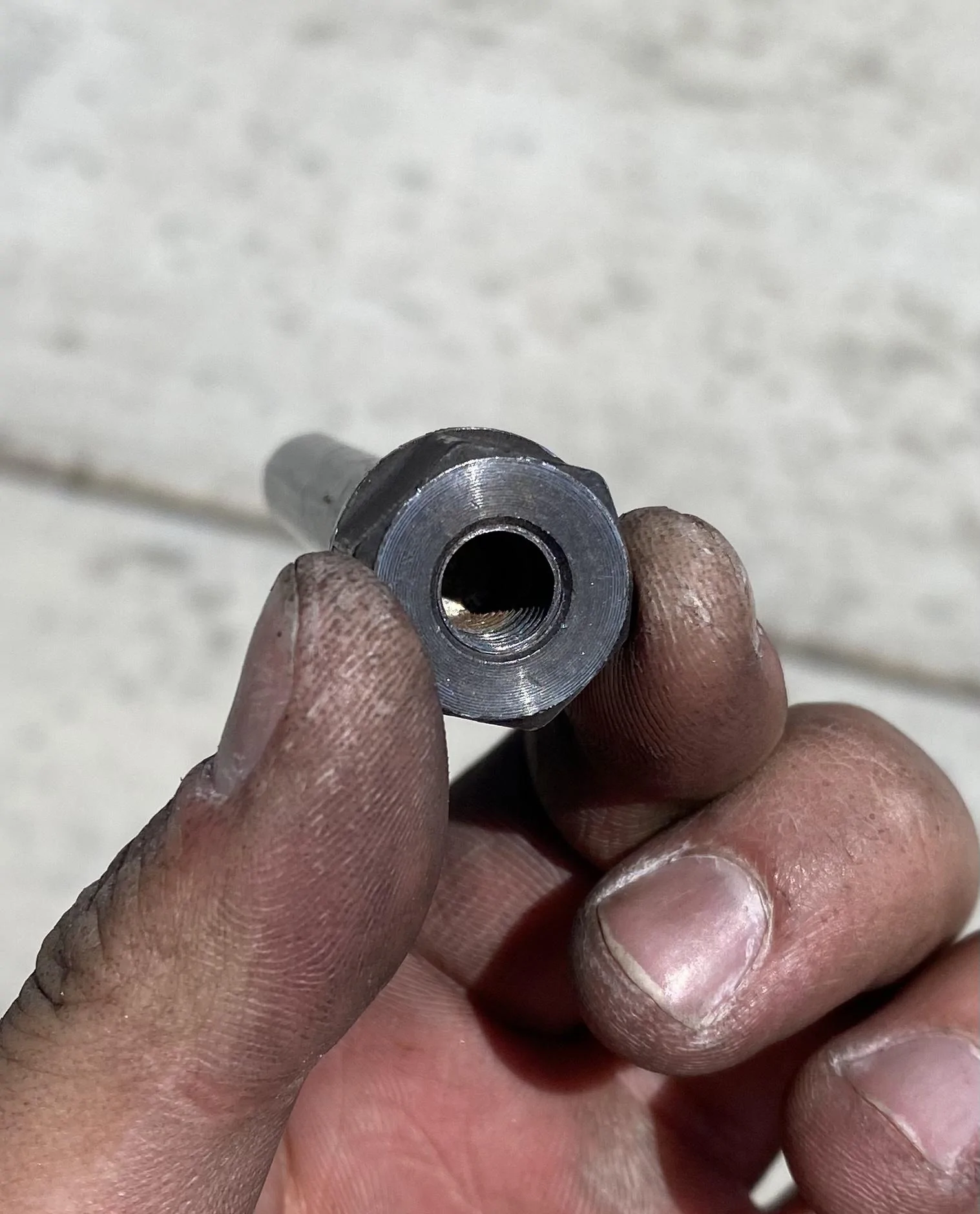

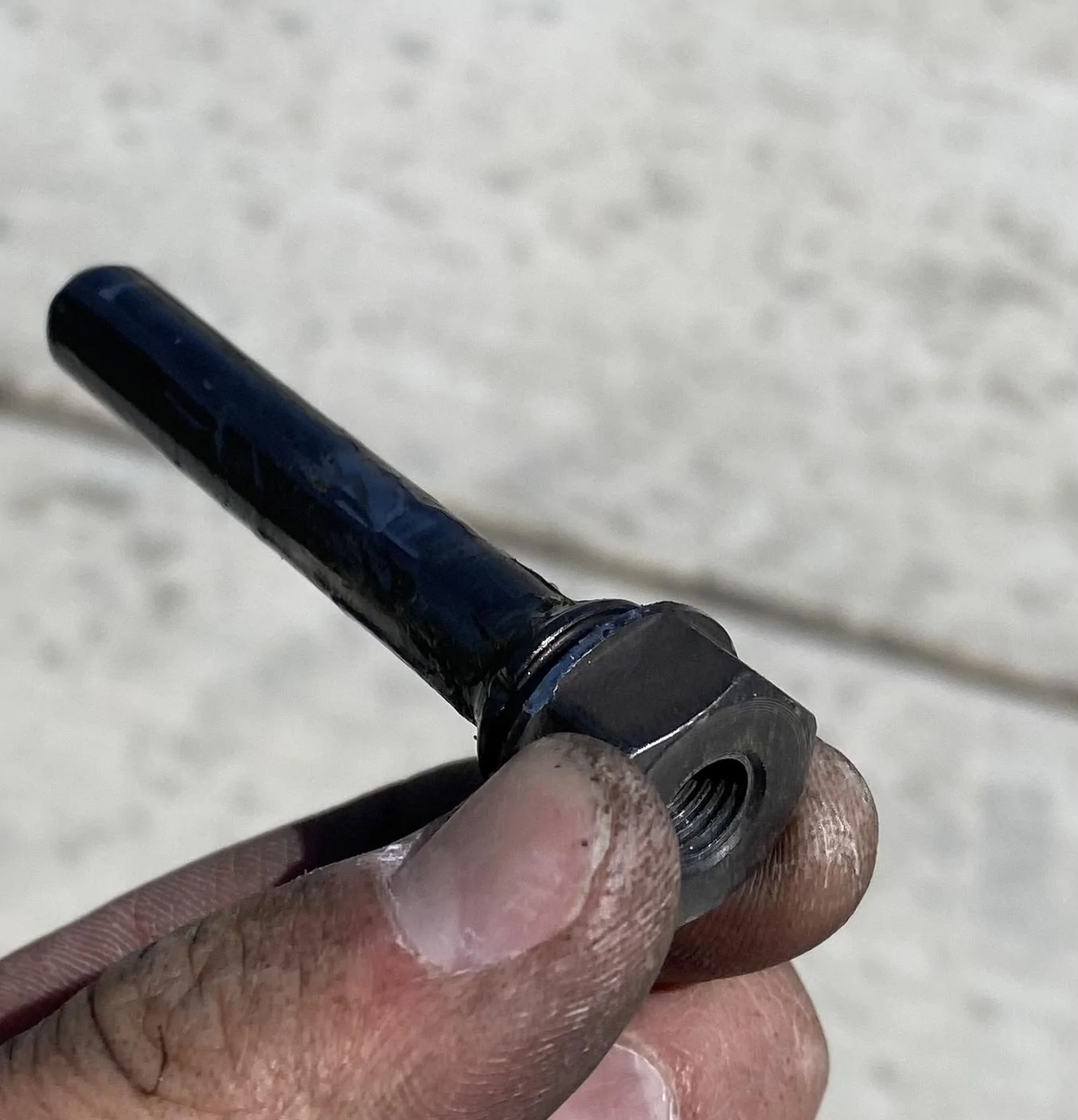

Thanks for the help guys. I believe you’re both right. I just need to replace mine because for some reason, as I torque the caliper pin bolts to spec, the guide pins get stripped so easily. I’m not cross threading them either since I thread them in by hand before tightening.
It appears that the bottom pin has a rubber portion. Do you think the Carlson part comes with that?
