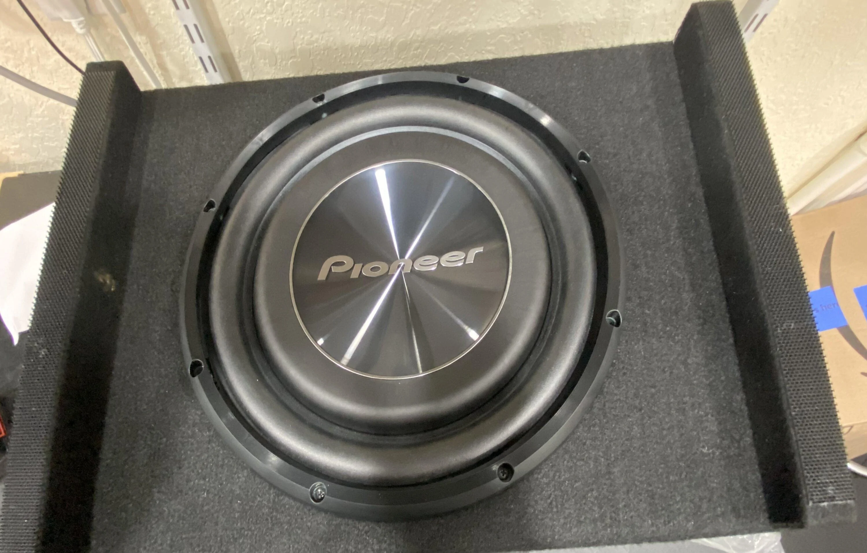

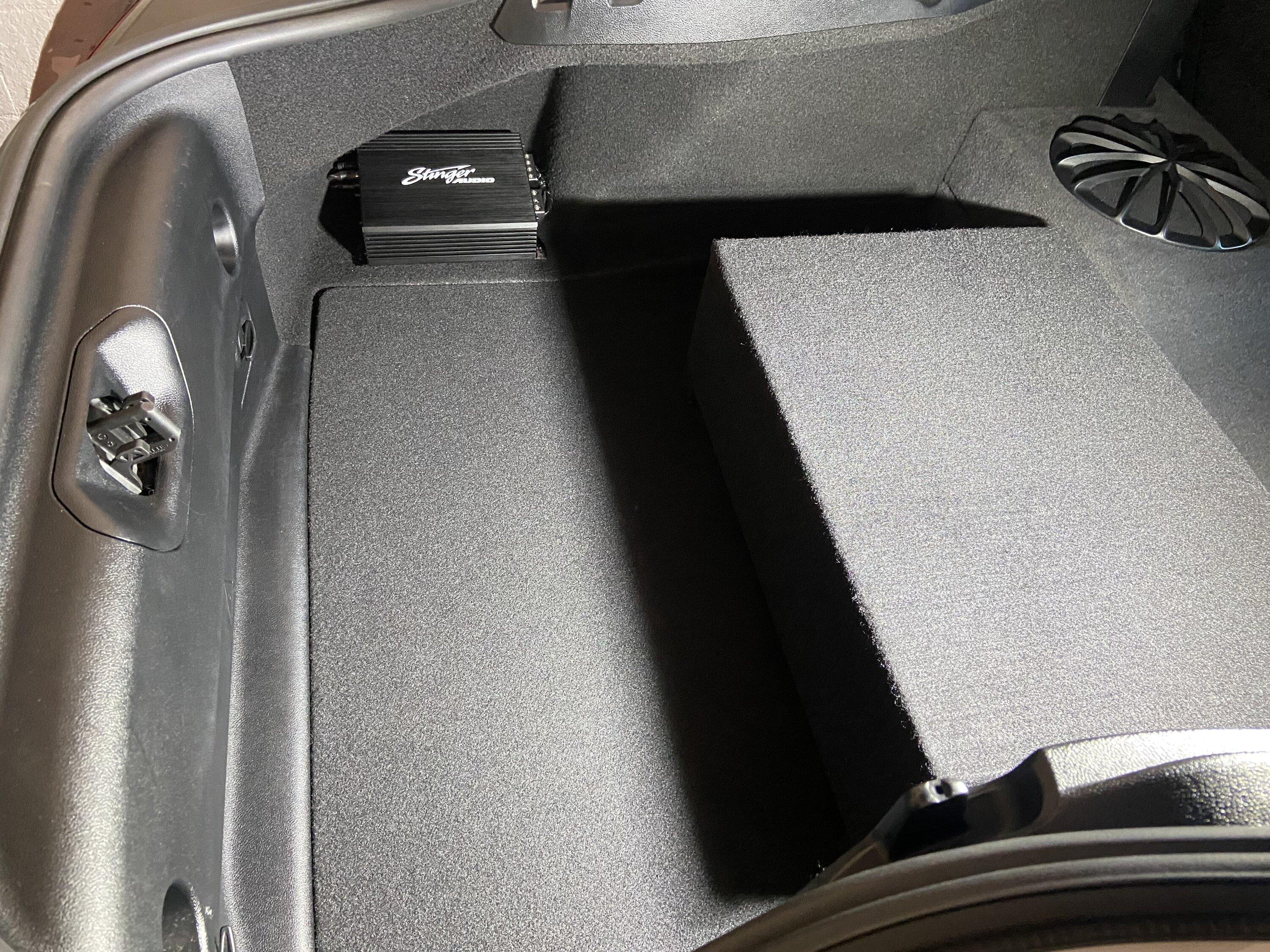

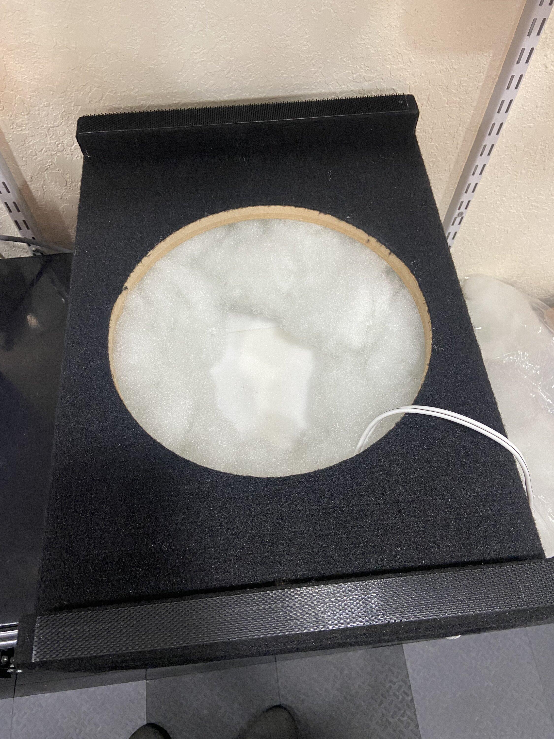

Hoping this will help other members out. Well I tried the standard port addition upgrade without much success. I wanted a subwoofer that could hit hard and loud,, not break the bank, doesn’t take up too much space and could be easily removed for track days. So I did some research, spent $350 and 4 hours and can’t believe how amazing this subwoofer sounds. Very easy to duplicate and everything came from Amazon. I used Velcro to hold the box and amp in place.
Atrend Bbox 12AME 12-Inch Single Sealed Shallow Mount Downfire Enclosure, black (12AME*) https://www.amazon.com/dp/B01BXE8ZW6/ref=cm_sw_r_cp_apip_7zyWBh2Ohy2E1
PIONEER TS-A3000LS4 12" Shallow-Mount Subwoofer with 1,500 Watts Max. Power https://www.amazon.com/dp/B082FQRDKS/ref=cm_sw_r_cp_apip_yNk8SqrduuZE6
Stinger Audio MT7001 Monoblock Class D Mosfet Power Supply Amplifier with Remote Subwoofer Level Control,700 Watts RMS. https://www.amazon.com/dp/B0BMVXC6HZ/ref=cm_sw_r_cp_apip_IbxJFVd7iaDSw
PAC SNI-35 Variable LOC Line Out Converter 1.2x6.25x5.9 https://www.amazon.com/dp/B001EAWS3W/ref=cm_sw_r_cp_apip_TLwZalFspLwzy
Scosche Install Centric ICAK8 True 8 Gauge Hybrid OFC 2-Channel High Current Amplifier Wiring Kit Complete Car Amp Kit Twisted Pair Audio Cables, In-L https://www.amazon.com/dp/B08FRT6CL9/ref=cm_sw_r_cp_apip_iVWCgUuRdKcvO
Fairfield The Original Poly-Fil, Premium Polyester Fiber Fill, Soft Pillow Stuffing, Stuffing for Stuffed Animals, Toys, Cloud Decorations, and More, https://www.amazon.com/dp/B004ALQ0M2/ref=cm_sw_r_cp_apip_KMamhmIOHJB59
VELCRO Brand Extreme Outdoor Mounting Tape | 20Ft x 1 In, Holds 15 lbs | Strong Heavy Duty Stick on Adhesive | Mount on Brick, Concrete for Hanging, 3 https://www.amazon.com/dp/B09BNPHCZX/ref=cm_sw_r_cp_apip_h3yCf6bj8OIpl

How do you get it wired up and tied into the factory system?

By tapping into the signal for one of the other speakers by the looks of it. Power. Ground. Done.

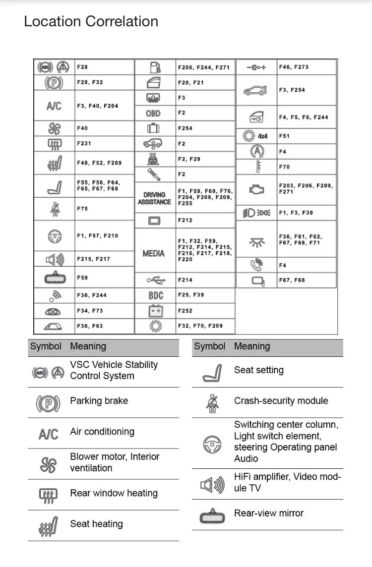

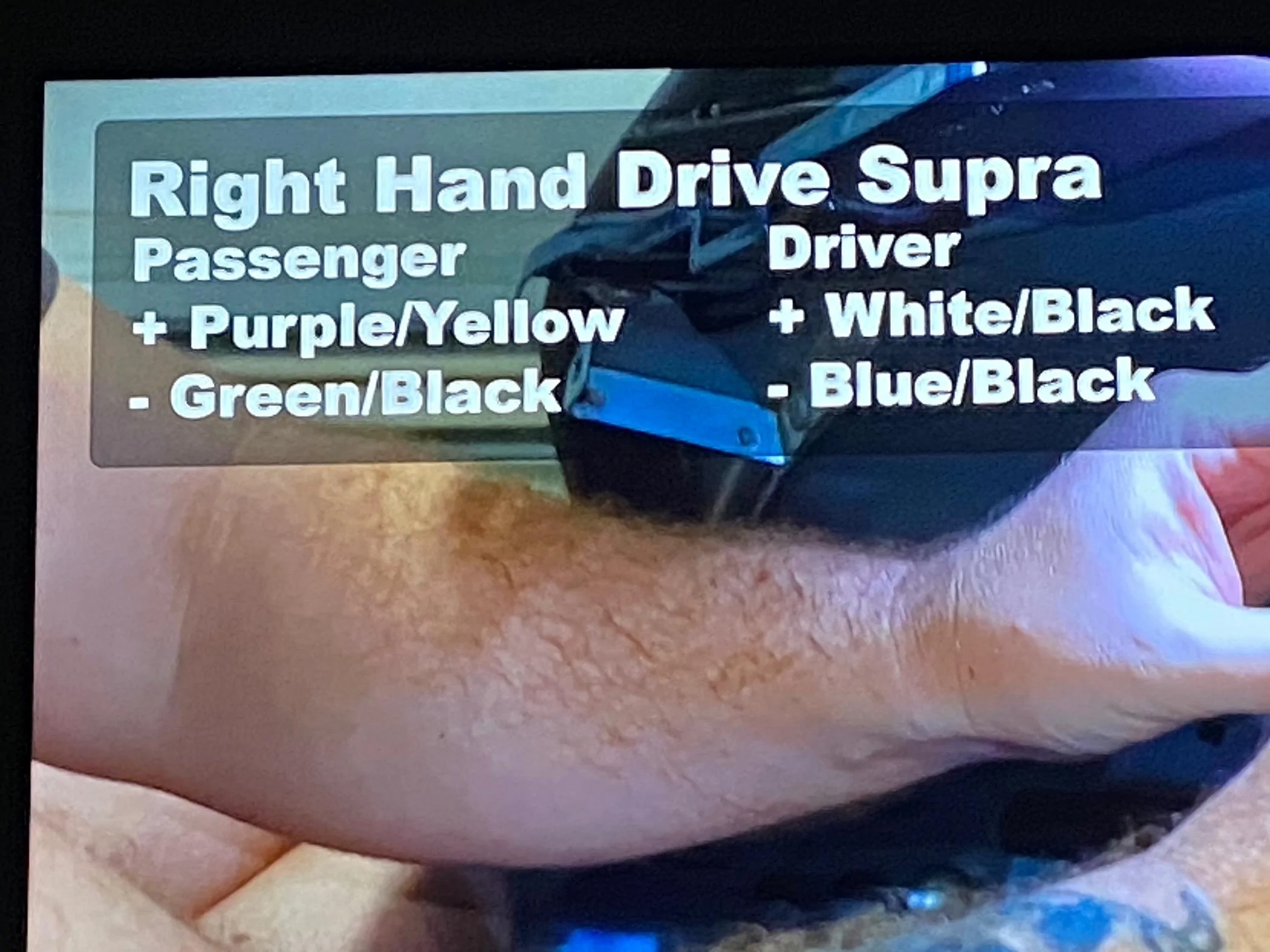

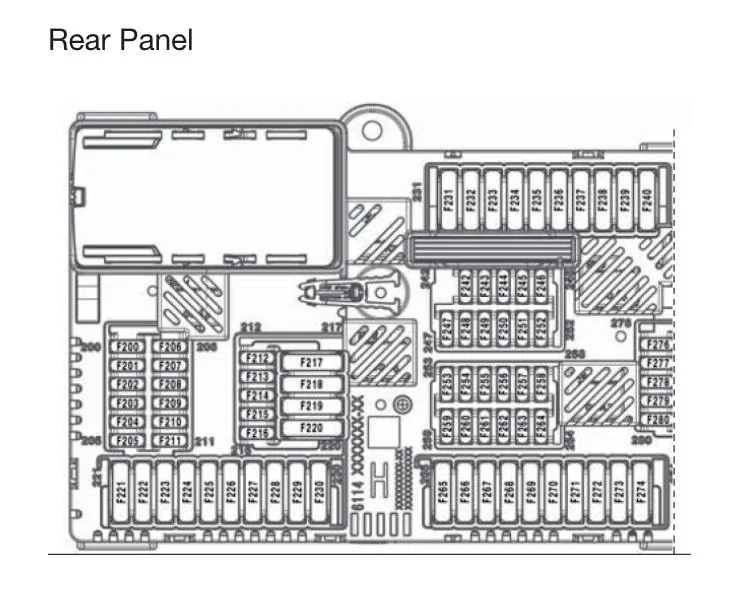

For the input bass signal I tied the Line Out Converter into the speaker wires exiting the oem amp on the drivers side rear in the hatch area above the rear tire well. I have attached the UK wiring diagram. Remember for the US the Passenger and Driver sides or opposite.
For the amp remote signal I tied into the rear fuse box (fuse F215) diagram attached.
Amp power, used the 8-gauge (50 amp fused) supplied with the wiring kit directly to the oem battery.

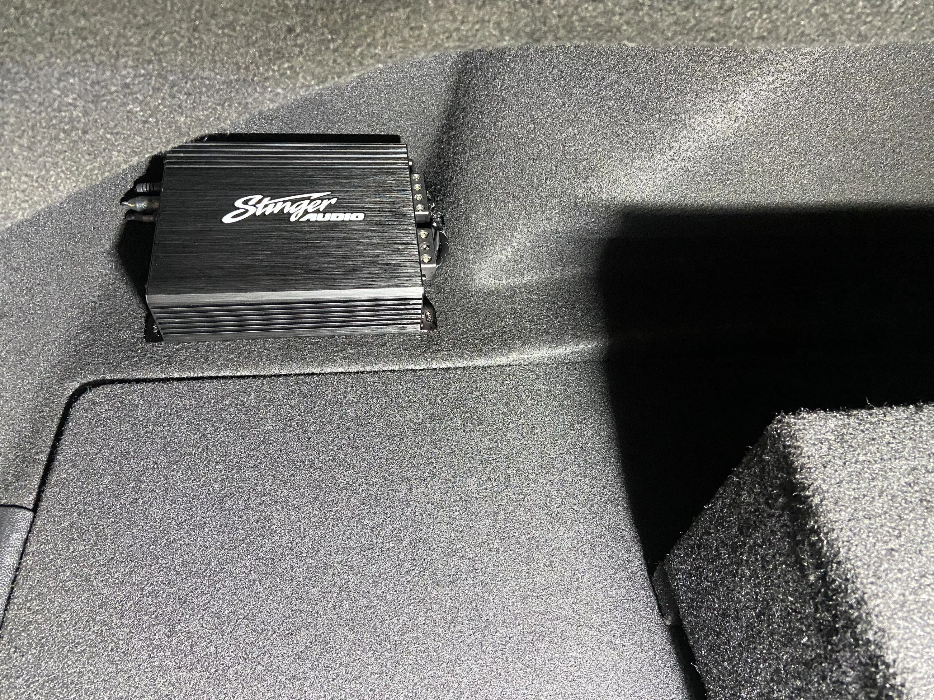

I might dive into an upgrade here. Im thinking the lid to the box could stand to come up 12-16" then you could turn the subs to the rear at that point with a clear center piece housing the amp. not sacrificing precious cargo space.
suprastew
suprastew
Gary
Feb 12, 2024
Tampa, FL
2020 GR Supra
I definitely understand the storage concern. The box could be modified to house the amp. There was also space for this small powerful amp next to the battery underneath the cover, but I didn’t feel comfortable with it there. Storage space is not a huge concern for my use since this is my weekend cruise, track, stress relief car.

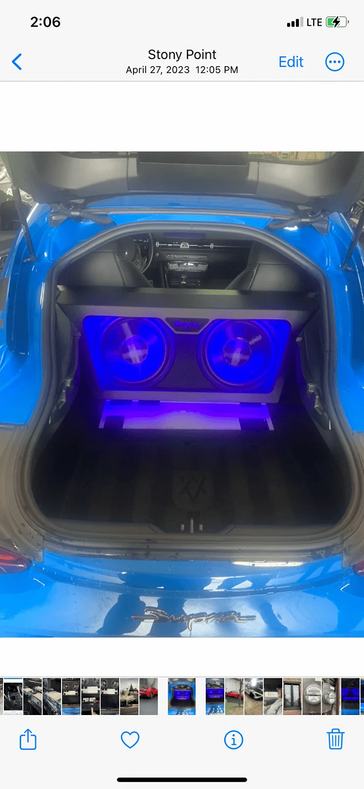

Sam B
Sam
Jul 5, 2021
31
367
270
Northeast PA
2021 Supra

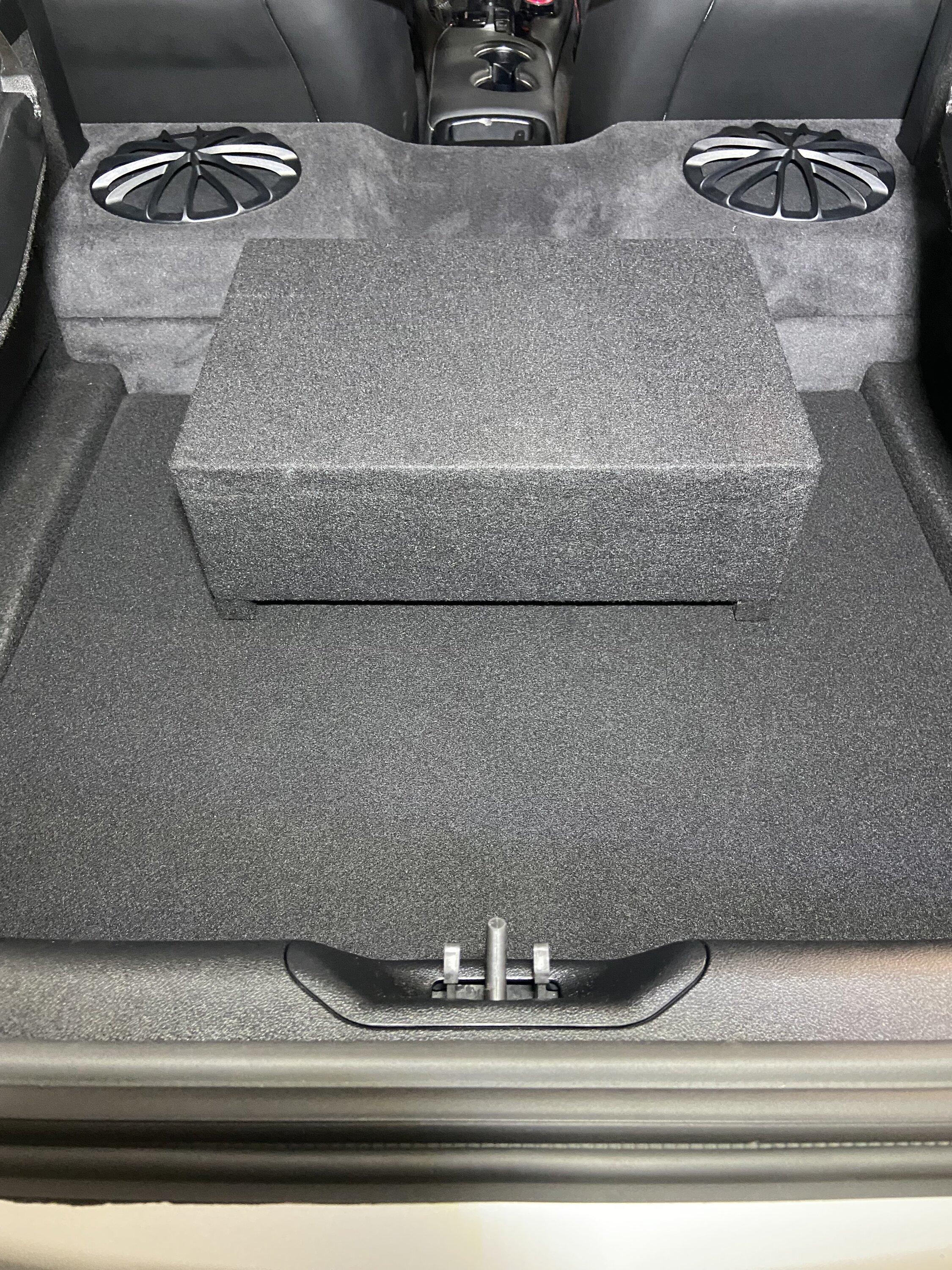

You can build an enclosure either on top of yours, or remove yours. I’ve done both now. This one is after removing the old box completely. Don’t try and reuse your box in any capacity, you will be disappointed
Good luck. It’s doable
