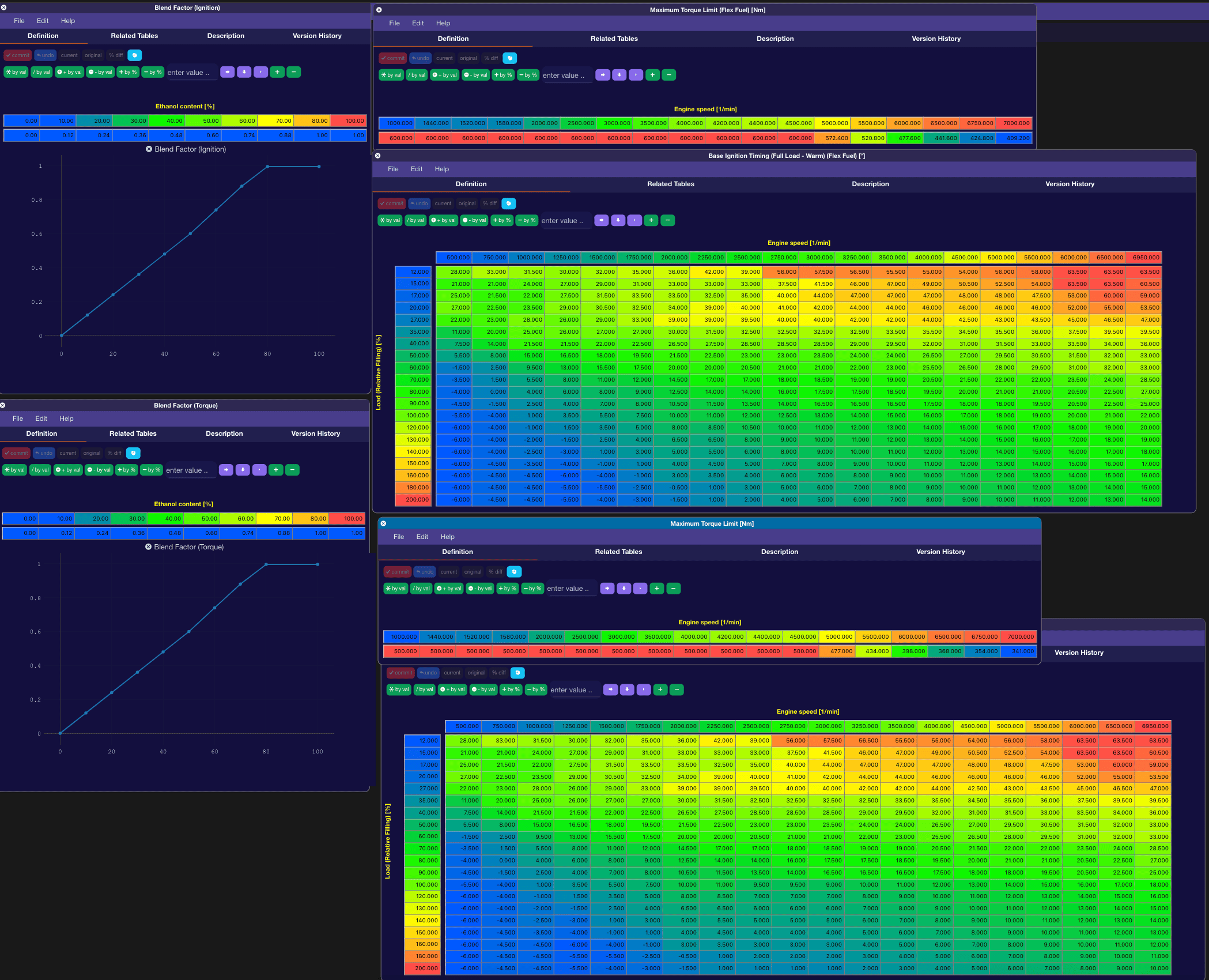

So here is a visual example of what I was explaining above. I will be purposely ignoring all ignition/torque compensation tables and stock fueling limits for this example to make it more simple.
This first example has the torque and ignition interpolation tables set so that the flex fuel ignition and torque tables are being used 100% when the ECU detects E50.
So let's say the car is at 160 load at 6000rpm, on E50. It will be running 14* of timing. Exactly what is in the Flex Fuel ignition table.
Now let's say the car is at the same 160 load at 6000rpm, but there is E25 in the tank. That will make it run 50% between the Flex Fuel ignition table and the pump gas ignition table. It will be running approx. 12* of timing.
This second example has the torque and ignition interpolation tables set so that the flex fuel ignition and torque tables are being used 100% when the ECU detects E80.
The ECU will have to detect E80 to run 100% of the Flex Fuel ignition table. If the car has E25 in the tank, it will be at 30% between the Flex Fuel ignition table and the pump gas ignition table, around 11* of timing or so.
If you do the same for the torque tables (which boost comes out of), then you can see the differences there as well.
My point is, it's really how the interpolation tables are setup and also how different the Flex Fuel ignition and torque tables are from the pump gas tables. YMMV.
