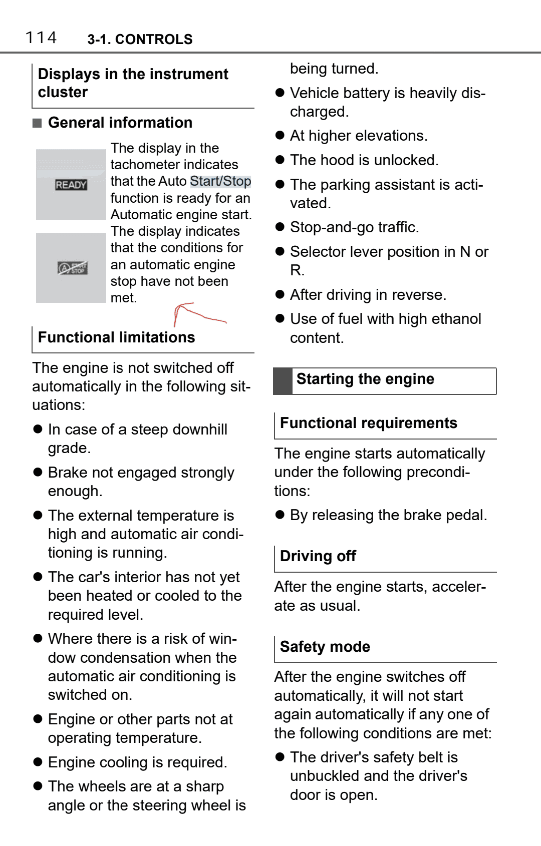

Also, as I understand it, when the icon has the slash through it, it means the feature is unavailable, not actually turned off. So, you would see that icon if the feature were on but not available. I believe it does this when the engine is cold and also in Sport mode (but don't quote me on that).
