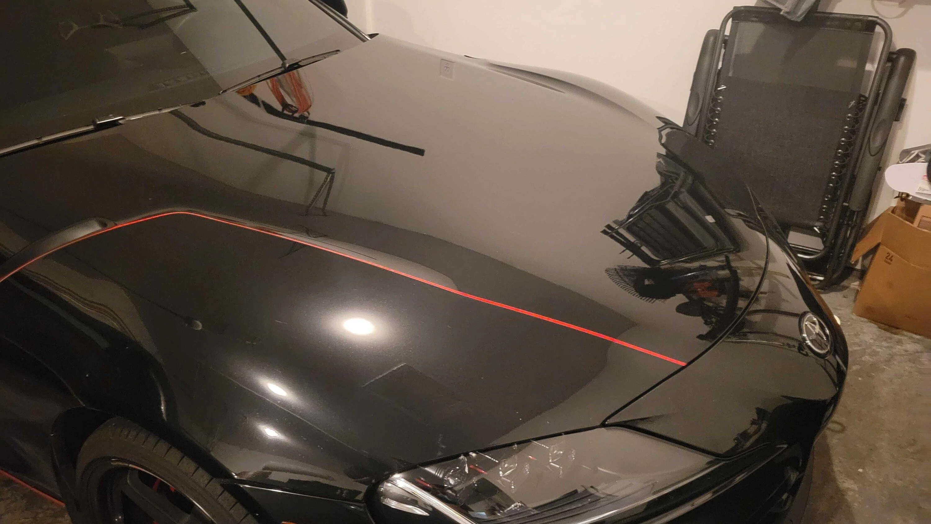

I've got Kavaca. Overall happy with it, seems to be better than the Suma Performance ceramic that I bought. I'd say it's worth it for $40 and the ease of application. I applied the Adam's Graphene around early Feb and here's a pic I just took a few mins ago. It rained heavy today for an hour or two and stopped raining by the time I left work so the natural airflow going over the car pretty much cleared all the water off the front and didn't leave any spots from it drying up. The sides of the car aren't quite as nice and clean but still helps. Car was last washed on the 11th.
