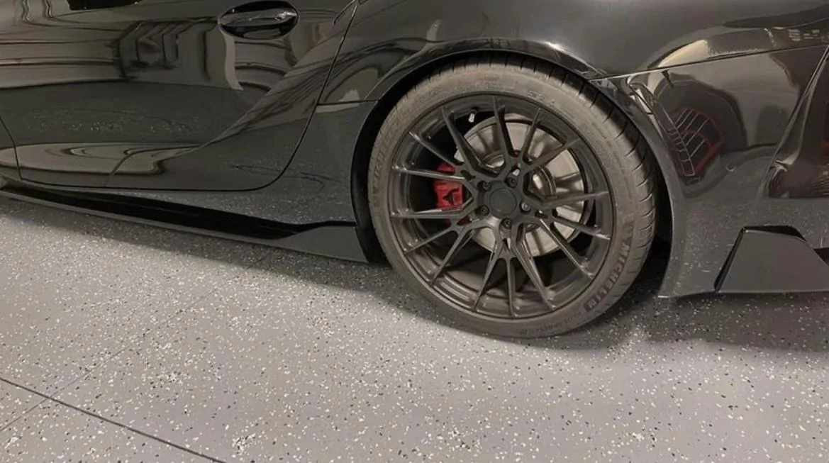

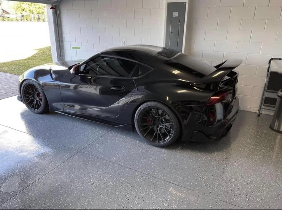

I was worried about the same, but in the pics of the seller's Supra it doesn't look too aggressive so I wasn't sure. This is from the listing:
He has no spacers and is on HKS springs.

I've never seen 11.5" on an A90. I wonder if the seller's setup came from a non-A90. I also didn't know you could do a 275/35/19 up front. It may rub a bit, but hard for me sitting here to say conclusively one way or another.

Pretty sure you’ll need the same HKS height-adjustable springs or a set of real coil overs to have the clearance to fit those wheels without spacer.

its not about ride height. Those particular springs(or coil overs) increase the clearance on the strut side of the wheel and allow you to run a wider wheel without a spacer.
on stock springs you won’t have as much space behind the wheel (the springs physically stick out further) and you’ll need to add spacers
 then your wheels will poke and not look like they do on your friend’s car.
not 100% sure but I haven’t seen anyone run that setup on stock suspension, so very likely you need the extra clearance from coil overs

Ahhh okay, I’m following now. Sorry, relatively new to modifying suspension and wheels so I appreciate you explaining that. It definitely makes sense.
I’m supposed to meet up with him tomorrow to take a look at the wheels, however if I’m going to need spacers just to clear then you’re right, I’ll probably pass as the width is already aggressive enough.
