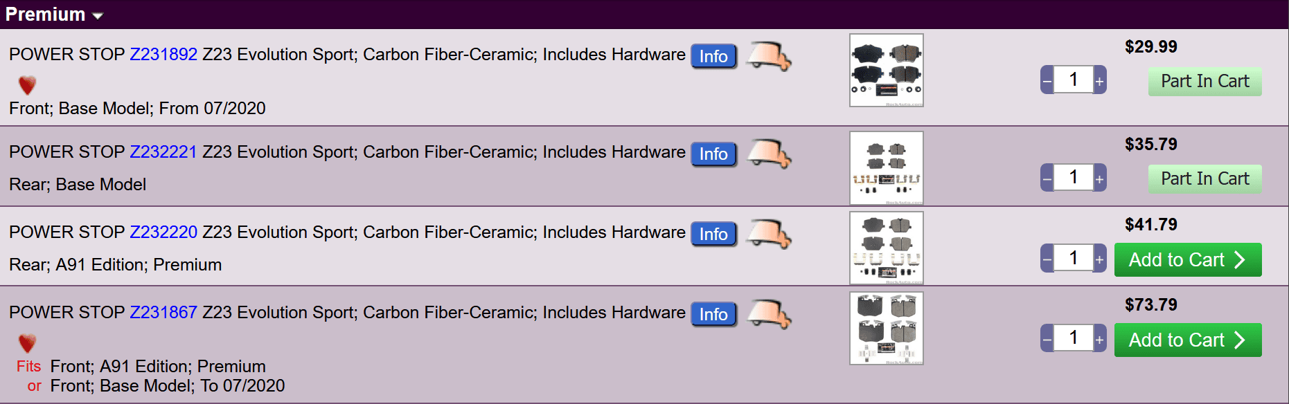

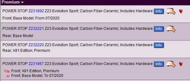

Hey everyone,
I am looking at RockAuto's website at the Z23 brake pads and am a little confused. As far as I know, the front brakes on the base are the same as the premium however, the only difference in the rears is that the rotor is 330mm for the base and 345mm for the premium. Is that correct?
Also, RockAutos website is the only site that shows a difference in base/premium with the "From 07/2020" verbiage.
Did the base rears from 2021 model year and up stay with the same rear rotor as the premium?
Which pads will fit my 2021 (manufactured in 11/2020) base 3.0? I assume the Z231892 for the front and the Z232221 for the rear?
Any help is greatly appreciated!

You'll probably need smaller pads. I needed smaller pads from Endless when I ordered MX72s. 2.0 rears will probably work for you.

Thanks but not looking to purchase $550 brake pads..

Per their website, the Z231892 is clearly different looking than the Z231867.
