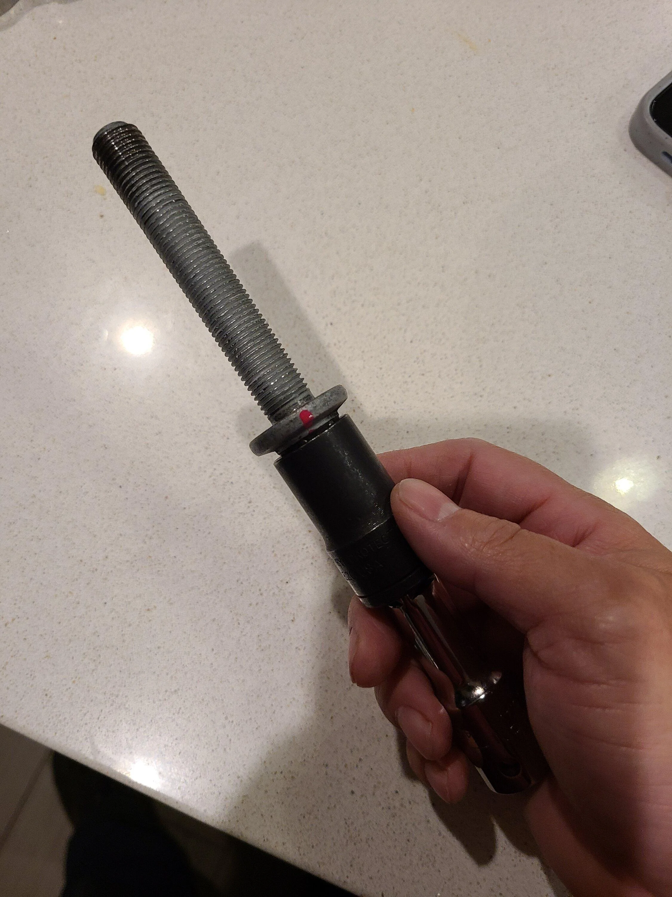

If you already have the bolt half way in, grab a deep socket and put it on the bolt head. Then grab the socket with your hand and use the leverage of the socket to angle the bolt into place, lining it up with the second half of the LCA. Again the bushing is a ball joint style so it will articulate.
so use a socket larger than the bolt head or smaller, i tried using a the etorx for the bolt and it kept slipping off.
Use the correct size E-torx. You could use a small extension if you don't have a deep. (I guess I didn't have a deep either) My socket fits snug on the bolt. Allows me to maneuver the bolt into the correct angle.
