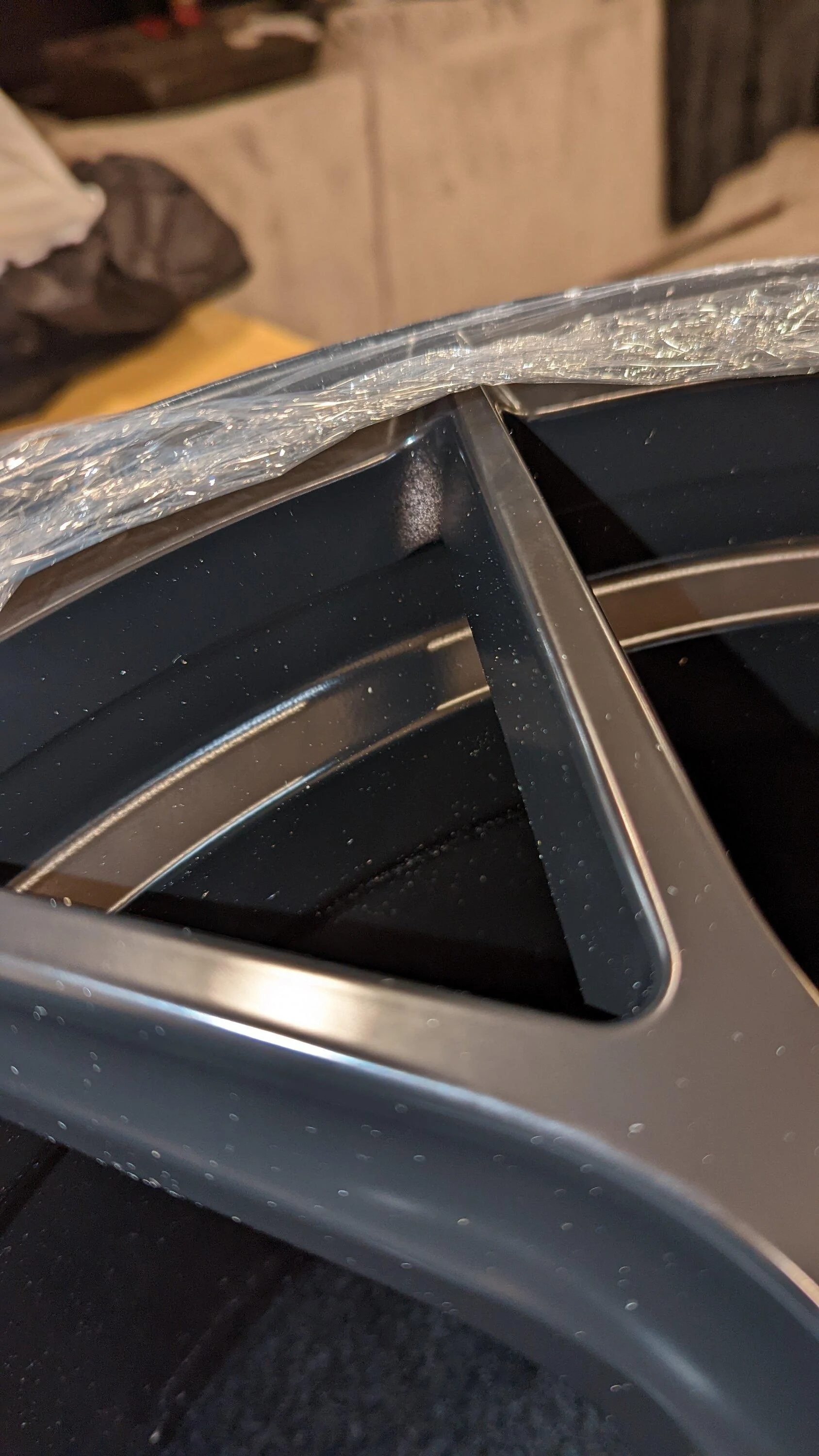

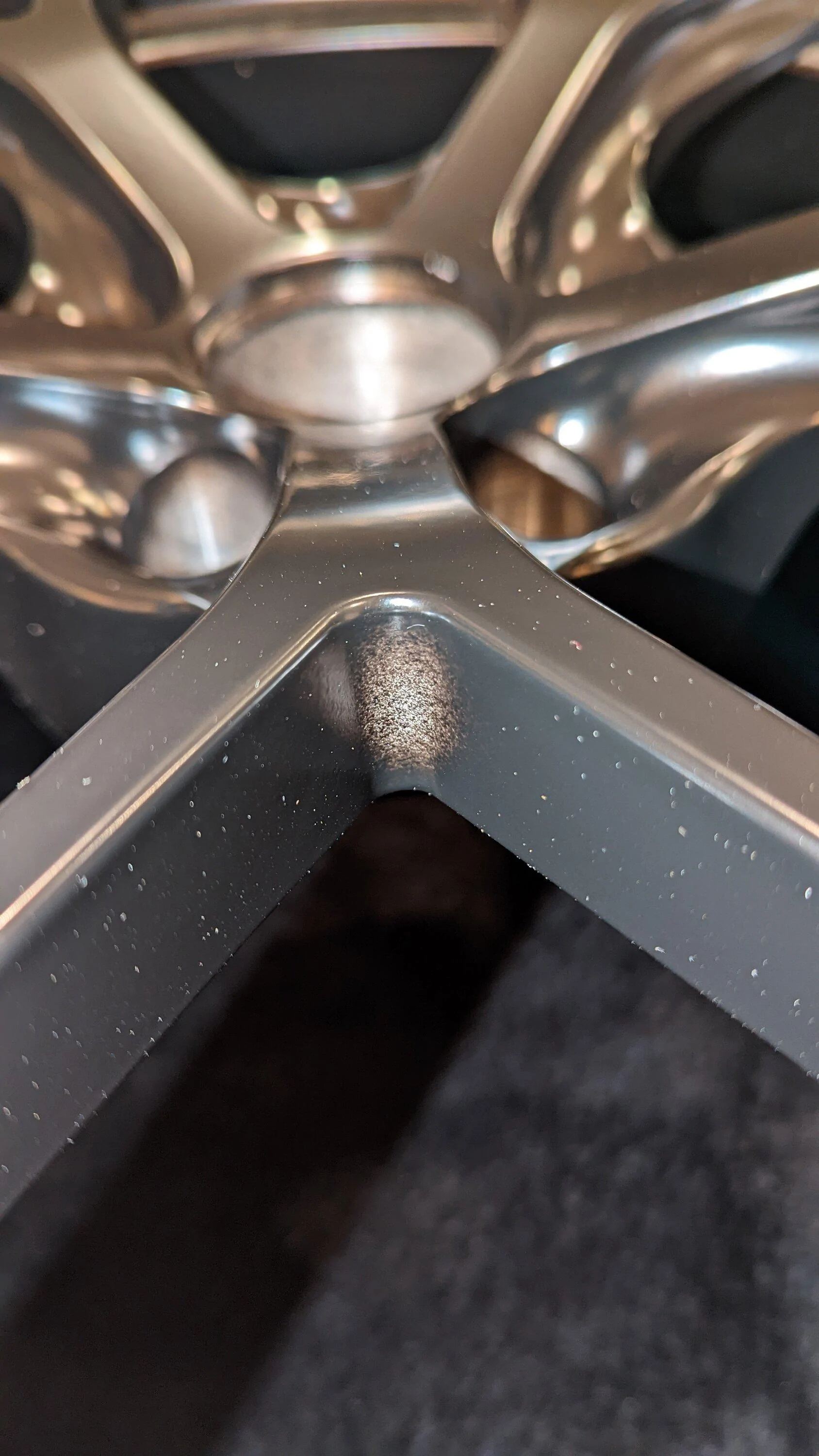

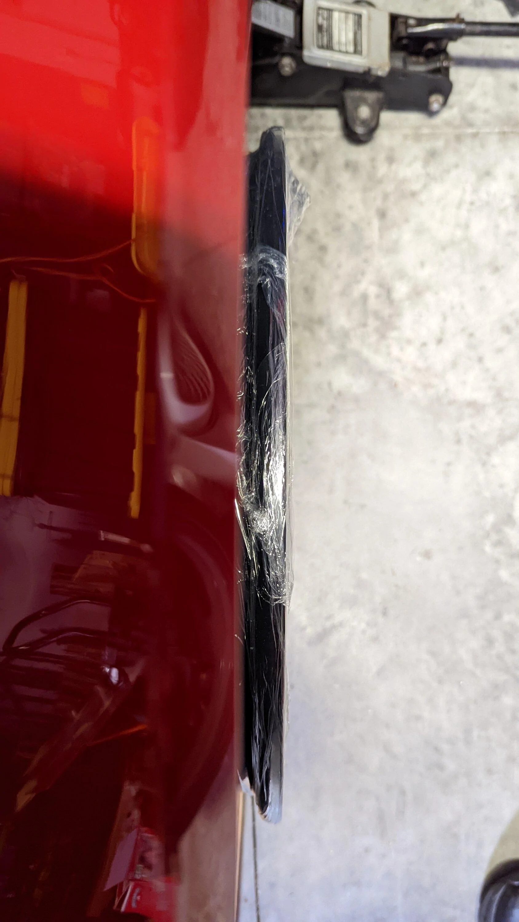

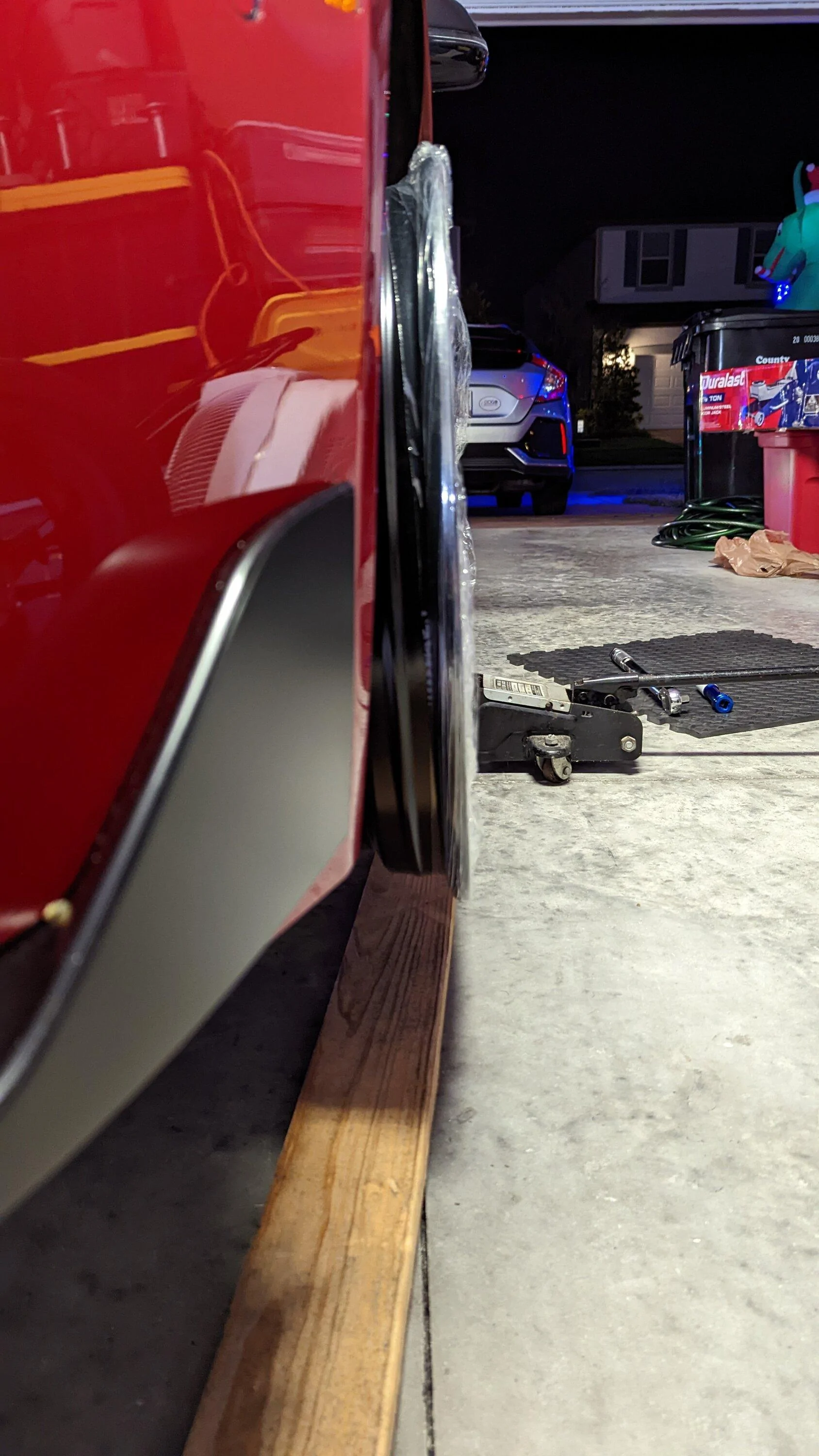

So I just purchased a set of matte black MRR FS06 wheels. I was reassured by the rep at Audio City that MRR knows the proper flush fitment for a Supra, as they've had a couple Supra "sponsored" cars with this exact wheel. As you can see from the pics there are two major issues. The front wheel offset is way off, and poke out at almost an inch past flush with fender. To make it worse, there are multiple missed spots in the powder coat in various corners of the wheels. I will be contacting Audio City to hopefully resolve it, but I've heard it can be a nightmare getting replacements.

Thats for sure is not stock body fitment

The wheels should tuck a little when your suspension is compressed. Hard to gauge fitment with suspension at full drop like that. Still looks like the offset is incorrect but I’d jack up a wheel and see what it does as the suspension is compressing, they may pull in quite a bit, but your camber would still likely be off. As far as the powder coating, that’s a really poor job…what a bummer!

Typical Supra front fitment is around a 19x9.5+22 so anything below that like a 19x9.5+12 or something is too much.

That’s pretty normal fitment. I think your issue is you have the car raised with the suspension at full droop.
Thank you! I knew there would be some poke out at full droop, but I didn't realize how much it does it on this car. Appreciate the verification
