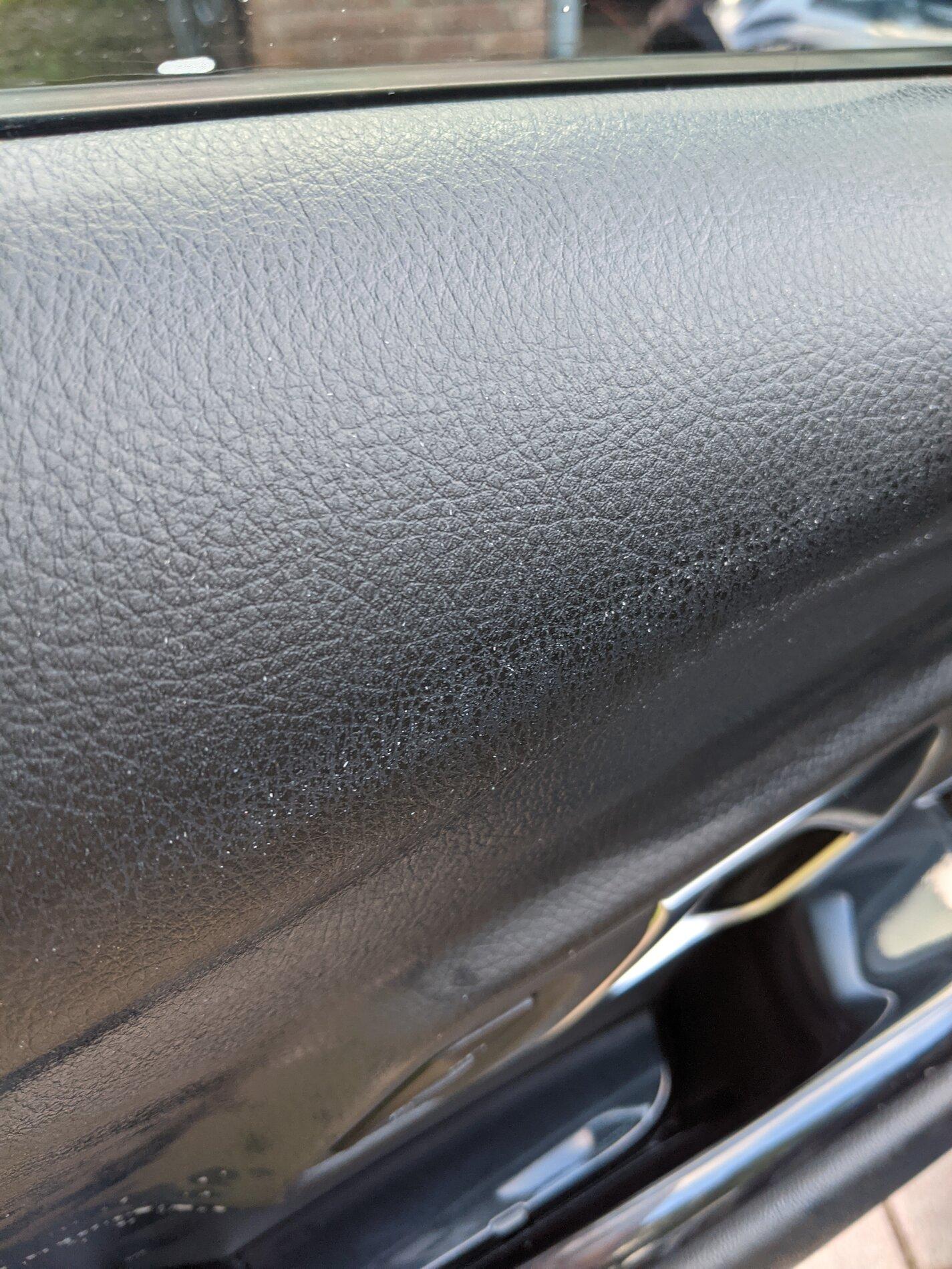

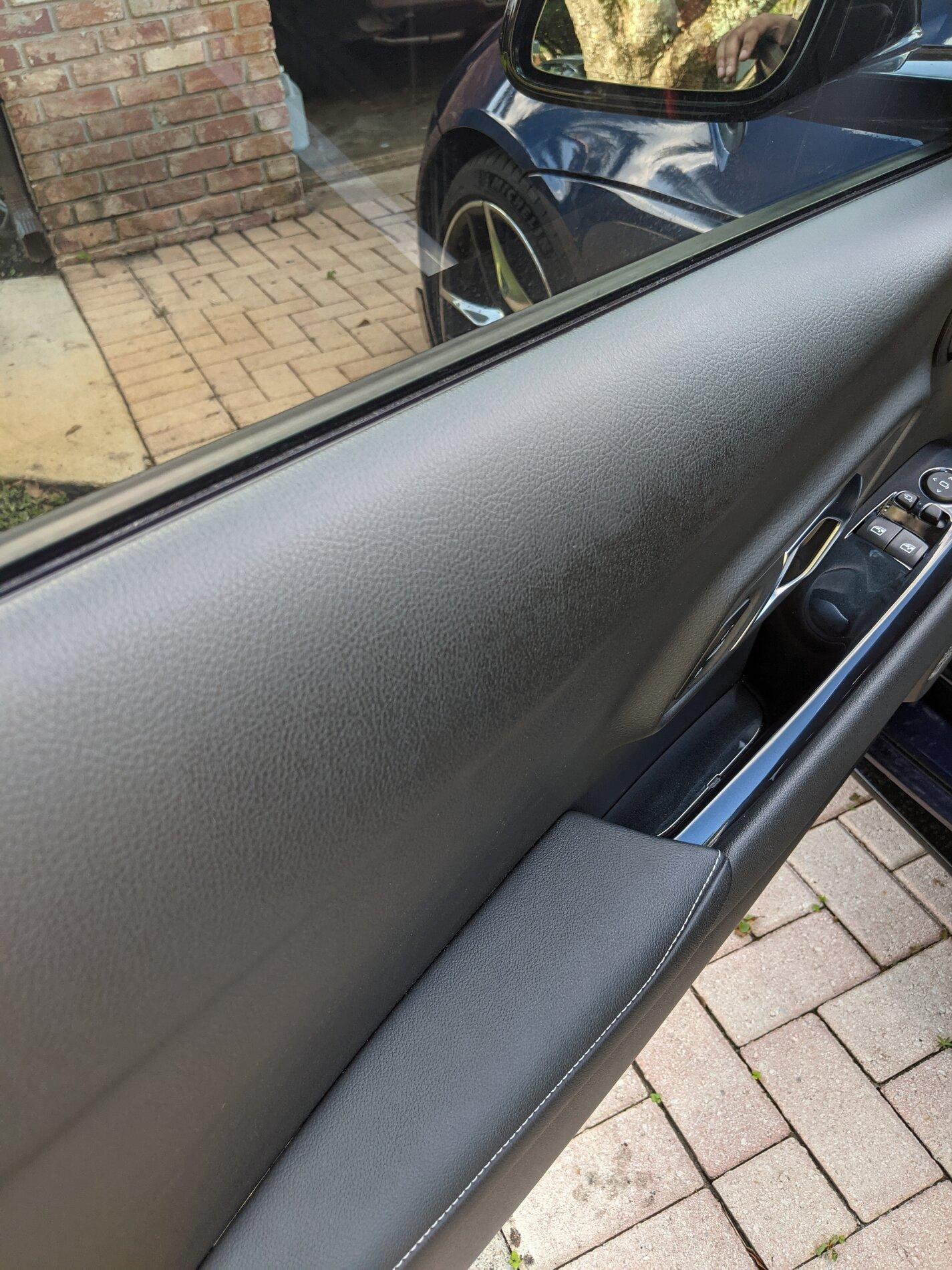

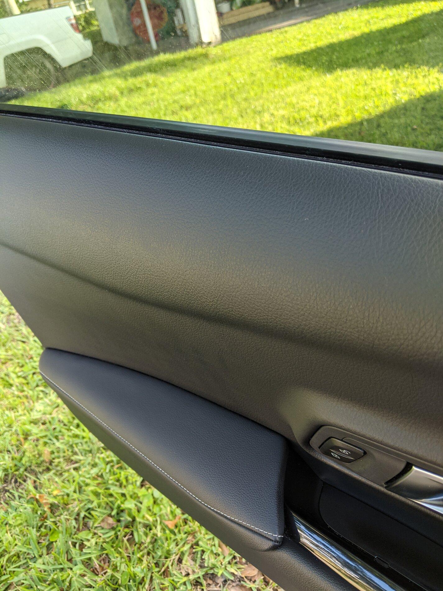

Hey guys,
I was detailing my interior today and as I was wiping down the driver side door panel with griot's interior detailer, I noticed there was a white peeling effect happening as I was wiping down. It looks like some coating on the door material has failed. It left shiny spots that are somewhat sticky. The passenger side is fine. I will attach photos below.
Background: bought the car in August 2019, 35% tints all around, 50% windshield tint. I've always used a windshield cover when parked outside at work. The car is not garage kept so it is exposed to the sun nearly everyday here in south Florida.
I will be taking it to the dealer for a warranty claim. I will have them wipe it for themselves and see the peeling. It ruins the matte premium look the car has when new (in the interior). Shiny spots here and there makes it look cheap. Have any of you experienced this on your Supras?

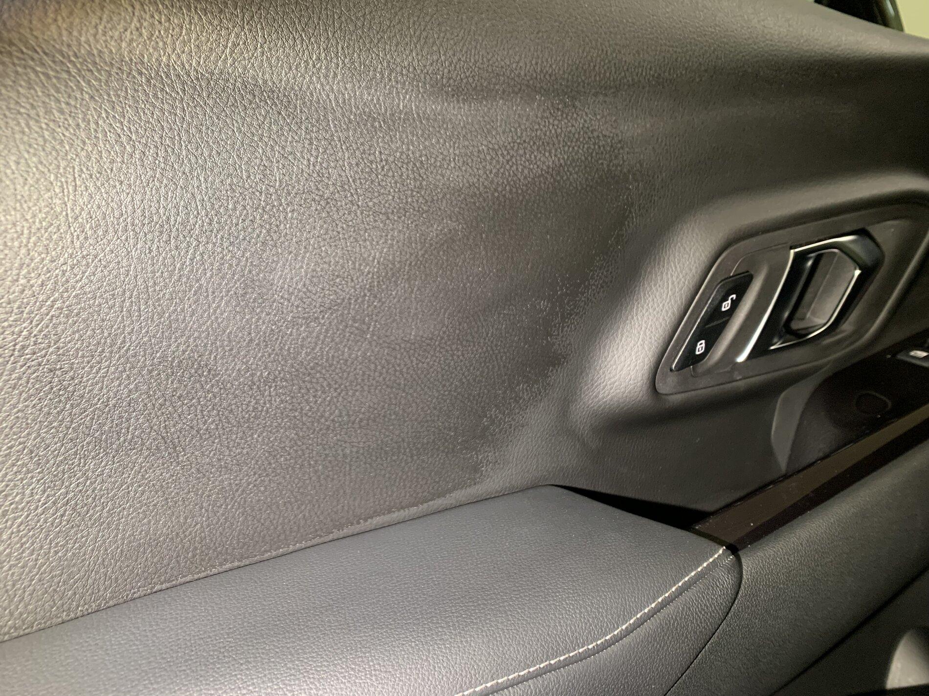

I have the same issue. Happened last night when I was wiping down the driver side door. I was like wtf is goin on? it kept flaking off like dandruff.

Yes but itā€™s only on driverā€™s side door panel. Just like what OPā€˜s issue. I donā€™t think thatā€™s a coincidence. Clearly this has something to do with quality or lack of it. My car was tinted 6 months ago and Iā€™ve clean the interior many times after that. So I highly doubt itā€™s the residue from tinting.

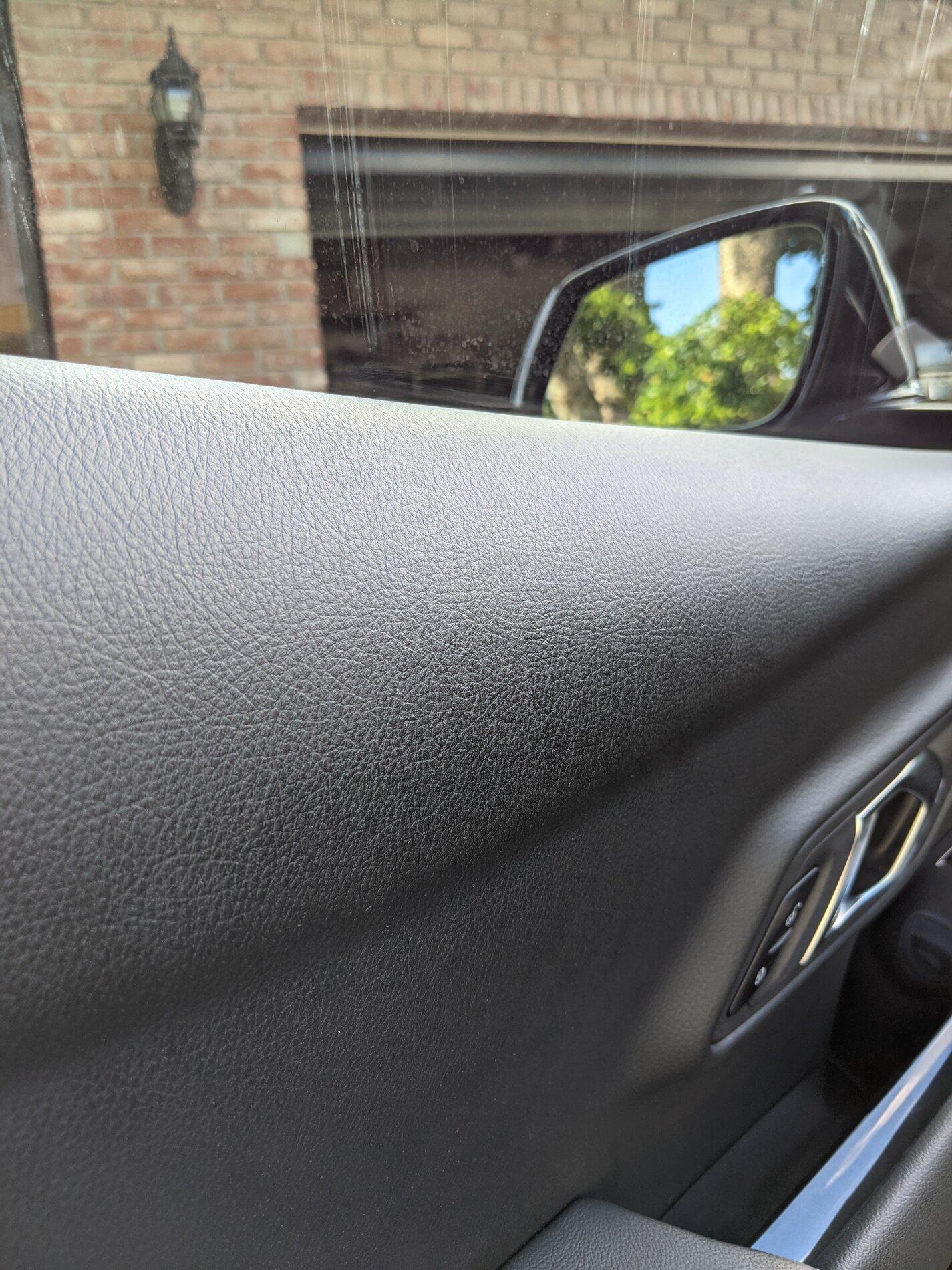

I had something similar happen but nothing peeled off, instead the rain made what looked like stains and drip marks.
Could be some kind of glaze put on, either by the dealer or from factory, to make it look clean and shiny but it isn't supposed to be durable or permenant solution.
I believe dealers usually detail the car before delivery and apply all sorts of waxes and glazes inside and out.

Thanks for the replies guys,
I will be talking to Larry from Ammo NYC tomorrow on the issue. He has not seen something like this in his detailing experience. Upon further research these past few days, I came across an old forum for C6 Corvettes that had a similar issue. Someone pointed out that it could be residue left from the vinyl gassing off. This could very well be the issue. I have tried rubbing the passenger door with a wet microfiber somewhat aggressively and it also started peeling.
I will keep you guys posted on what it turns out to be. My dealership is aware and have seen it, but I want to see if it is just the vinyl de-gassing leaving the matte finish.
