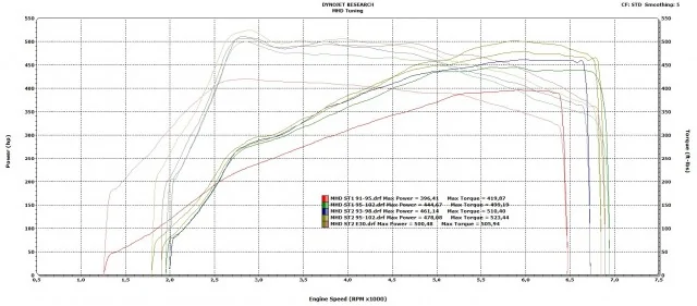

Today's public update brings Toyota Supra MK5 support!
-custom tunes flashing, and logging.
-original and updated software are supported: yes, the new software that prevented direct OBD flashing is already supported by MHD!
MHD OTS Map Power Figures:
__
Also, MHD WiFi adapters are now produced and are being shipped to retailers, so we added support for those adapters. 3-4 mins unlock flash, 20s map updates.

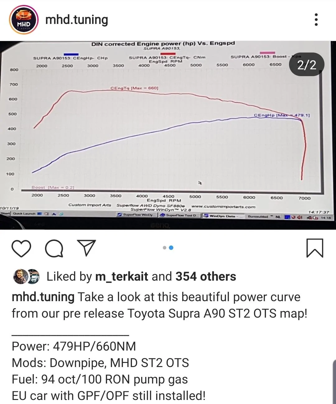

So I heard mutterings from Visconti the HPFP is strong enough to support E85, or nearly that high. Is that true? Also is there a chance of wear due to decreased lubrication?
Lastly, what's the highest horsepower you think you'll be able to get? I saw some tuners in Germany managed about 480whp and 550 ftlbs of torque on a totally stock car (I don't know if it was corrected, what kind of dyno, etc.), do you think that's possible?
Yes, the B58 in the Supra got the updated pump luckily. its a 5000psi pump whereas prior revisions were a lower flowing 3000psi pump that was not sufficient at running more than E40 on decent stock turbo boost. Full E85 is doable, we've run it in our shop car while it was stock turbo. Running the car hard (talking bone bone stock) its doable. weve made 500whp on stock turbo with enough octane.
Over the water they rate in BHP not WHP typically. But we can make some good power on stock turbo with the stock fuel system. We are testing the limits of it. Currently our shop car has PS2 upgrade. and were running E40 at 23psi right now. we will keep testing the limits.
Yes, E85 wears on the pump, we recommend running a tank of 93 through the system every couple of tanks of E85.
