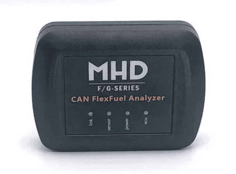

The actual MHD ethanol sensor conversion box (converts to a 0-5v signal for the DME) looks like this (I know you know this since you installed it, this is an FYI for others reading this):
this is not accurate. the MHD box receives voltage input from the ethanol sensor and converts that to a CAN message which is sent to the ECU
Bryan / Briana
4,704
9,413
Your moms bedsheets
box receives signal from the conti sensor, translates it from a 50-150Hz frequency to 0-5v and transmits it over CAN. Not sure what MHD uses for an address, but anyone using a zeitronix box, it's 0x00EC unless programmed to be different.

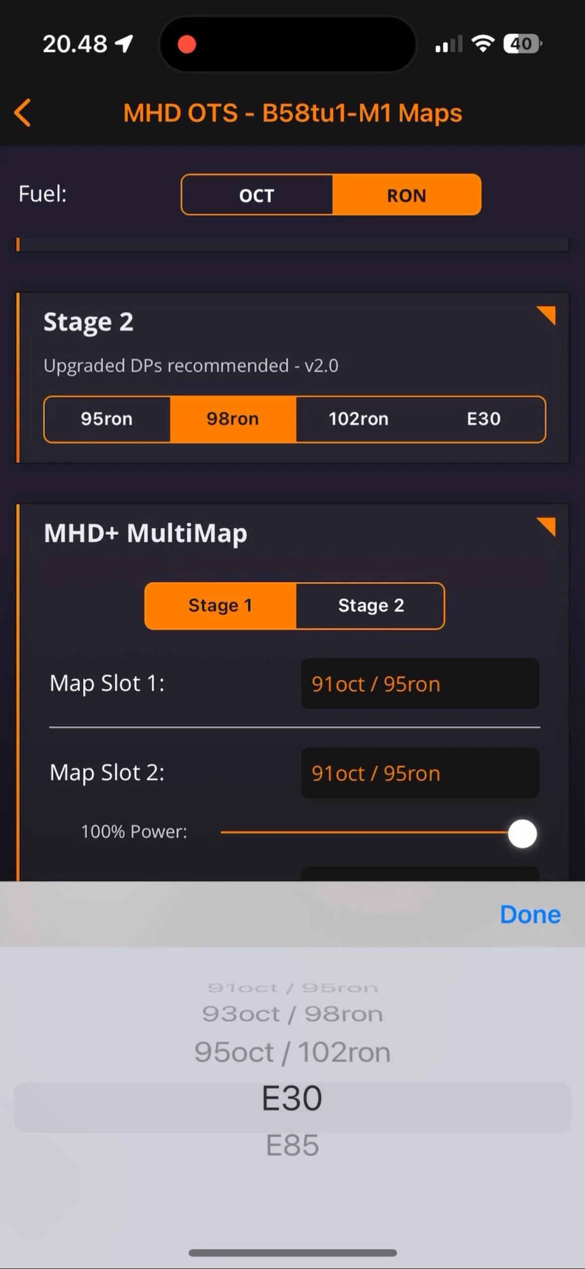

Is it just me who is wondering about the function "multi map", what options I see are not multi map, I see 1 map with power/fuel definitions.
What if I want to run 1 flame map, for a very short timeframe, and then go to stock map, to me that would be multimap...
Am I missing something here?
You can't switch between maps like that, for example between stage 1, stage 2, or stock.
Multimap is for a single stage but with different fueling or settings.
So basically it is "multi setting". Would be great if that was the original naming, I was quite dissapointed seeing that I could not have multiple maps, when it says multiple maps..
Thanks for confirming.
well technically they are multi map, because a 93 octane and an ethanol blend is not just a difference setting, it’s a whole different tune.
What you’re looking for wouldn’t actually make sense because if you have hardware for stage 2 (downpipe) then it would have no benefit of running the stock tune.
What you can actually do is adjust the power for each map. So you can have up to 4 map slots with all different power levels. If you want factory power for a map then you can set it to approximately that with the reduction feature.
I completely agree, but if I could do the switch I thought I could, then I would by a flame map, which of course should only be used in specific situations..
You can absolutely do that. You will need a custom tune and you can ask the tuner to create multiple maps for your tune. One with the flame settings and one without.
